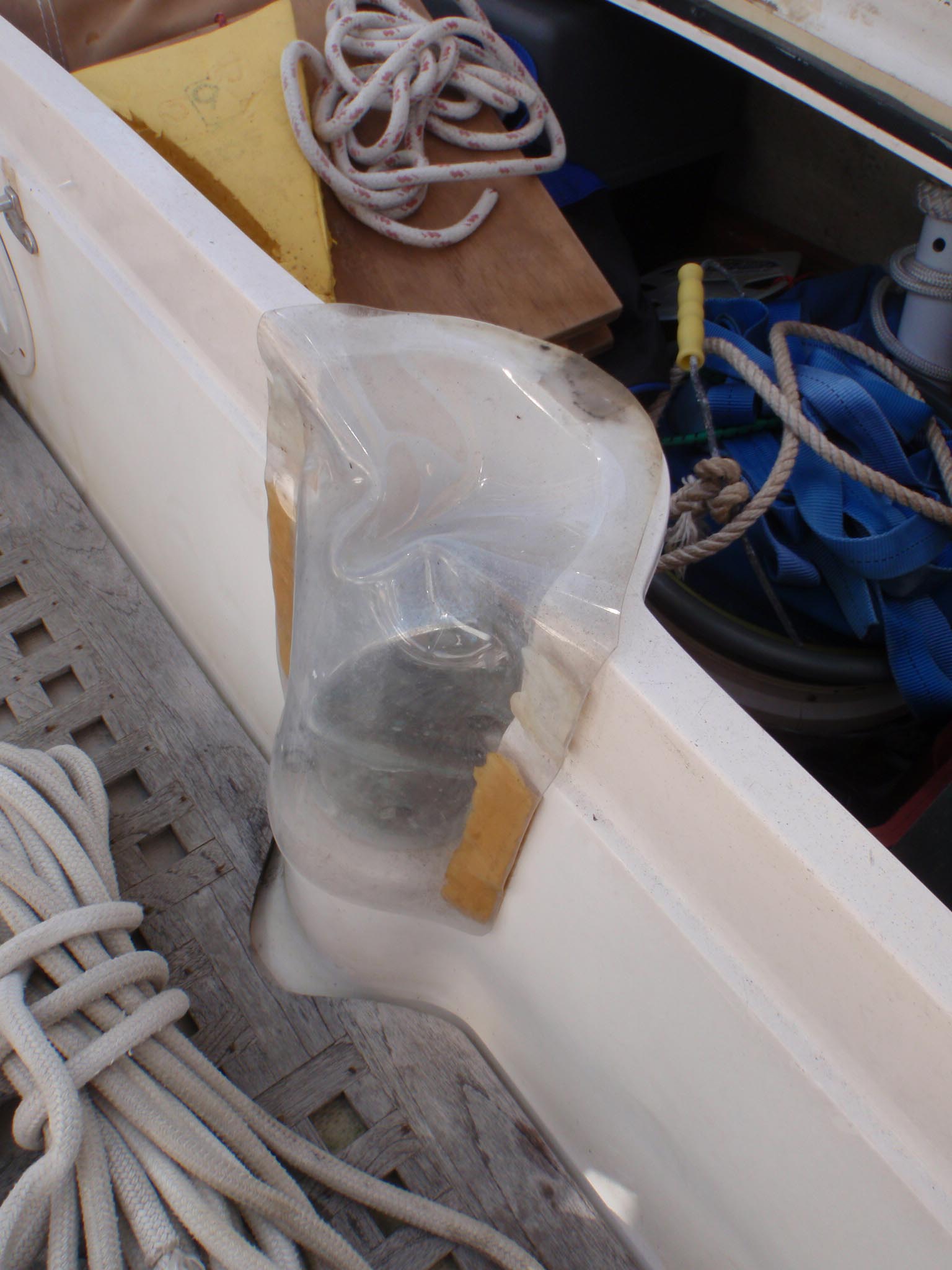

We traced over 25 separate leaks into the bilges :mad: and this sounds like one of them.
To stop water entry here we made a cover out of our old dodger windscreen material, cut to shape with glued on velcro. It tucks under the lazarette seat and folds down to entirely cover the rudder head fitting. The plastic was softened with a heat gun to make it fit the compound curves better.
Advantage is you can still see the direction of the rudder thru the plastic, you can unzip it to fit the emergency tiller and you have a smooth surface behind your calf when steering.

Like your idea of the clear cover mounted inside the hatch better than my plan of a chunk of Pacific Blue Sunbrella with snaps to catch the back of my legs. Have to admit that I do sometimes eyeball the position of the emergency rudder fitting to remind me where the helm is.

Hi Jack
I'll try to attach a photo I took last weekend. It's a bit weatherworn, but you get the idea...
