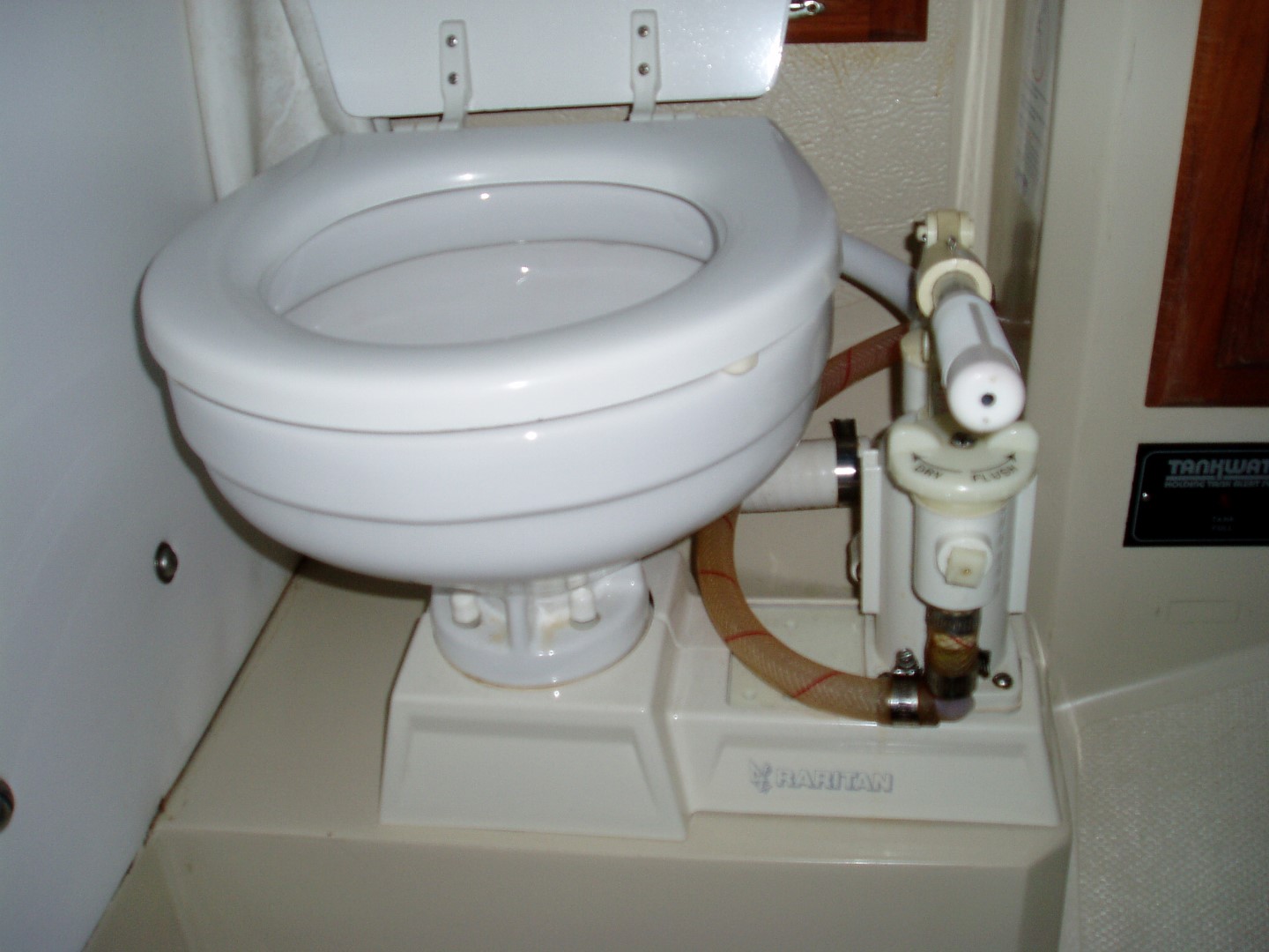

Chuck,
The install was fairly straightforward.  Took out the old, filled the holes with thickened epoxy, marked holes for new, drilled (into plywood under the fiberglass), installed using SS lag bolts with caulking in holes.  From memory, I think I went with the household size, and it fit nicely.  Only mod I did was to cut 2-3" off the handle, as I thought it stuck out too far.  Here's a pic installed on Julandra (MkI #659).

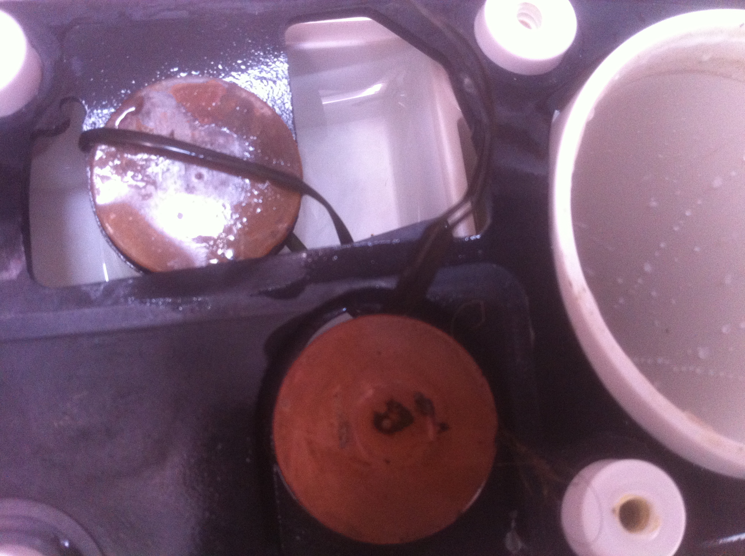

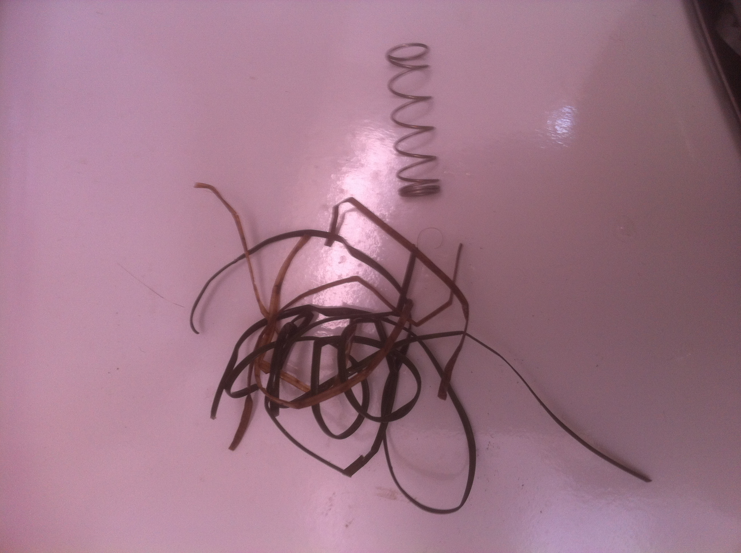

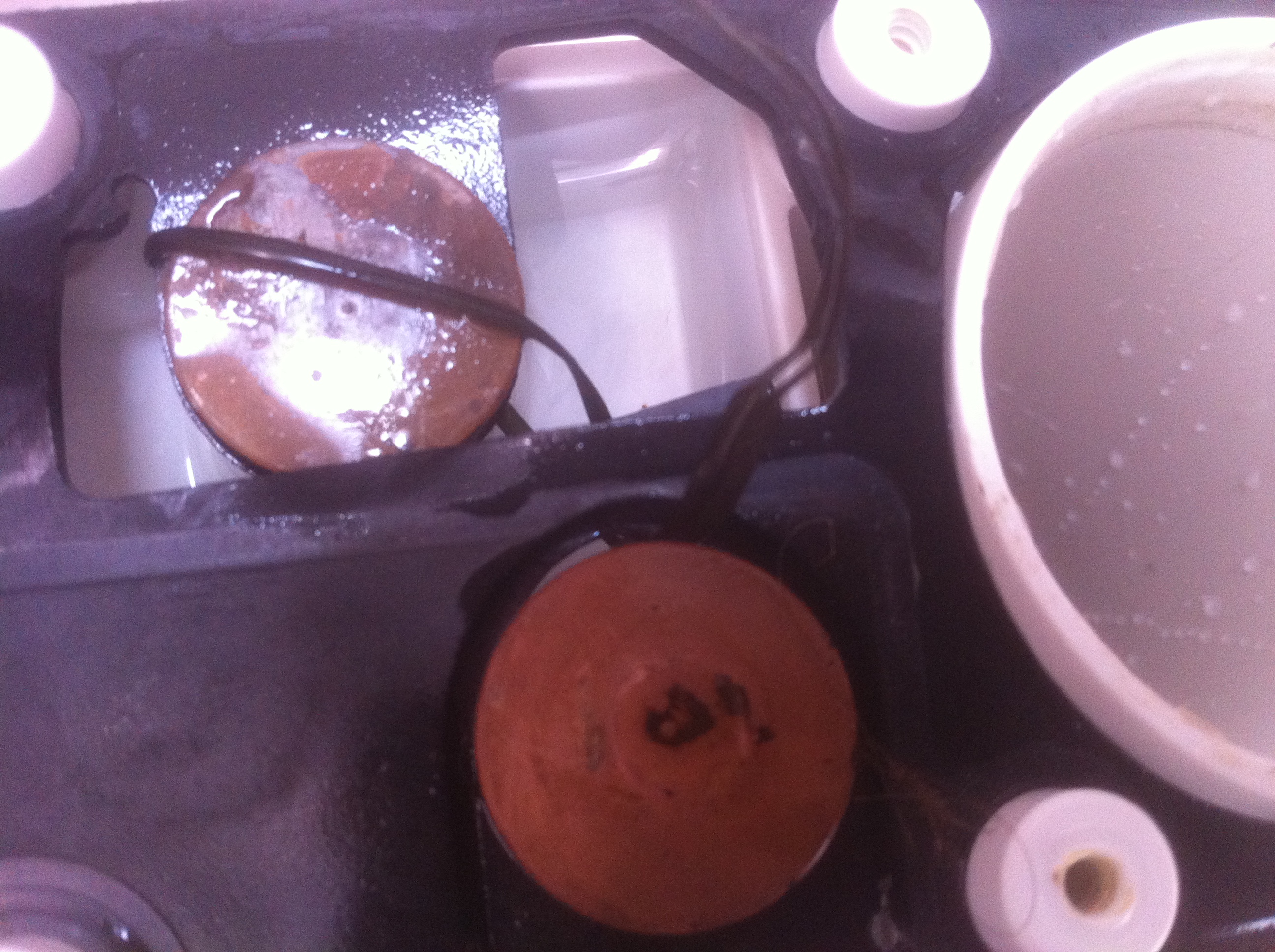

I took the toilet pump apart and found Sea grass stuck in the valves. I cleaned and lubed up the parts and all is well. I plan on installing a Jabsco pump inlet strainer.<br /> Locking the handle solved the water draining issue.
