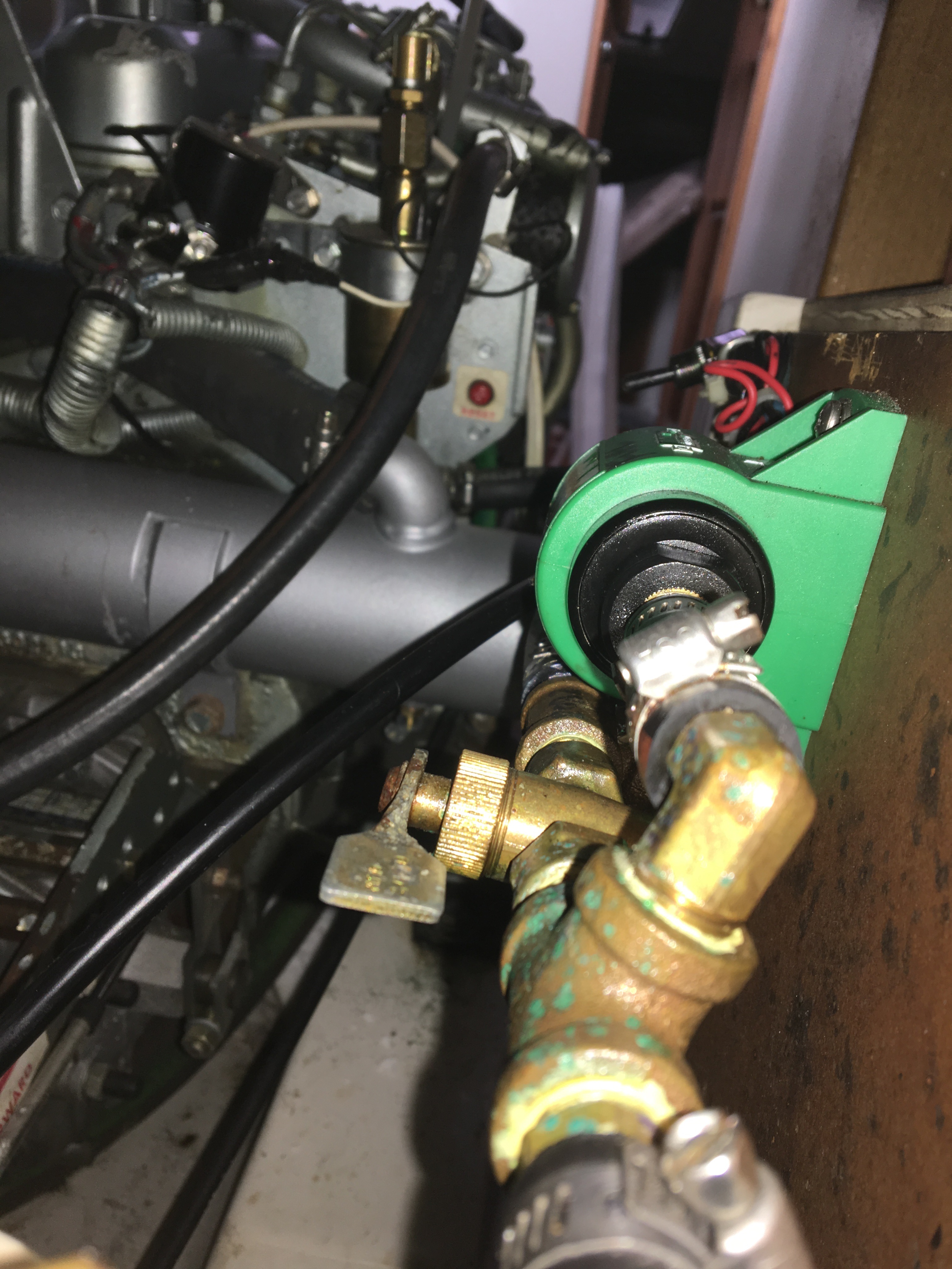

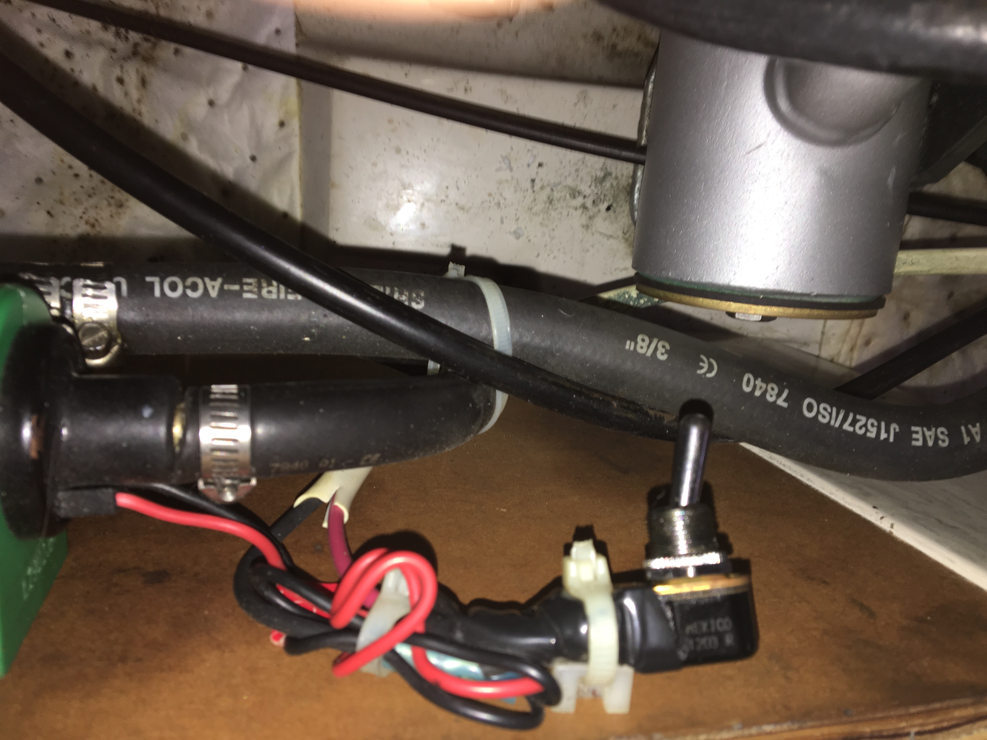

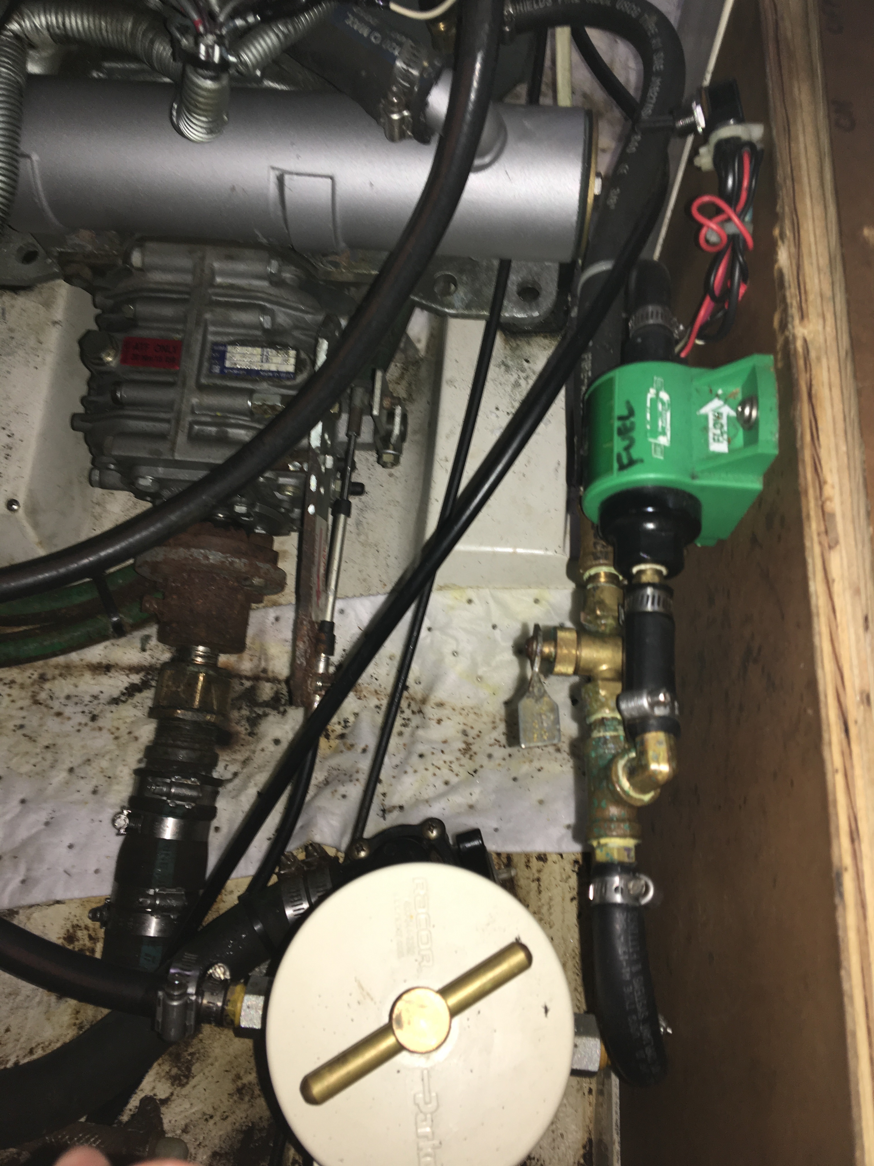

Could you show pictures of your auxiliary pump setup?

 The basic set up is valve that diverts fuel (prior to the pump on the engine) through the auxiliary electric pump which has an on/off switch that is accessible from both the front and the back of the engine. It is simple and inexpensive and a very nice thing to have. It allows bleeding by one person and is also a back up. It is something I added after a bad experience while singlehanding on a very rollie chaotic ocean. I will take some pics and post them.

Here are a couple of pics showing my auxiliary electric fuel pump
