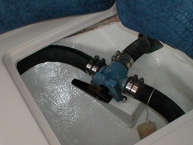

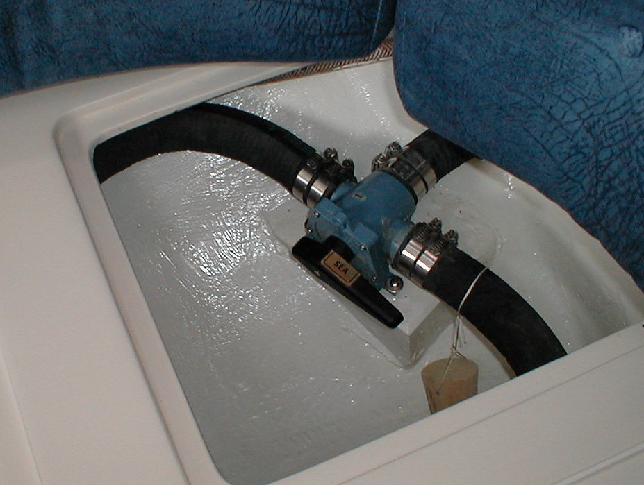

Greig, here are a couple photos of the Y-Valve on my Mk II. Your boat ought to be similar in arrangement in this underseat compartment, I would think. This is the forwardmost portside compartment in the salon.
Just remember, when you're in US waters not only do the Y-Valve thruhull and the macerator thruhull need to be closed, they also need to be "secured" via a suitable device. I use large plastic tie-wraps for this purpose (not seen on the photos below). I have a Canadian friend who was busted by the USCG for not having secured the thruhulls, even though they were closed.

Greig, there is no antisiphon in the sewage outflow hose, the large hose. That hose connects straight from the head to the Y-Valve.
I stongly recommend that, while you're doing surgery in the head system, you replace the black rubber hose with a higher quality white plastic hose. The black hose can/will develop microscopic 'weeps' that will be an incurable source of odor. My photos were taken before I learned this lesson the hard way, and the entire boat smells so much fresher now that I have changed the head output rubber hose to plastic hose.
