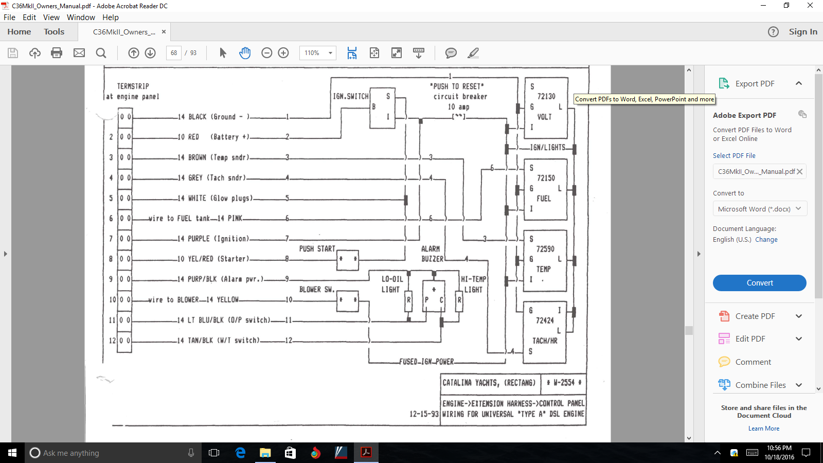

The red button is a circuit breaker.It's purpose is to protect the wiring between the battery and whatever is down stream from it.
I haven't looked at the schematics for this breaker but I'm sure that all your engine instruments are powered by this CB.  The start circuit power runs thru it too. Maybe the fuel pump and glow plugs.
There are wiring schematics on the site.
The reason the gages freeze, is because they lost power.
Also Catalina  direct has some good reading on how to test your engine instruments.
http://www.catalinadirect.com/index.cfm/category/493/instruments.cfm
If you don't already own one, your going to need a Volt/OHM meter. Doesn't really have to be a high dollar one. Just something to check for voltage and resistance.
Sounds to me like something is shorting straight to ground after the engine starts and runs for a while. Through the process of checking each circuit that is powered by that CB is the only way to solve your problem.
I think I would start by opening up the panel and look for any obvious problems. loose or burnt wires or connectors.
