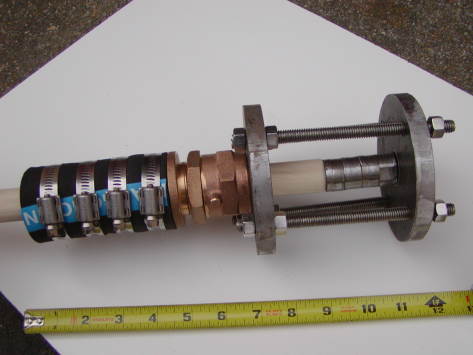

Posts: 452
I built this device using 1/2" steel to try and push the shaft out of the coupling. It did not work. I had to cut the shaft and pull out.
I did not know a device already existed. Has anyone been successful in removing one?
