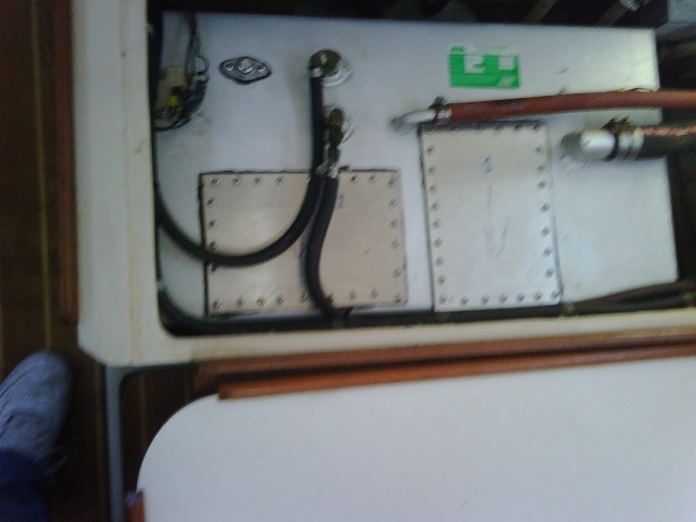

Unless you need to inspect the bottom of the tank exterior, you might think of cleaning the tank in place since it is so easy to get at. I recently had mine cleaned and the fellow drained it and thoroughly scrubbed it in place in a few hours. You'll need to cut inspection plates on either side of the baffle in order to get at the whole tank interior, just an FYI. If you'd like a pic of where he cut mine, just let me know.

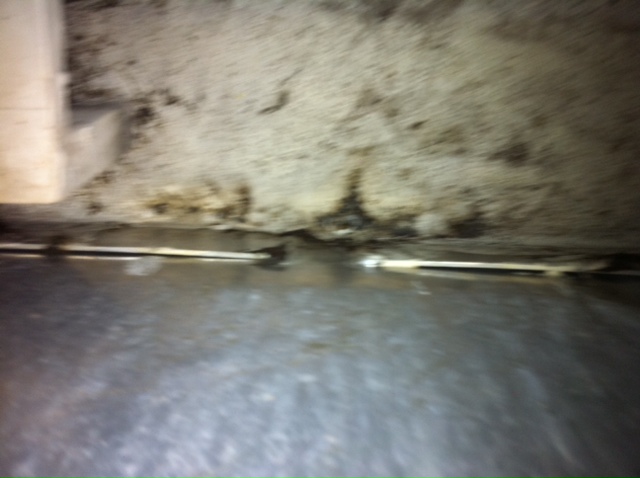

Mike, I think I'd like to remove it, if nothing else, so I can inspect it for exterior corrosion and such.
Randy, I don't see any screws. It appears to have been glued in place, at least on the one side (to port) that I can see. I can't see the other side (nearest the centerline of the keel) since there is no access hole through the port settee or under the cabin sole (which I removed) running just to the starboard side of the keel.
It's kinda fuzzy, but I've attached a picture of the port side of the fuel tank to show the glue point. This is looking down at the fuel tank. Note the base of the water heater on the left (aft) side of the picture.
Maybe I could just pry it up?

We removed our tank on 1983, hull 78 Catalina 36 this summer. And yes, our tank was glassed in place - glass over tabs. I had to cut the glass with a dremmel , and also had to bend the tabs down in order to remove the tank as the opening was too small to allow the tank to be pulled through.
Ben. I had some glass over the tabs but screws under that. Each may be different. No bending of tabs either. I developed a leak in the bottom while in the Bahamas. I had to patch it with glass. It will come back out in a month so I can add a few layers of glass to the whole bottom as it was setting on a piece of plywood and it developed a few pin holes. Mike if it is a 33 gallon could you post the lenght and width. I need to cut me a piece of new plywood as I would like a general size as I am 1200 miles from our boat.

dejavu's picture
dejavu
Joined: 11/6/08
Posts: 433
Hi Laura, here you go. Mine is a '91 and it is a 33 gallon tank. The two large inspection plates really allowed room to get the interior absolutely spotless prior to refueling. FWIW, the small cap at the top left side of the photo comes off to allow for checking fuel level with a dipstick. The guy I used has been cleaning tanks in Marina del Rey since 1976 and he suggested it and I like it as a backup to the fuel sender or some expensive contraption.
[ATTACH]646[/ATTACH]

I replaced mine a few years ago not easy on the port side I is glassed to the bottom with the hot water tank shelf on top of the tabs
First had to slide hot water heater over some fittings broke from being so old
Then cut a good size piece of the the heaters shelf out to free the takns mounting tab
Then cut the tab from the bottom of the boat. You will have to pull the tank at an angle to get it out
