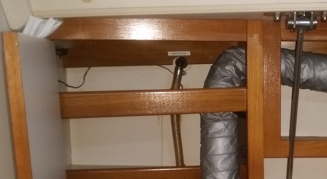

There is no filter or mesh in the standard Catalina stanchion vent.  That said, the hole or slit in the stanchion is very small, and unnaturally attractive to spiders, so you may have 'all natural, organic' mesh in there now!  I suggest using a garden hose each time during your pump out cycle.  Many of us have replaced the hated stanchion vent with a standard mushroom vent drilled through the hull below the rub rail, just below the stanchion.  The hose size is 5/8", I believe, and after changing to a mushroom fitting is not too small.  Many photos on this site, and other sailing sites like Sailboat Owners. Here's the inside of mine.
