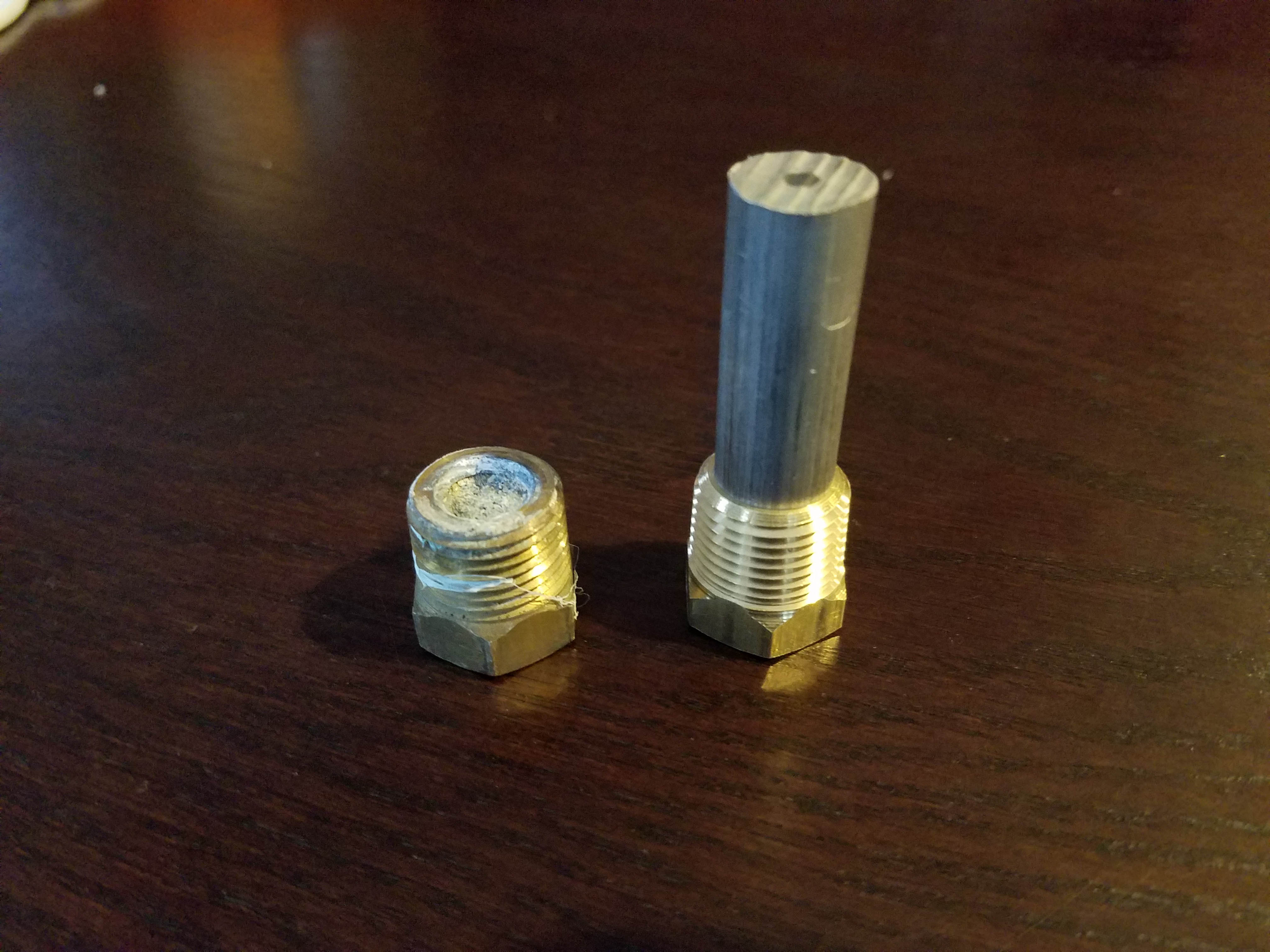

I ordered a new magnesium anode for the heat exchanger to go with the new one for the prop shaft.  When I removed the old one, there was no anode material left at all.  Then I noticed that the heat exchanger tube had a large bulge at each end, like a chipmunk with a mouthful of nuts.  So it's either bulging from internal corrosion (doubtful), or was not winterized at some point in the past and froze?  Regardless, looks like I'm buying a new heat exchanger!  They seem to range from $800+ for OEM down to $350 for aftermarket.  Any tips or advice?
Thanks!

When we moved our first boat from California to Connecticut, we had no concept of "seasonal" and ended up with the bulges that you mentined due to freezing.  The heat exchanger worked fine for another decade.  If you don't want to replace, you could take to a radiator shop for cleaning and testing.
BTW, if you suspect a heat echanger is leaking, closely monitor your coolant levels.  An unexplaind and slow loss of cooland may signal the beginning of the end to your heat exchanger.

Yup.  With a leaky car radiator, since the exchange medium is air, you'll find the loss of coolant on the ground (if you're lucky).  With a leaky marine heat exchanger, since the exchange medium is sea water, that coolant goes out the exhaust.  Investigate all other possibilities though, especially if you've serviced your cooling system lately and it might just be air being completely burped out.  This can sometimes take quite a while.

I had read somewhere on the site here, to insulate the HE from the engine brackets. Your little pencil anode is for the salt water system
 in the HE only, to protect it in its own little ecosystem. Be sure the anode makes good connection with the HE threads.
  I might replace the anode 2x a year with never a great deal of loss.

LE 302631 which was an exact fit for my old one. Cost was $350.00 and shipping was another $25.00 and arrived within four days. LenCO is in North Amityville, LI, New York tel; 631 842 4049. HINT: Be very careful to measure the correct length of the zinc used in the exchanger as too long a zinc will pierce the heat exchanger tubes. If you are just going to use the heat exchanger you have now and want to know the correct size needed, use a pencil and measure how far it will go in to the heat exchanger and adjust you length accordingly. As you have probably found out, the zinc unscrews from it's cap. We are able to get our zincs at the local hardware store can cut them down to size. I change mine every six months but that's overkill.
And yes, the heat exchanger should be grounded to the engine.

Thanks for the info Bill.  I will definitely check the Lenco out.  As for the zincs, I am opting to use magnesium since I am in fresh water in the great lakes and that is what is typically recommended.  Magnesium ones are more difficult to find, and I'm guessing the hardware store wouldn't have them.  But it's worth checking!  Thanks again!
