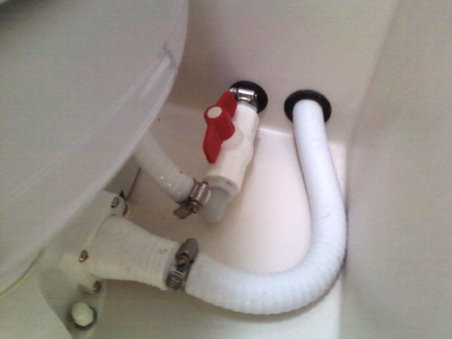

[FONT="Arial"][SIZE="4"]Every time I get my C375 on nice beam reach and a strong port side heel seawater is forced into the head bowl and overflows. So far no big mess but why tempt fate. You can just turn off the though hull fitting valve in the forward cabin but that is rather awkward for your guests when they need to use the head. My questions to the manufacturer got these answers:[/SIZE][/FONT]
RE: SeaEra Toilets Catalina 375
Thank you for your e-mail message from earlier today. It would appear that you are getting the "ram water effect" when the boat is moving and on a
port heel, where the water is being forced in through the seacock, loop,toilet pump and finally into the toilet bowl, overflowing it. Were the heads factory installed? Are the boats still under warranty? It may fall under something that the dealer can correct.
Otherwise, the simplest cure I can suggest is to put a clamshell deflector over the outside of the supply water through-hull fitting, with the opening facing aft. That will still enable you to use the head while underway, but will deflect the force, pushing the water into the boat.
Another solution would be to add a normally-closed electric solenoid valve (Raritan part # CWPS12B or equivalent) in the supply water line. It would be wired parallel to the intake pump wiring, so that the valve would be open only when the intake pump was running, and closed the rest of the time.
However, solenoid valves are quite susceptible to dirt, bits and pieces of vegetation, etc., that are drawn in with the incoming water - so if you should choose to use that method, a fine-mesh strainer in the water line (Raritan part # 190601 or equivalent), just before the solenoid valve would be recommended, to protect the insides of the solenoid valve from becoming fouled with "garbage." Combined cost for a solenoid valve and strainer would be $179.25, plus shipping, if you were to purchase them from Raritan.
[SIZE="4"]My solution was a trip to Home Depot and $20 for a simple shut off valve beside the head. See attached picture.
Rod Tennyson C375 Lila Jean Hull # 16[/SIZE][ATTACH]482[/ATTACH]

We had the same issue, and installed a value inside the cupboard behind the head. Having one down on the floor seemed like one more area to clean around, and meant you had to lean over the toilet to open/close the value.
I will get a picture when I get down to the boat again.

Rod, the photo tells the tale! An elegant solution, much better than - on my boat - reaching the thru-hull. I'll keep that one in mind. Thanks!
Thanks for sharing that, Rod. Very nice.

I think there may be a difference between the plumbing on the 36 & the 375. The inlet for the C375, is on the port side, just below the water line. So when healing on the port side, the motion of moving through the waves, pushes water up the inlet pipe. Being an electrical toilet may also make a difference.
The outlet for the shower and head sink, is on the centreline of the boat, just in front of the keel.

As an update to my original posting on my C375 (Lila Jean) and the head bowl filling with water, my Admiral also got tired of the head smells and so I went to a fresh water flush sytem. Now the "ram jet" problem of filling the head bowl with sea water under sail is moot. I also added a 40 gal flexible bladder fresh water tank in the v berth cavity in the bow. The installation was simple. No more smells, no more overflowing bowls. Of course one could just use the shower head to flush but the Admiral prefers a more dignified method.
Rod Tennyson
