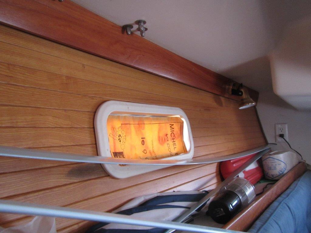

I've been tracking down vibration in the boat at low throttle. As part of the exercise I have installed new engine mounts and a silicone hump hose.  Both helped (engine is now very smooth), but there remains a banging noise that seems to come from behind the wooden liner in the aft cabin on the starboard side.  I'm guessing it's a sympathetic vibration and am wondering if the filler hose on that side is not secured.  Has anyone removed this liner and what's the procedure?

Hi Paul, thanks for your reply.  I think you may be thinking about the panel on the port isde of the boat behind which is the fuel tank.  I agree with you that it would be reasonably straightforward job.  In my case I'm hearing the vibration noise coming from behind the wooden paneling on the starboard side of the aft cabin (see the photo).  I could just try to pull things apart but thought I'd check first to see if some adventurous soul had already blazed that trial and found any tricks or things to watch out for.

Aha....I wrongly assumed you meant the port pannel. Sorry- I've never pulled the wood pannel trim out from the starboard side. I assume it is attached to the hull liner rather than the hull itself? Very odd that you have a vibration sound from that area. Have you removed the drawers from the adjacent locker to get a look in that area? I would think any hull liner would be bonded to the hull in that area, and there would be insufficient room to snake any large wires or other things that might rattle behind the wood pannel. Is the wood itself solidly mounted- does it flex when pushed on? Maybe that is the cause?

Hi Paul, thanks for your suggestions.  Yes it is odd to have a sound coming from that area but I used the old solid stethescope trick with a stick to place between the surface and the bone near my ear (like you might do on a cylinder head).  Maybe the wood itself is loose, although it seems to be sturdy.  In any event I will try to track it down as it makes quite the racket under 1000 RPM.  I will see how the panel comes apart later this year and will post back with what I find in case it helps anyone else.  Cheers.

I removed that liner for refinishing many years ago when I first bought the boat. If I remember you have to remove the wood trim pieces on the sides and maybe the top. They are held in by screws. I believe the white shelf material on the bottom must also be removed - screws also. The shelf and trim help to keep the wood (ash I think) liner in place. You can simply pull the frame from porthole. It is held on by a Velcro type fastening. It's all easy enough to do. However, I don't know what is behind there that would cause the vibration you are looking for. Good luck.

I was on our boat recently. I pulled the drawers out of the aft cabin cabinet and took a quick look in the area you are hearing a noise from. The cabin liner and hull do have a couple inches of seperation- so something might be banging around- if someone dropped a tool or something between the liner and hull. There were no visible cables or plumbing- but again one would need a mirror and flashlight to see between the liner and hull.

when we first bought ours, (2000), we pulled some wires from forward to the port, aft lazzerette. Being much younger, I squeezed down into the space and found pvc pipes that held wires. My memory is a bit fuzzy, but I believe they run just under the shelf in the aft cabin. I also installed a remote VHF outlet back by the helm, just aft of the “winch handle” nook in the cockpit. I also had to get into the locker to do this. You can see right up to that box from the lazzerette. The water tank fill hose should be visible from this perspective.
Also, and this is a bit fuzzy, I’m pretty sure we had to remove the complete drawer unit from the aft cabin in order to run the wires. The drawer unit is essentially a plywood box that precludes getting a good look aft. It’s simple to take it out, just held in with screws around the frame. With this out, you just may be able to see back to where you want.

Many thanks for the additional information. With your comment about removing the aft drawer set in its entirety, and all of the assistance from others above, I think I know how I can approach the deconstruction from any angle.  The 'box of drawers' in the aft cabin sounds similar in concept to the one on the aft side of the galley sink which, BTW,  looks like it will have to come out to change the water heater - another project I have planned but not part of this thread.
