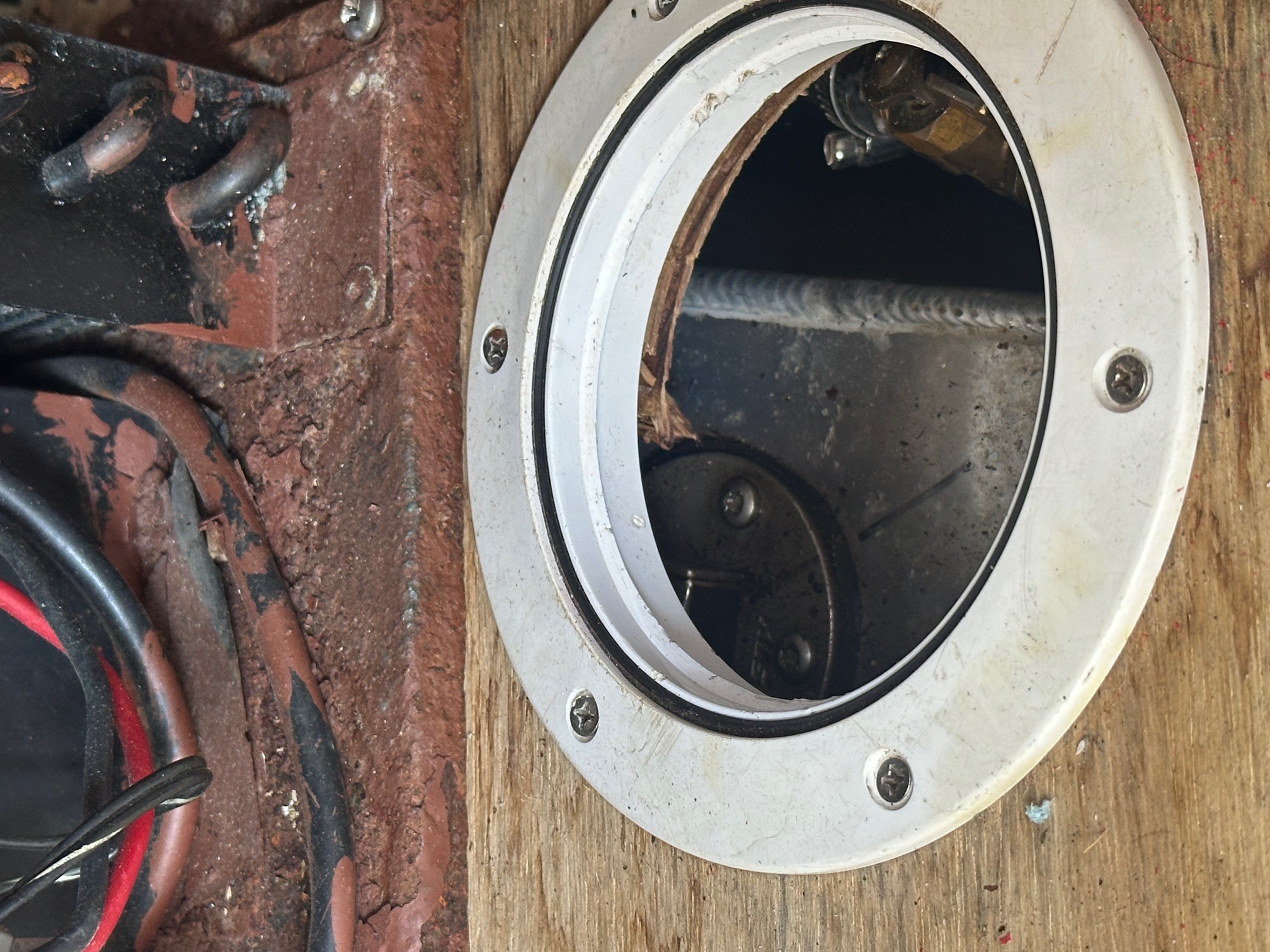

unfortunately the fuel polishing guy couldn't get

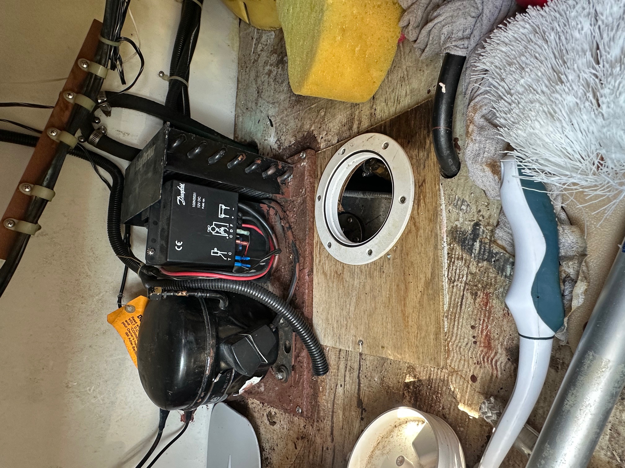

it done because the access hole in the lazarette doesn't line up with the access cap on the tank itself. I'm including some pics. I know that the previous owner had a new tank installed at some point in the last few years so that must be why it's not lining up. The refrigeration compressor seems to be in the way.
Does anyone have any experience with this? What should I do? Thank you

That picture is of the floor of the port side lazerette in the cockpit. The fuel tank is underneath. You can see the top of it through that access hole, but the two holes don't line up.
I can access the fuel tank through the aft cockpit. There are some screws that remove a panel. I wonder if I can take that panel off, and push the entire fuel tank a few inches towards the centerline just enough so the the holes line up, for the purpose of polishing the tank. Then move it back

It looks like the PO cut a bigger square hole and then put a piece of wood to cover it and I am guessing, a round port added and arranged so you can reach the fuel cutoff. Unscrew the fasteners holding on the wood piece and you may be able to reach the fuel gauge to remove it and access the tank.

Access to the fuel tank itself is easy. However to move or slide it out can be difficult. You'll need a long shaft screen driver to reach the brackets on the corners. It will also depend on how much fuel is in the tank.
A better option is to remove the fuel line from the racor and attach the polishing pump to it.
