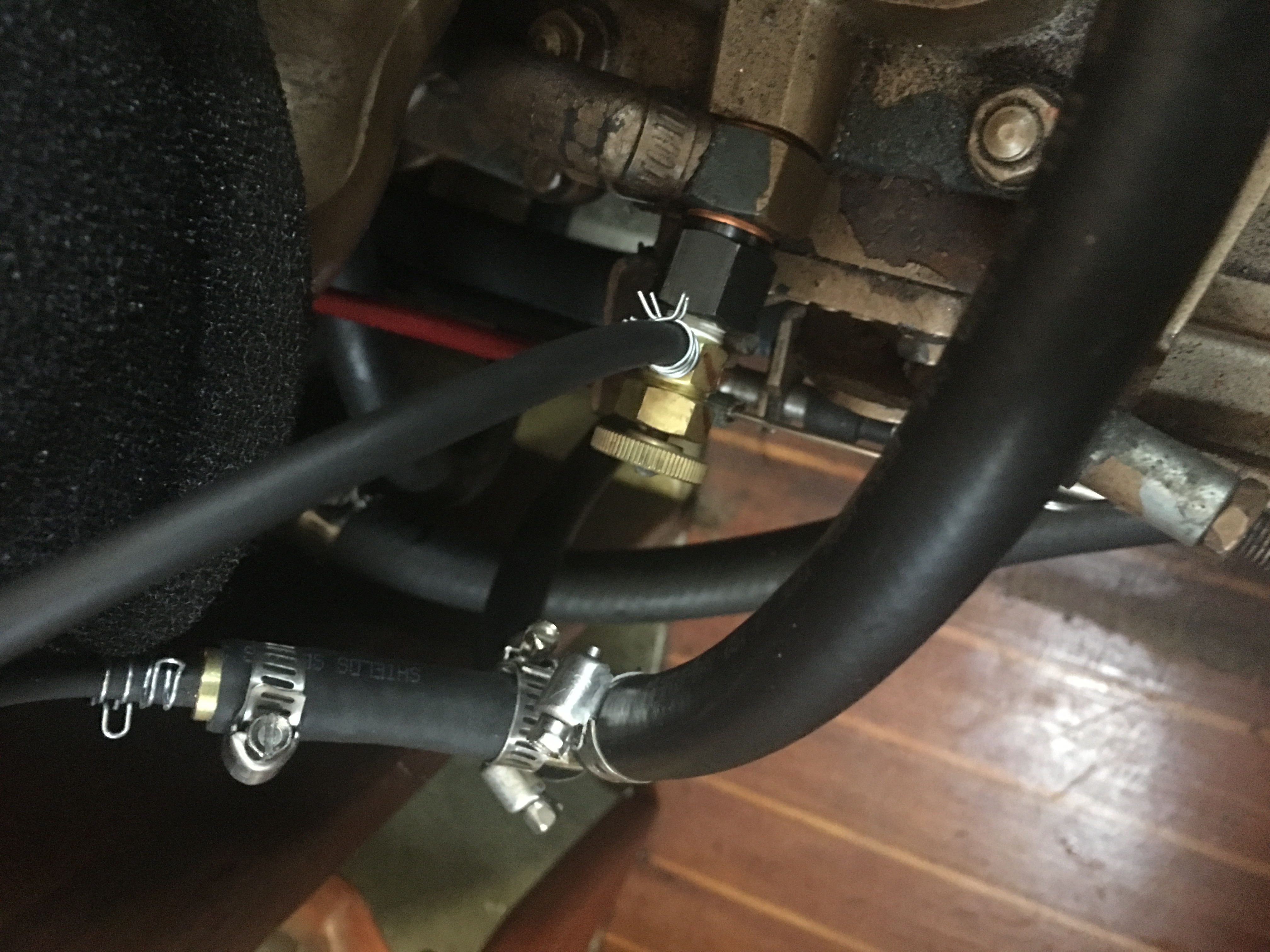

Is your knurled knob bleed valve open??  Mine is a retrofit. They introduced the bleed valve sometime after 83.  Starboard side of engine

Les:  Thanks for the post.  I didn't think of that and I'm not at the boat right now so I'll check when we get back later this month.  I did change the filters this spring but I have only opened that valve once a long time ago. My system seems to bleed itself very well. I'm buying a spare pump just in case since we have a trip planned and I don't want that to get in the way. I'll let you know what I find.
