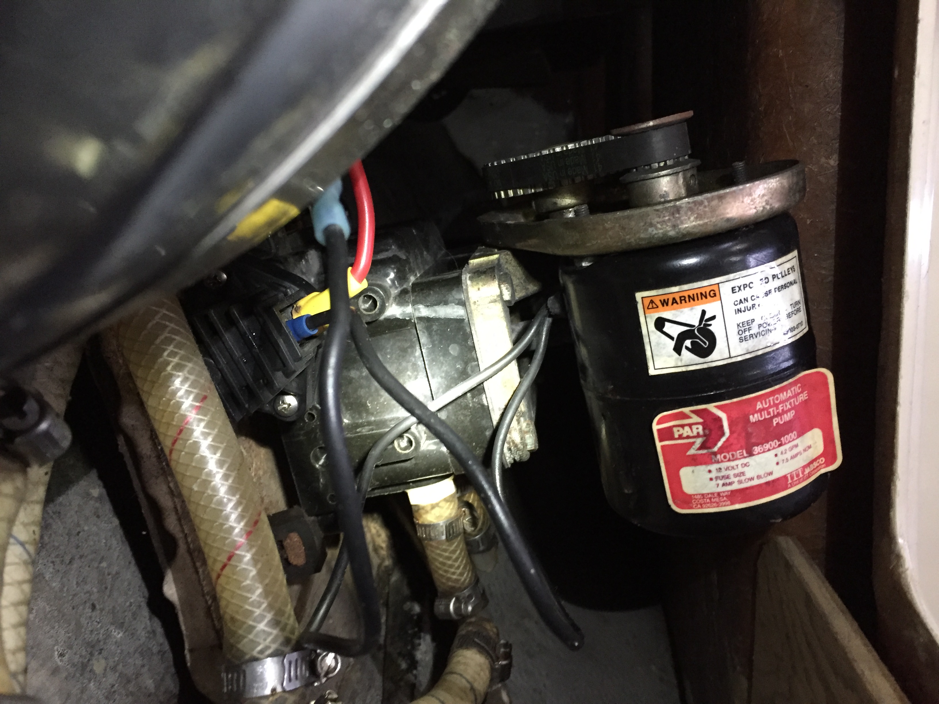

It appears the fresh water pump gave up the ghost last night. I'm wondering if this pump is the OEM or an upgrade by a PO. The existing water system has a Jabsco 36900-1000 4.2 GPM pump (see the manual here: ​http://www.pumpagents.com/pdf/JabscoPumps/36900-1000.pdf). Online this thing sells for about $600!!! I've uploaded a photo for reference.

So, can I pull out this old belt-driven pump and the accumulator tank and replace with some model of Shurflo pump? I see on the Catalina Direct site a reference to a model that is 3 GPM. Are there other recommended models?

The Jabsco belt-driven pump in your boat is not OEM.  It is an on/off pump, hence the need for an accumulator tank.  Newer design pumps are variable speed, and do not need the accumulator tank.  I can second the recommendation for a Shurflo pump.  I've had one for the past 6 years and it has been flawless. If you slightly open a faucet, the pump works slowly and quietly, with a steady flow.  Open the faucet all the way, and the pump works faster, pumping a higher volume, also with a steady flow.  My guess is that you want one with a 3-4 GPM flow rate, and you can do away with the accumulator tank.  Hope this helps.

Thanks for that. I did buy a Shurflo (4 gpm), and it is working great. A bit of an adventure getting it mounted on the existing platform (tight quarters to drive the new screws in). Patience was a virtue.
