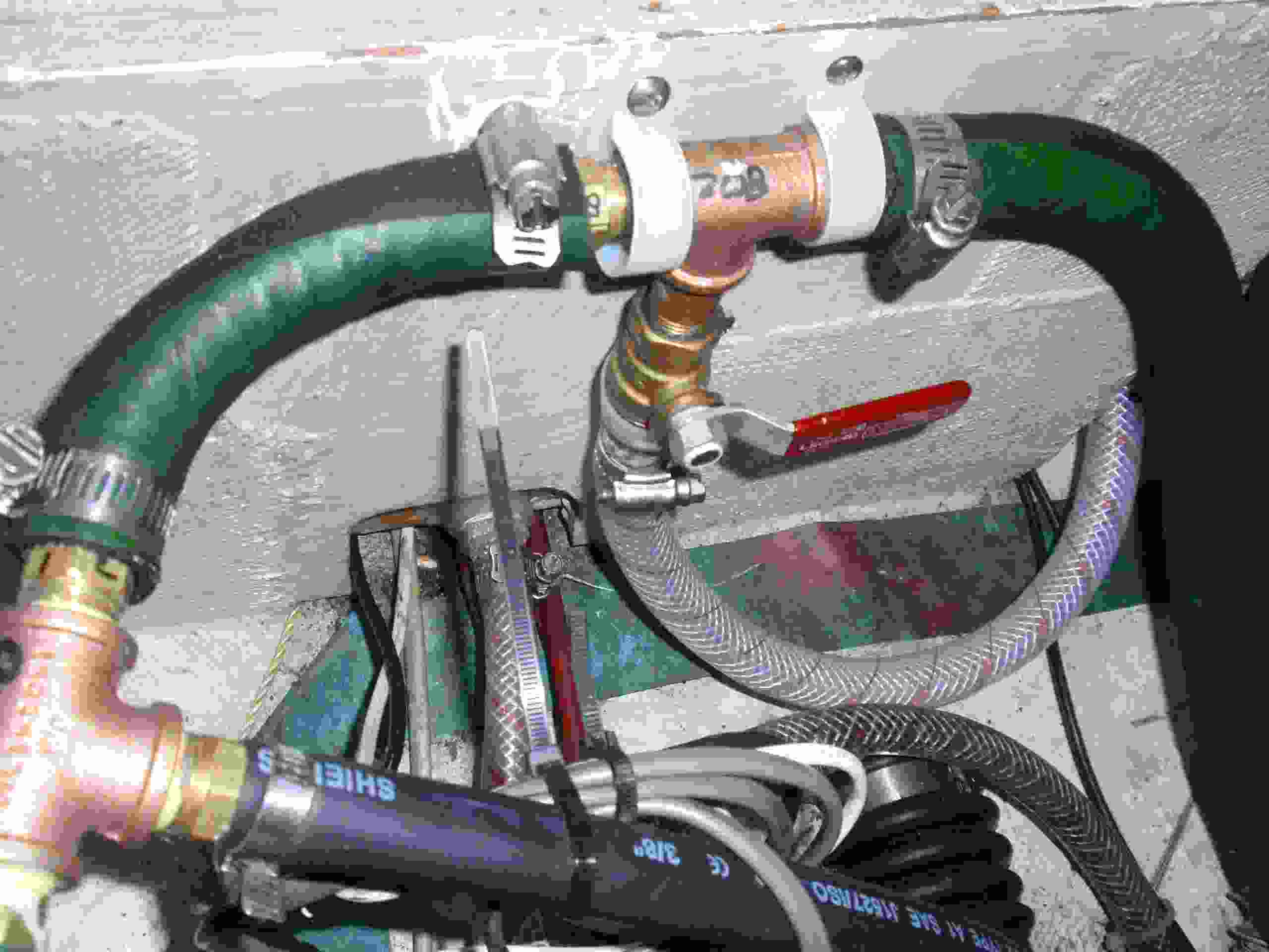

If I can figure out how to add photos, here are a couple I took this weekend.

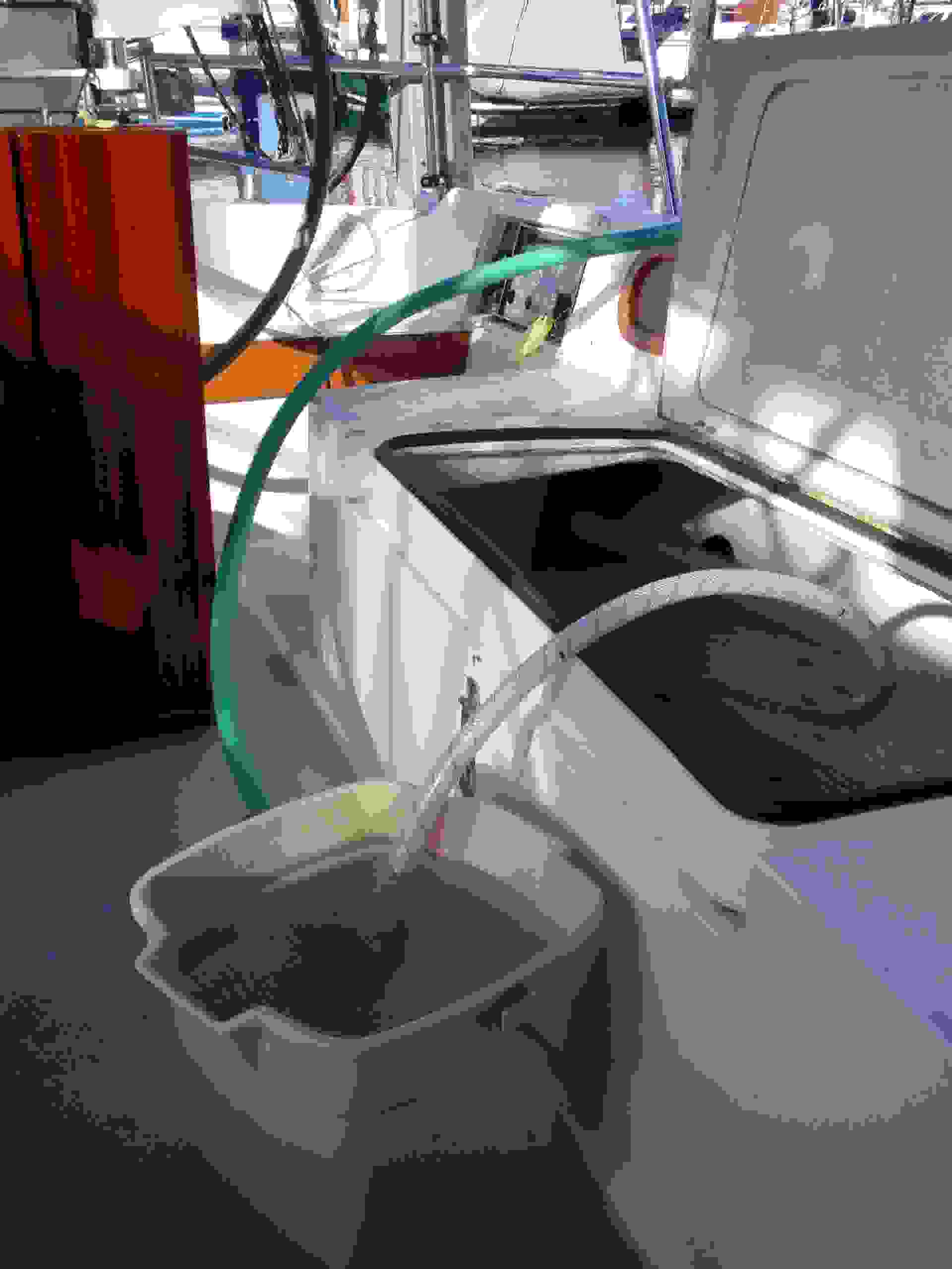

The left side of the "T" goes to the raw water intake. The right side to the heat exchanger. The bottom of the "T" snakes around to the port lazerette. I put the free end of the hose in a bucket of water and keep filling the bucket while the engine is flushing. Close the raw water, open the fresh water and flush for a few minutes.

Just some words of caution. Please do not connect pressurized water (garden hose) to the RW intake. You run a HUGE risk of hydrolocking your engine.
For most this goes without saying but the in/out bucket, as shown in the photo above, is the proper and safe procedure.
One other caution is that raw water pumps are NOT always a positive stop of water flow hence the need for siphon breaks. If your in/out bucket is higher than the top of the siphon break the simple act of shutting down the motor with the hose still in the bucket could still fill your engine with water via a siphon.
Watched this happen two years ago when the bucket was placed on the cockpit seat and the motor shut off. It is good practice to pull the hose out of the bucket just as you pull the stop lever.
