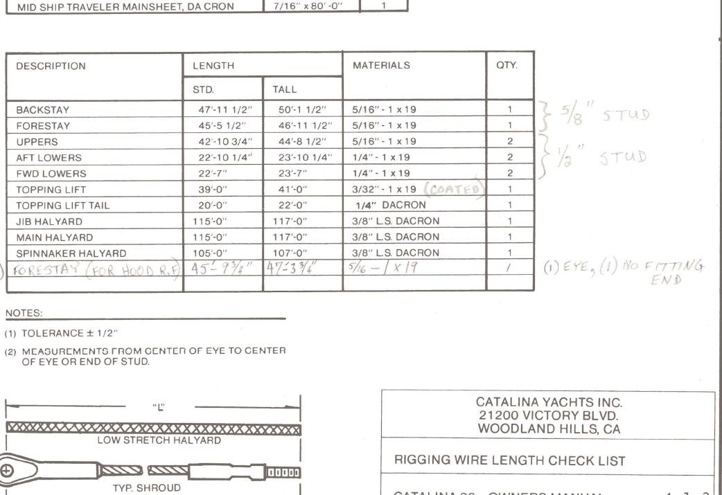

I’ve replaced standing rigging on 2 boats and the forestay is the hardest part.
Our last boat was an early Catalina 28 and it had some hand written updates in the manual similar to whats shown (investigation determine this was probably done by Catalina).
It’s important to understand that each roller furler manufacturer has a different method of attaching the forestay to the furler drum. So, Harken, Hood, Schaefer, and Aldo all require a different forestay length.
I suspect that your boat originally came from Catalina with a Hood furler (based on the modified notes in your manual), So the length shown in your manual would be correct for that furler.
It is possible that the prior owner replaced the wire in-kind without compensating for the different furler. This is a WAG on my part based on the information provided.
When I compare the PDF Hood Furler manual in the technical section with information from the Aldo website there is some indication that your forestay may be 4 1/4” too long.
If this is the case you can shorten your existing forestay using a mechanical fitting like a HiMod or Sta-Loc. According to Aldos website their furler can be installed without going aloft. Indicating the whole deal can be done at the deck.
As a path foreword I would call Warren Pandy at Catalina in Florida and ask his advice. Since the Adlo furler is designed to install over the existing headstay finding the standard pin to pin measurement on forestay (without any furler) would be helpful.
Again this is a wild guess on my part.

Thanks for the reply.
We took the forestay off today and measured it. Turns out it is 45' 9 3/4" which is exactly the suggested length for the Hood furler and 4 1/4" too long without it. It seems reasonable to assume that the original setup was with the Hood furler and when they swapped it out they just reused the same forestay even though it was too long. We were told the standing rigging had been replaced but maybe they didn't do it all.
The Alado furler sits very high on our stay so taking 4 inches off will only make things work better. Hoping that fixing the tension issue will also help roll the sail up better.
