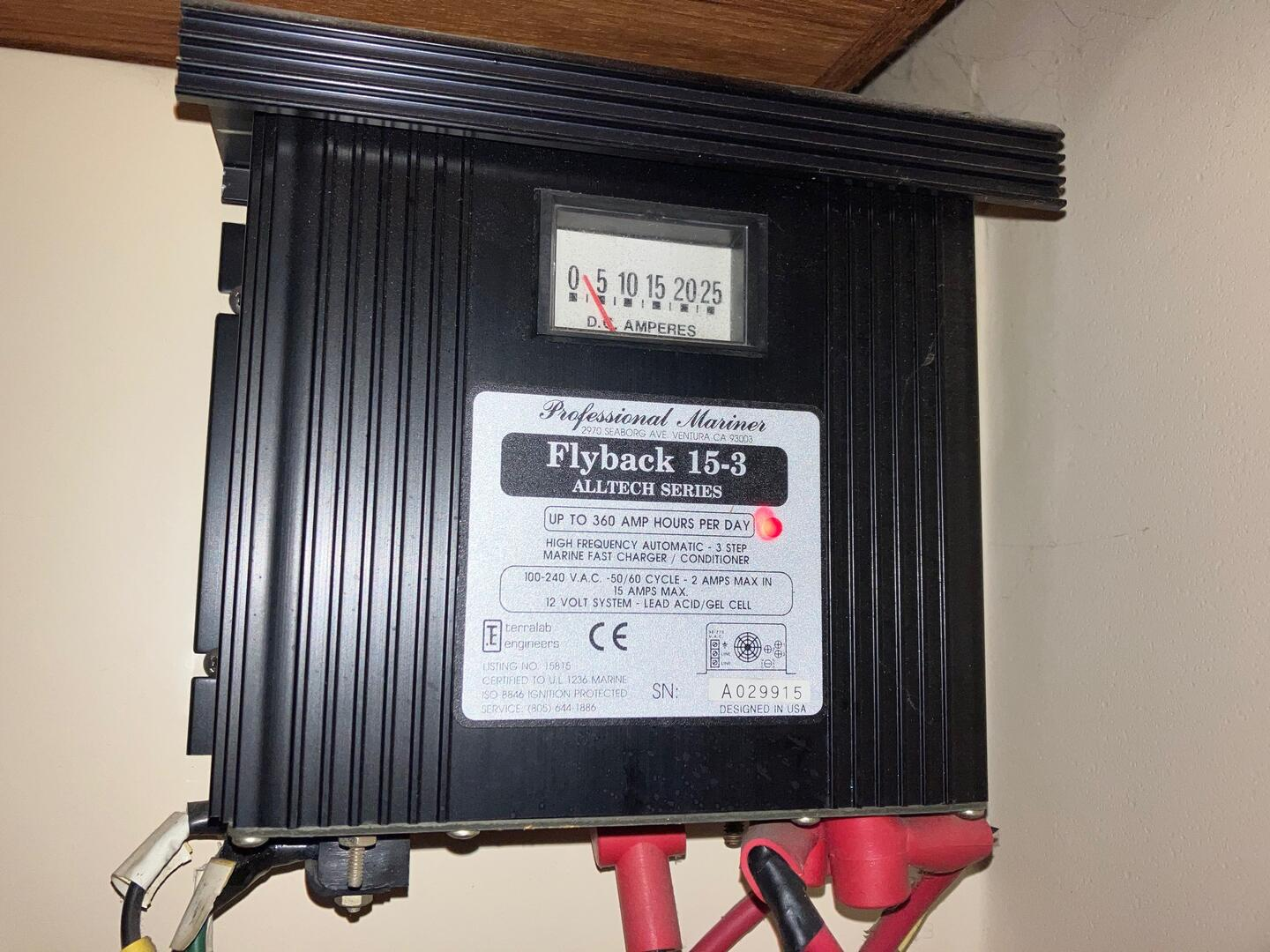

Can't locate online a replacement for the Flyback 15-3 Auto-Battery Charger or a suitable substitute or any suggestions for troubleshooting the system.
Flyback  15-3  ALLTECH SERIES
UP TO 360 AMP HOURS PER DAY
(Flyback) HIGH FREQUENCY AUTOMATIC 3-STEP MARINE FAST CHARGER/CONDITIONER
FLYBACK 10-3, 20-3 PROMATIC 30-3, 50-3, PROMATIC 21-3 (24V), 16-3 (32V), 14-3 (36V) f OWNERS MANUAL & INSTALLATION GUIDE

If I recall, that model Flyback is a fairly old school charger, without a lot of more modern smart technology.   Mainesail (former C36 owner) has a good article on things to look for in a modern charger and how to install. https://marinehowto.com/installing-a-marine-battery-charger/ .    He recommends the Sterling Pro Charge Ultra, and has a link to a good distributer (https://baymarinesupply.com/sterling-procharge-ultra-battery-charger.html?ref=cms).   We installed one of those on our former C36 and were quite pleased with its performance.   (We installed a Victron Multiplus inverter/charger on our current boat; its a pretty hefty unit, however).

This is what I replaced by C36 battery charger with:  Mastervolt 12/40-3 https://www.mastervolt.com/products/powercharger-12v/powercharger-12-40-31/
