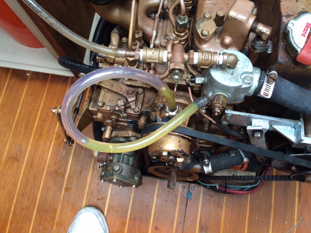

I made myself a simple reverse-flush adapter.  See first picture.
I drained all the fluid out of the lower starboard forward petcock (on the engine of course) and then pumped all the fluid out of the reservoir on the port side (coz the drain bolt is old and frozen in place).  Here I was trying to get ALL the fluid out of the engine, except for the coolant in the reservoir.  I'm not sure I got it all but I don't know where else I could drain from. Anyone?
Then after closing the petcock, and unconnecting the clear tube in the second picture from the thermostat housing, I attached the reverse-flush adapter to the clear tube.  You want the other end of the clear tube to remain connected to the hose connection that goes into the coolant pump. This is the key to reverse-flushing because this hose connection outlet is normally upstream of the closed thermostat.  Note that the clear tubes are just temporary!  I was just using them to see what kind of gunk would flow through the coolant system.
Then I plugged the SMALL thermostat housing hose connection and unconnected the LARGE hose going into the thermostat housing.
Then I put the large hose that used to go to the thermostat housing into a 5-gallon bucket. This was a bit hard to do.  Hold it with your knee or whatever.
Then I plugged the large thermostat housing hose outlet. Otherwise, even though the thermostat is closed, some water will still come out of it during the reverse-flush.
Then I removed the coolant cap (or what in the auto industry they call the radiator cap) so I could see the water rising in the reservoir.
Then I attached my dock hose to the reverse-flush adapter (again, first pic) and turned on the water - not too much pressure. I was just trying to simulate what the coolant pump would be pushing.
Note that since I (a) had the dock water hose connected to the coolant pump hose outlet and (b) had the large thermostat housing hole plugged, all the water back-flowed through the coolant system and ultimately into the reservoir.  All the gunky water poured out of the reservoir top large hose into my 5-gallon bucket, thus reverse-flushing the entire system.
Anyone disagree?  Do you think I got it all, including the hot water tank? This is the first time I've tried this, so it's certainly up for debate... but it seemed to have worked, i.e. reverse-flushed correctly because after I did this for a few bucket loads, the yucky brown water became quite clear.
