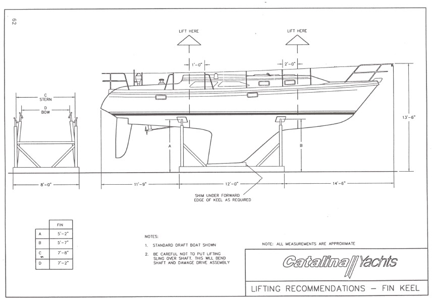

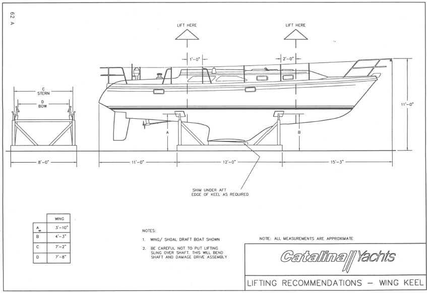

Peter,
Blocking the keel is a variable process.
As the yard's crane (or hoist) lowers the hull, pieces of timber is placed under the keel to shim it (see attached drawings). Although this is a relatively simple process, it is important to prevent undue stress, opening "the smile" or worse.
I always make sure that I'm on the scene when Tara is blocked in a hullout. Sometimes boatyard crews are not aware of the Catalina keel shape; it is not flat like a Hunter (oops, dreaded "H" word) boat.

I too tried placing a 2" block under the forward edge of the keel a few seasons back when placing the boat on the storage cradle. This procedure may work for those using jack stands for support, all this will do is place too much weight on the cradle rear pads causing an indentation in the hull by one or both pads.
I tried this and luckily I was there to observe the process, plus having a yard master experienced enough to detect a problem with the boats weight on the rear pads.
The Catalina shipping cradles will sag if the keel is not supported along with the 4 corners. On my cradle, I now need three 2X12X4' boards under the keel to insure minimal weight on the rear pads.

I forgot to mention in my earlier response the my C36 has a wing keel.
Jack F Stewart
Thanks for the advice I will ensure I have a plenty of blocks available- mine will go on jack stands so I should be able to keep weight well balanced.
