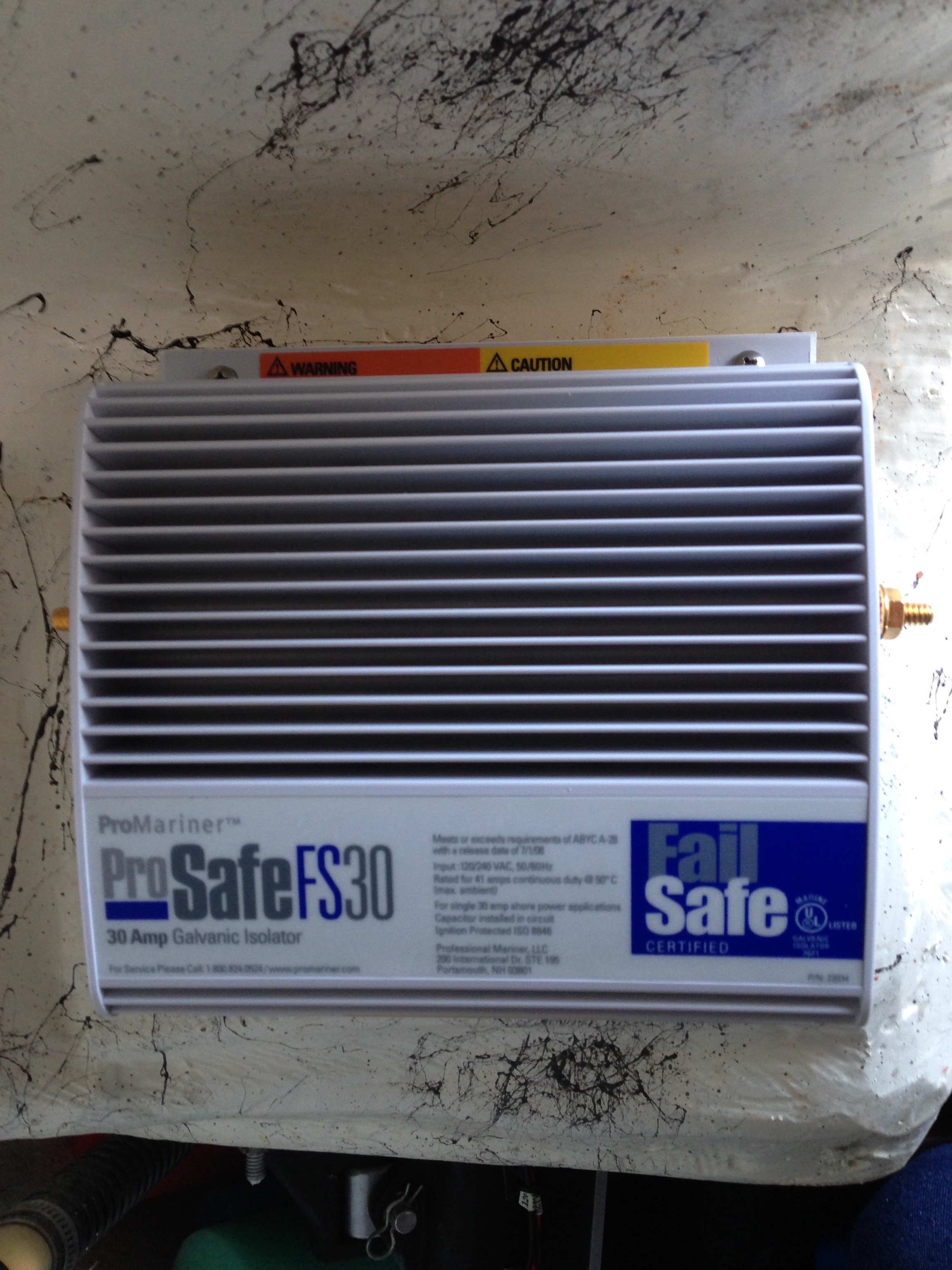

I decded to upgrade my galvanic isolator to a fail-safe unit and to upgrade the main shore power disconnect switch/breaker to one with an integrated Equipment Leakage Circuit Interrupter (ELCI). One of the reasons for doing these upgrades is for safety and the other is to bring my 2002 36 closer to the current ABYC standards. Safety is why the boating industry has adopted ABYC standards.
The old Zinc Saver II on my boat does not currently meet ABYC Standard A-28. The standard states, “a galvanic isolator shall be equipped with an integral or external status monitor that provides an audible or visible indication of failure.” There is an exception to an external status monitor and that is if the unit is fail-safe. Fail-safe means it will continue to provide ground continuity if it fails.
The ProMariner ProSafe FS30 that I installed meets the fail-safe criteria. Removing the old unit was easy and straightforward. I cut a piece of starboard to fit the footprint of the new FS30 and secured it in the spot where the old unit lived. See photos. For those who have their boats in salt water you might want to think about checking your galvanic isolator from time to time. If it is not functioning, you run the risk of having corrosion on your boat. There is a great article with photos of how to test a galvanic isolator at Pbase. http://www.pbase.com/mainecruising/galvanic_isolator.

Removing the old unit was easy. I left the upper part of the box intact so I could use it to attach the new box too.
