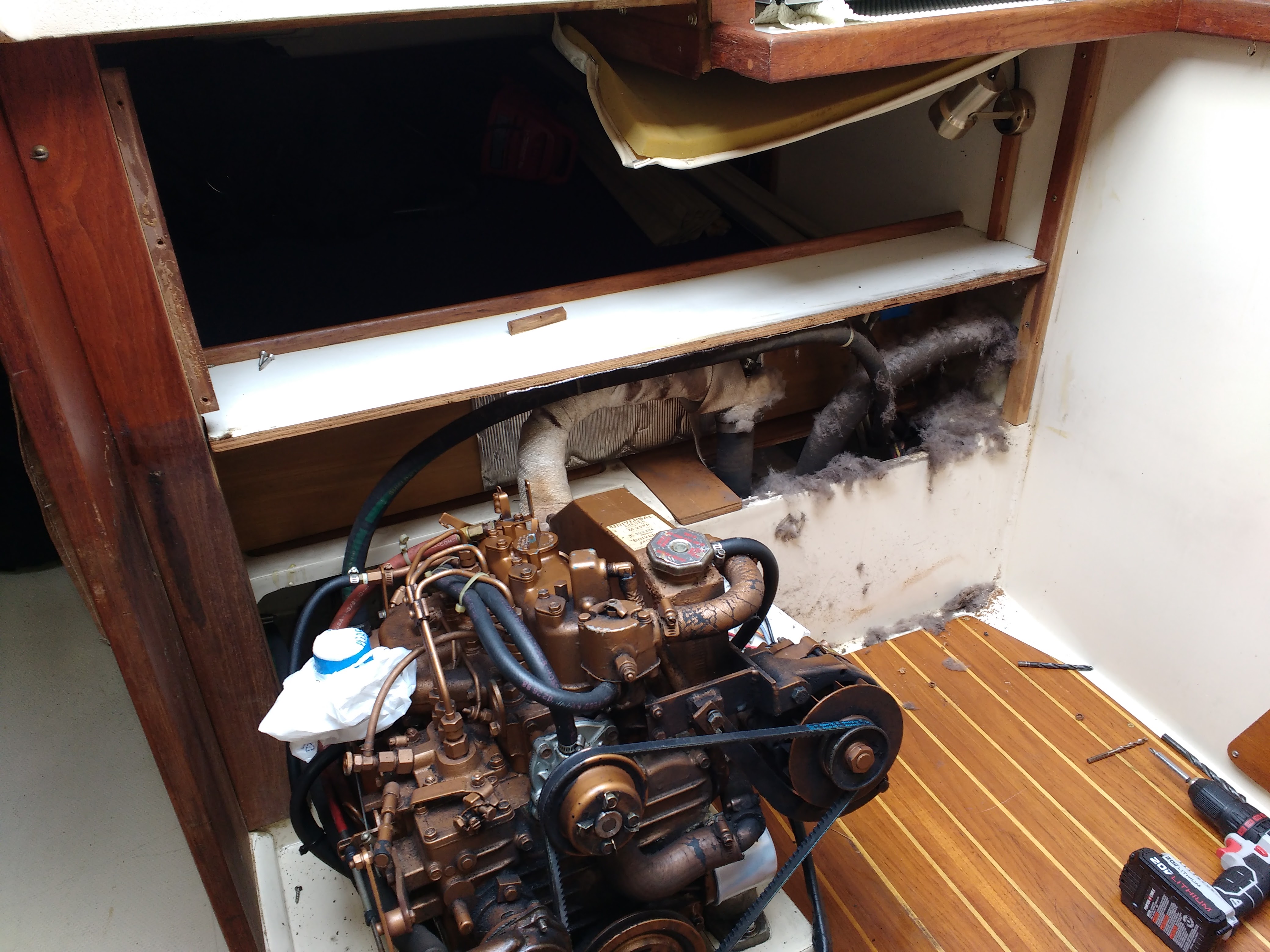

The Story - After a North Channel trip 2 years ago I started noticing fine fibers collecting at various places on the engine. They were mainly concentrated around the back of the engine to port and on the alternator where the cooling ports are. Last year that issue escalated so I looked into it this spring. I removed the cabin divider between the galley and aft cabin and found - - Fiberglass - everywhere. The heat wrap around the riser was held in place by wire. That wire rusted and broke and the wrap had started to come apart. I'm re-wrapping the manifold (it is in good condition) and replacing the hose to the muffler with the recommended hump hose.
