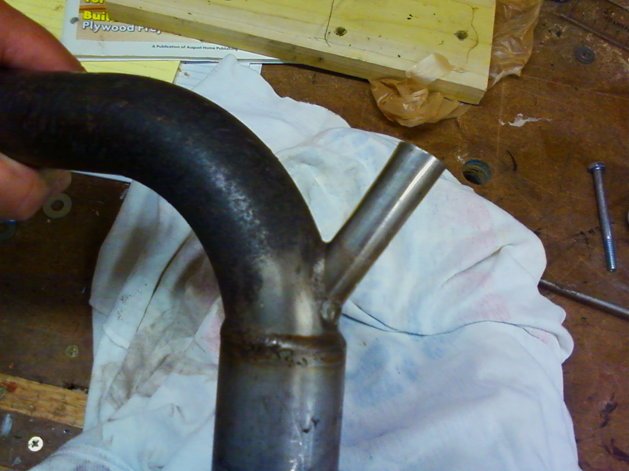

I just leak checked it with my compressor. I get small bubbles around the weld. I can just barely see a crack around the weld. Attached a crappy cell phone pic, but can't see it. I've tapped it everywhere and it seems quite sound, the blackening is from the rusted metal mesh under the insulation.
Taking it to get it re-welded.

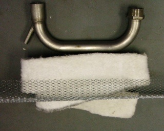

I saw rust on the muffler below the riser of my 2004 Mark II. I bought a new riser from Catalina then took the old one apart to inspect. It looked fine. I think the rust was from a leaky hose clamp and water on the metal wire which rusted. So I have the new riser with the wrapping and honeycomb mesh if you want to purchase it. I paid Catalina 220 + 42 shipping + 17 tax for total of $279.
Sounds interesting; my only concern is whether or not they are the same size. Catalina Direct insists that you send in your old one, so they can make a new one that's the same.
I'll measure mine and post them; we cans see if they are the same. My engine is an M35A, yours is probably a "B". Not sure if the dimensions of the 2 models would change the dimensions of the riser (or not).

Here is a photo of the new riser. Check with Catalina if this M35B riser is compatible.
thanks, I'll check with Catalina and get back to you. Thanks again..!!

Just to close this thread. As mentioned, the leak in my riser was a small crack in the weld where the water injection pipe enters the main pipe. I was able to get it welded for $20 bucks (I can't weld stainless); guy used a TIG welder to redo the original weld, then built it up about 1/4" all the way around for strength.
I reinstalled the riser this past weekend and no leak..!! For insulation, I wrapped it first with galvanized hardware cloth (metal mesh) cut into approx' 3" strips; just to create a bit of an air gap. Then some 1" fiberglass pipe wrap insulation, also cut into 3" strips. Then tightly wrapped with 2" header wrap. Once I had it installed, with a new hump hose and gasket, I put an additional layer of header wrap on, including wrapping the ends where the hoses clamp on and at the flange. I had left a bit of room at the ends so I could get at the nuts on the flange and get the hoses on and clamped. All held on with stainless seizing wire.
