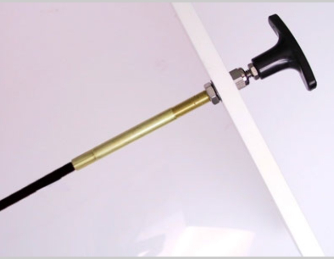

Jeff maybe I don’t understand but from your description above it sounds like the assembly is being pushed back in your panel.  I don’t see how this can happen if both nuts are fully tightened or someone kluged something else in place of the stock cables.  Does your end look something like this?!!
If the goal is to eliminate the T handle and cable - you might try a trunk or door popper.  You would have to measure the force necessary and buffer with a good spring, mounting would be the only issue but these are often not in line with the actuator and use a pulley for changing directions.
If if you decide to do this take pictures and write it up.
