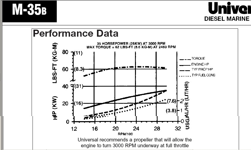

The M-35B had increased to 35 HP at 3000 RPM.
https://www.westerbeke.com/universalengines.htm

The universal M35b specs show a Max RPM of 3000 given that the correct propeller is used. Our 1998 M35b currently tops out at 2800 RPM. It has the factory installed 3 Blade propeller. Many vessels apparently had original 2 blade props, So I think that the question should be: What is your top RPM and what type of propeller do you have? Also the RPM guages are not always calibrated correctly at the factory (said my mechanic). so he calibrated our guage to read 2800 at full throttle.
