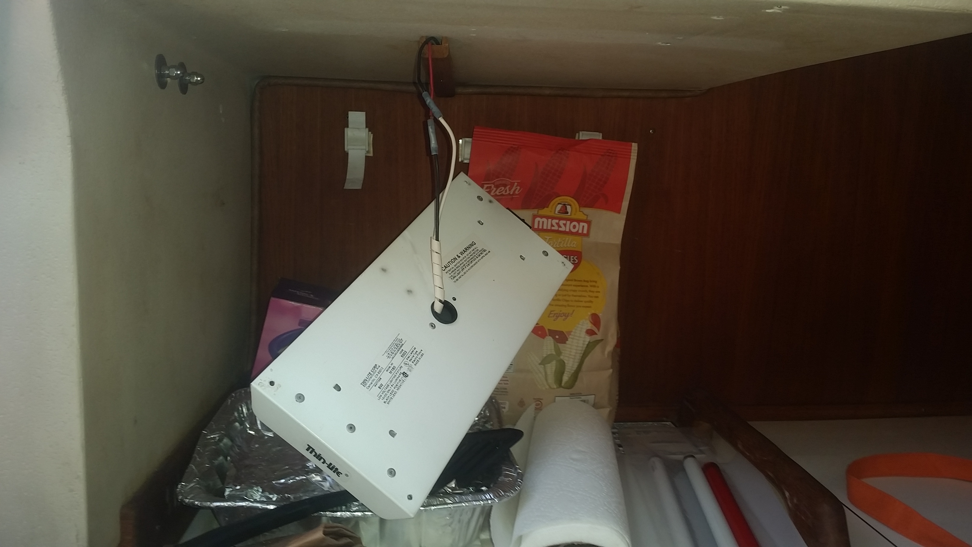

I am looking for input on my electrical issue. I have no power going to the port side light fixtures. After trying new bulbs-no help. I removed the fixture (see attached pic) and checked for voltage with a meter-no voltage.

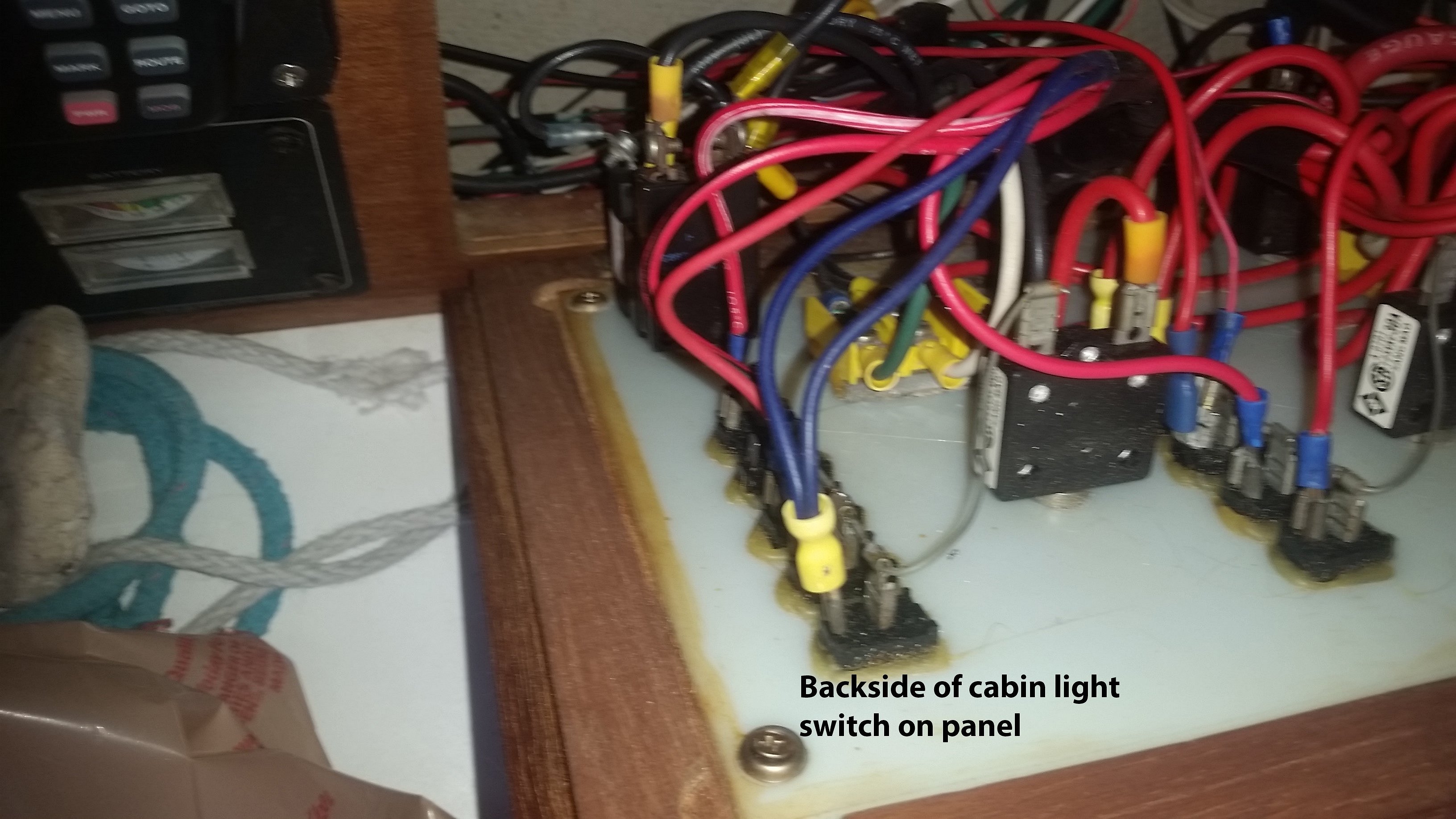

The question:Where is the splice from the panel to the starboard side? There are two blue wires coming off the cabin lights switch on the panel (see attached pic). These wires go into a taped loom. I haven't torn the boat up yet because I figure someone has "been there, done that" in the group.

I’m sure it crosses over somewhere but don’t know which fixture it would be spliced in.  Your friend here is a fox and hound aka tone generator and probe. $20 from Amazon  clip the tone generator on the dead hot lead and use the probe to follow the wire under floors, behind bulkheads..... till it stops (hopefully at a fixture).

Basically it crosses from starboard to port in the bow. Look at the  schematic in the manual. If all the lights work on the starboard side up to the bow, but nothing from there on I would suspect that the last light that works is where the problem lies. I had a Cat 30 (1984) and the bow lights were also part of the circuit and it came apart in the anchor well
Additional comment note if your bow light works then one would assume by schematic that the black wire is OK to where it leads off to the bow. One could suspect that if the junction is bad at this point then the lights after that will  not work. If indeed the connection is good then the issue is between that point and the next light in the string. based on schematic.

​Going back to your original post. You show you have two blue wires. In the electrical panel schematic which I have posted a copy from the manual there is only one supposedly to the cabin light panel switch. So someone has changed something. The schematic shows the blue wire going from the panel to the aft cabin (starboard side) first then to the lights along the starboard side to the forward cabin light, from here finds it's way to the port side to power the portside lights. Obviously a PO made some change and you have added another. You may wish to document your new way so that you or someone after you has a place to start.
