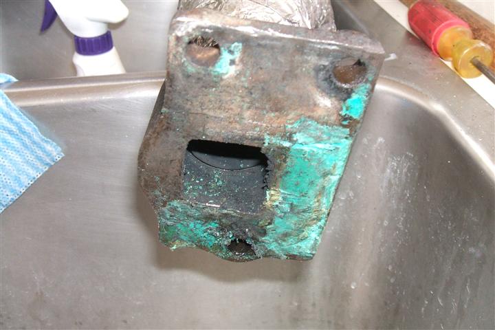

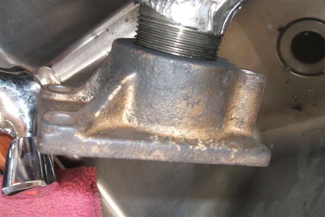

I removed the exhaust pipe from the rear of the engine to replace the black muffler hose with the blue hump hose. I now need to replace the gasket and reinstall the exhaust pipe. When I disconnected it, water flowed out. Was this just trapped seawater, engine coolant or both? The mounting flange on the rear of the motor appears to have two passage ways and I'm not sure if coolant as well as seawater passes through the exhaust pipe.

The top opening is exhaust gas, the bottom is your fresh water coolant. That's why it's so important to be very careful replacing the new gasket when you reassemble it.
Sid, if it's not too late to ask...could you post a few photos of what you find there? Thanks.
Exhaust manifold pictures
