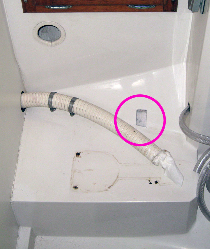

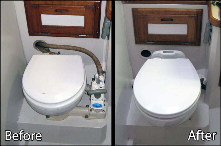

I actually installed a Raritan "Marine Elegance" electric head over the weekend. Couldn't be more pleased! It's certainly quieter than the main water pump...
The only modification we had to make was to cut a little notch/slot in the skin in order to slide the unit far enough back so that the forward edge didn't overhang at all. (See attachment...) I should mention - you only have about 1/2-3/4 of an inche between the hull liner and the actual hull - so be [B][I]careful[/I][/B] when cutting this notch! (Obviously - you don't want an impromptu through-hull...)
And we thought about (and mocked it up) angling it away from the bulkhead a bit, but found that wasn't really necessary. Once you don't have the hand-pump to deal with, you can slide the unit a couple inches toward the bow, giving you more than enough room for big guys like me... Plus, at an angle, we found that the lid hit the bulkhead and the cabinet...
For electrical, we actually tied into our cabin lights circuit, since we have converted to fully LED and had the amps to spare. And, we placed the control unit under the shower sump switch. It certainly saved having to run new wire all the way back to the panel.
The hardest part was wresting the 1-1/2" discharge hose into place without causing the toilet's discharge line to crimp...
