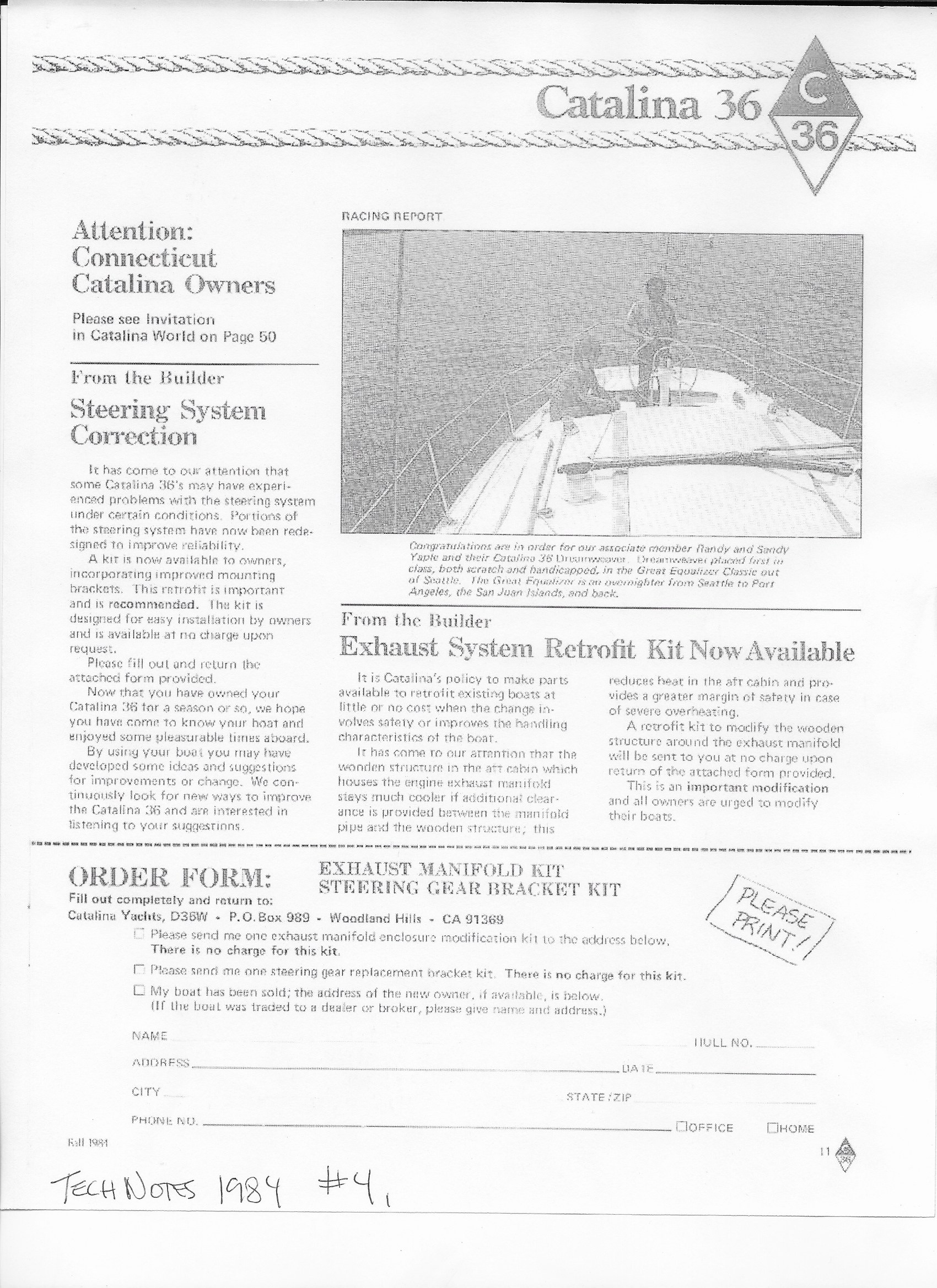

I have same vintage; hull #222. Lost steering ~300 miles off shore, main bracket attached to rear bulkhead snapped in half. Emergency steering is a sad backup (all another story). Main point being that this steering setup was a faulty design and never should have been installed on a 36 sailboat. Early in the game (~1983) Catalina realized this error and sent out a technical note describing a knee bracket fix designed to beef up this wonky arrangement. Problem being that under steering stress the flimsy wooden bulkhead (mine was ~1/4" plywood and very poorly tabbed to the hull) to which the steerting bracket is attached will flex thusly relulting in the bracket itself trying to flex. The bracket is a cast a product and thus has no ability to flex at all so it snaps in half...with an explosive boom...and ther goes your steering!  The bracket was made by Edison but I believe it is no longer in production...I think I bought their last one...actulally I bought two...extra one as a spare if this madness ever strikes again!  I completely rebuilt the rear bulkhead and had the it professionall tabbed to the hull as CY should have done initially. FYI, a sailing buddy has a 1987 Catalina 30 w/ this identical steering setup except for the fact that the rear bulkhead to which the steering bracket is attached is ~3/4" thick and is properly tabbed to the hull.

FYI, attached is a copy of this initial (and only one I am aware of) recall notice by CY. I was not aware of this when we purchased out boat in 1994. When I learned of this years later I called CY requesting a steering bracket kit but was told they were all out!
