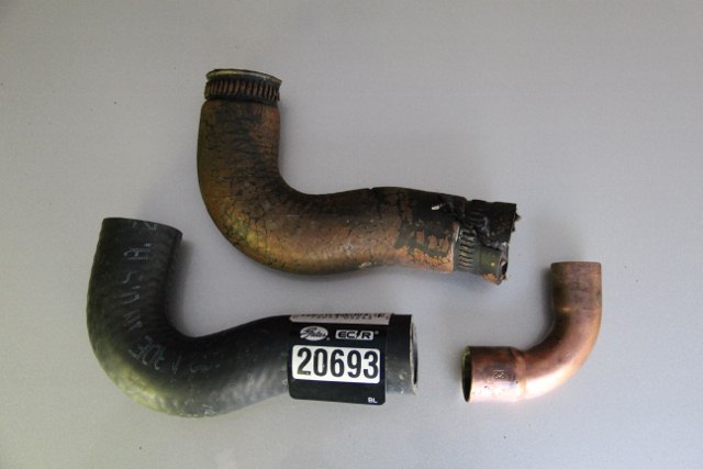

I too wondered about the hoses on my engine (looked to be original) so last year decided to change them out. They all visually looked ok, no cracks or bulges, but about what you'd expect for their age. I can say without a doubt the peace of mind was well worth the price. Went with the Trident 250 series hose and the Gates hose - see picture from another post for the bent piece at the front of the engine
