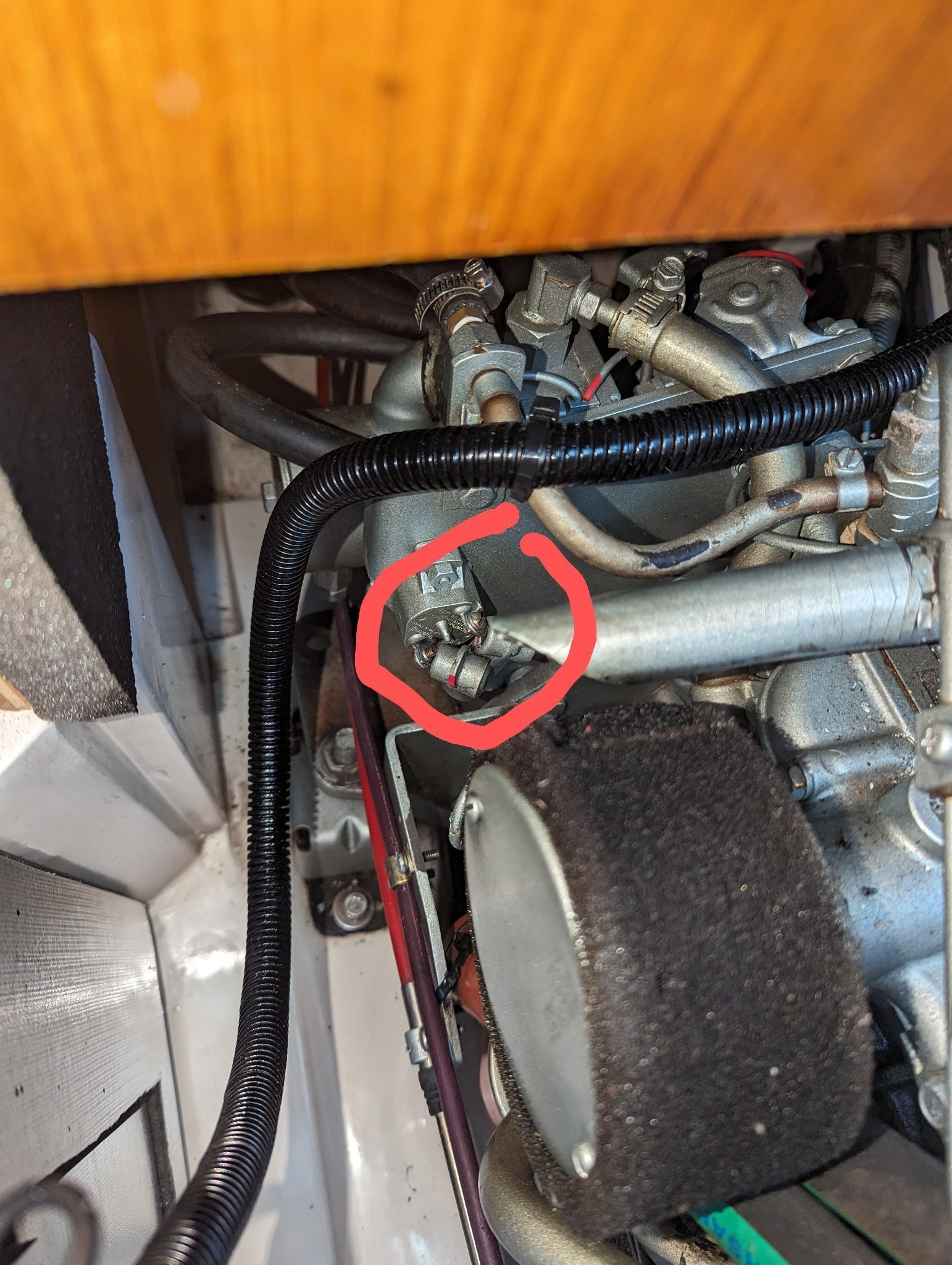

Hi all,
I was checking my oil and when I put the dipstick back it touched 2 terminals that I hadn't noticed (right behind the dipstick!!). It sparked, now there is no power when I try to start the engine.
I assume a breaker has tripped or a fuse has blown, but I don't know where to look. Does anyone know how to fix this?
Attached  a picture of what I touched. Any help would be greatly appreciated!!

That is the back of the electrical breaker for the engine.  Try resetting it.

Hi, yes, I found it when I looked at the other side of the engine. I think on going to put a bit of e-tape over one of those terminals!
