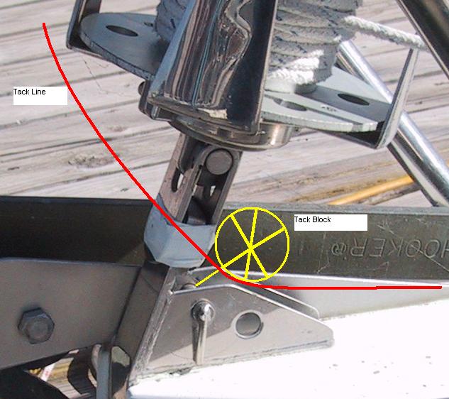

I used the pin just behind the stem fitting to attached the Tack Block. Since I use the Tack Strap on the sail, there really isn't much tack adjusting that I need to do. I typically leave the tack set just above the pulpit, in the lowest position to allow closer sailing angles.
I ran the tack line down from the strap, through the block, and straight to the bow cleat. Granted this may bring in an issue of chafe around the furling drum, but the tack strap is taking the majority of the load and I have about 500 feet of spare line in the dockbox. That being said I have not needed to replace the tack line.
I am certain that there is a better way to do this, but this has worked well for the light air use the sail primarily gets.

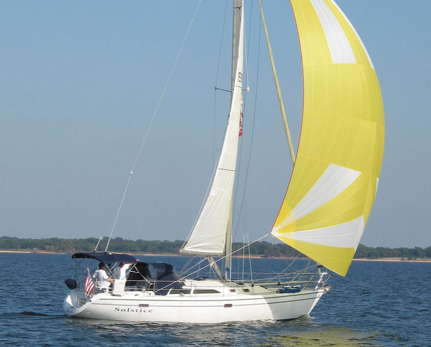

I added 3 photos, 1st is a diagram of the tack block rig, 2nd over all shot that shows sheeting positions (zoom in to see the tack strap), 3rd was a picture of block location furthest aft on the outboard track.
Good luck and I would love to see how other people rig the tack line.
