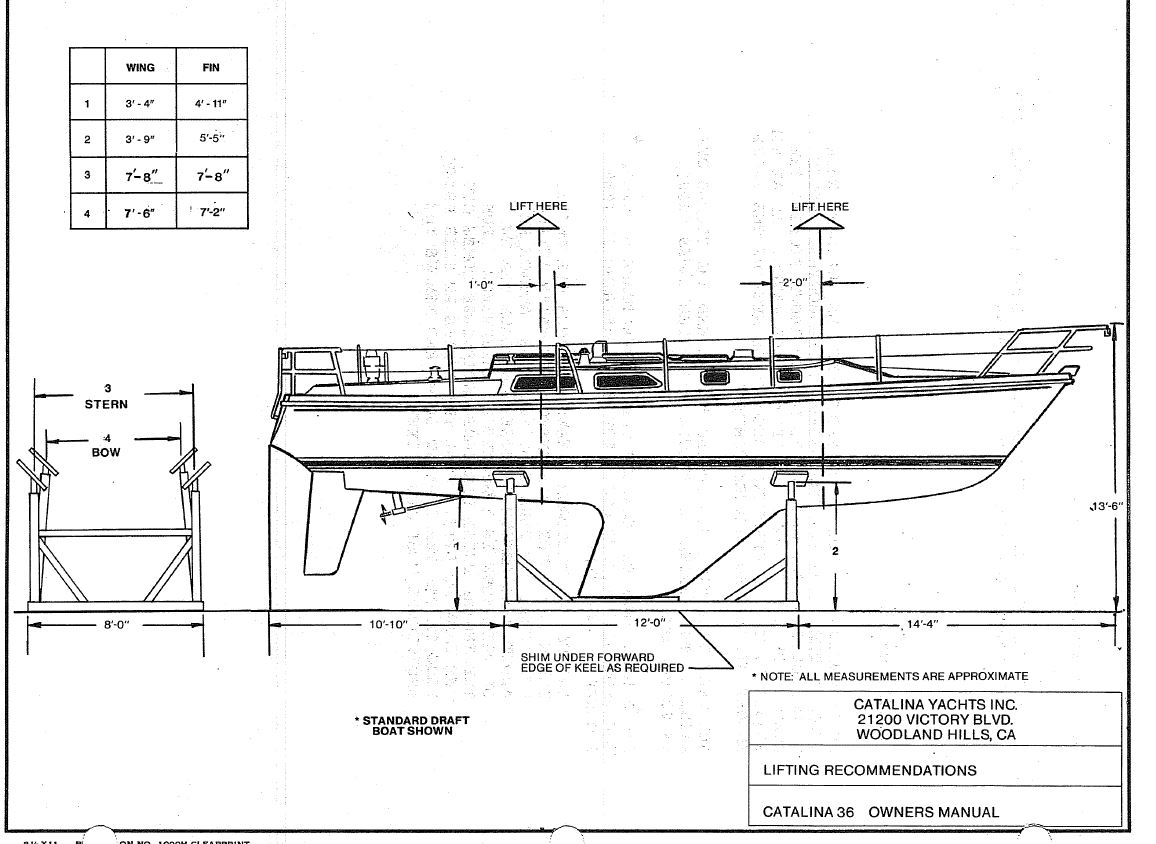

I could have sworn I saw detailed cradle plans and measurements on this forum before, now that I need them, I can't find them. Did they get lost in the upgrade?

Cradle drawing is in the MK1 owners manual. Attached is a screen shot of the page

Thank you!
