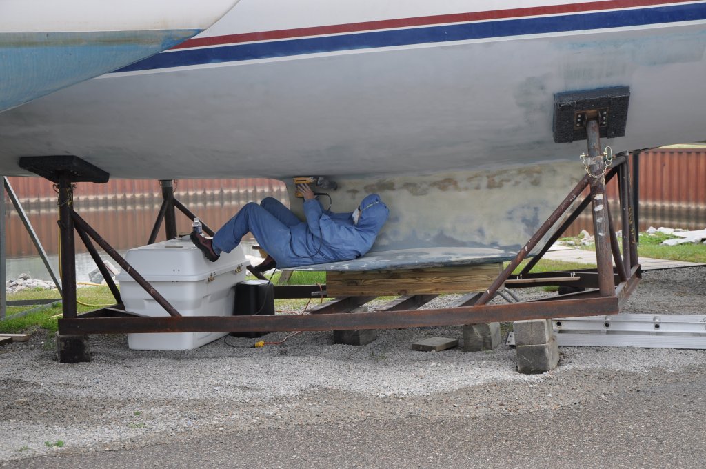

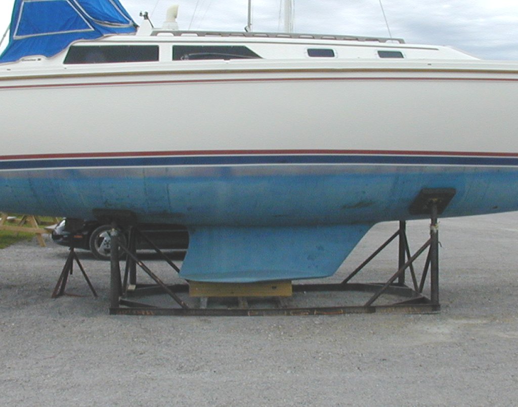

The other issue I ran into when we bought our boat down in Lorain, OH was that it had been stored on its cradle backwards for many years. The cradle was labelled bow and stern, but they were on the wrong ends! As a result there was longitudinal gelcoat cracks around all of the pads because they were taking most of the weight. The cradle is an original Catalina cradle for a wing keel. See the attached picts for the right and wrong way to put the boat on the cradle.
By the way, the person on their back on the wing, sanding the bottom, is my lovely Admiral!! That picture shows how the boat should be oriented on the cradle. The second picture was taken when the boat was delivered to our marina and was placed on the cradle as the "bow" & "stern" labelling suggested. The marina had to add an additional stand aft of the cradle as the boat wanted to tip backwards.

If you look closely at Toms cradle, you will see that he has raised the keel support boards with three additional 2" thick 12" X 48" boards. In my case, the cradle is also severely bowed and I now have a total of three 2" boards under the keel. I think I need another inch with the present bow.
When our yard sets the boat on the cradle, I make sure they also support under the keel. You also have to make sure the forward edge of the keel, where the Calalina smile is located, is 2-3 inches behind the front horizontal steel pipe member.
Next fall, purchase a 2 x 12 X 8' piece of treated lumber at Lowes, cut it in half and place one or both pieces under the keel when your yard transfers your boat from the sling to the cradle. If you decide to structurally modify your cradle, you will still need to find out the right thickness for your keel support boards.
