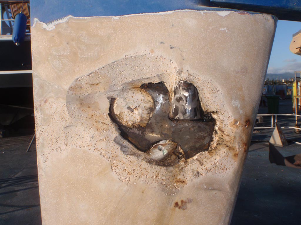

I am not totally sure how the Catalina rudders are fabricated; but I do have experience with that kind of rudder repair on my previous boat - a Newport 30 and all I can say is - good luck! (and here is why...)
The rudder used to 'weep' water for 2-3 days after being put on the hard.
I removed the rudder and then removed some glass and gel coat around the cracked area, then re-glassed and barrier coated, before painting.
Two years later had a tough crossing of Georgia Strait in 25 knots close-hauled. On getting to our marina did a 90 deg turn at the dock and the boat kept going straight. :eek: Rudder stock had broken from the frame inside the rudder!! Had a new rudder built from scratch - it worked better than the old one ever did (less weather helm, etc (more balanced)
My point is: You can repair the crack and if you're confident no water has made it's way into the rudder you should be fine - but you can never know if there has been corrosion inside; and to what extent....

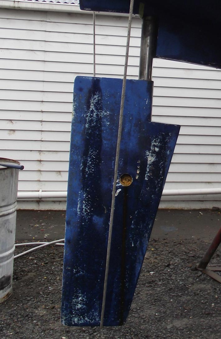

Rob Kyles's picture
Rob Kyles
Joined: 6/15/08
Posts: 172
[QUOTE=HowLin;21392] - but you can never know if there has been corrosion inside; and to what extent....[/QUOTE]
That's largely true...
But we found a way - we noticed a small crack weeping rusty water, about 300mm below the 'notch' in the rudder. I lowered it with a 12mm line (photo) and drilled a circular hole to investigate. There is a MILD steel plate with holes to lighten it welded to the SS rudder stock. Ours looked OK, so I dried it and bogged it up.
We then sailed from New Zealand to Tonga, Fiji and New Caledonia, late 2012.
I noticed the 'bog' failed, and rusty water came out the whole circle of the patch. We hauled out in Noumea and had the whole shebang ground out and all new filler and a heavy fibreglass bandage put on. It appears a PO had run aground and bent the rudder - then did a cheap fix with a light skin of glass. Our rudder was just about to break off level with the bottom of the stock!
