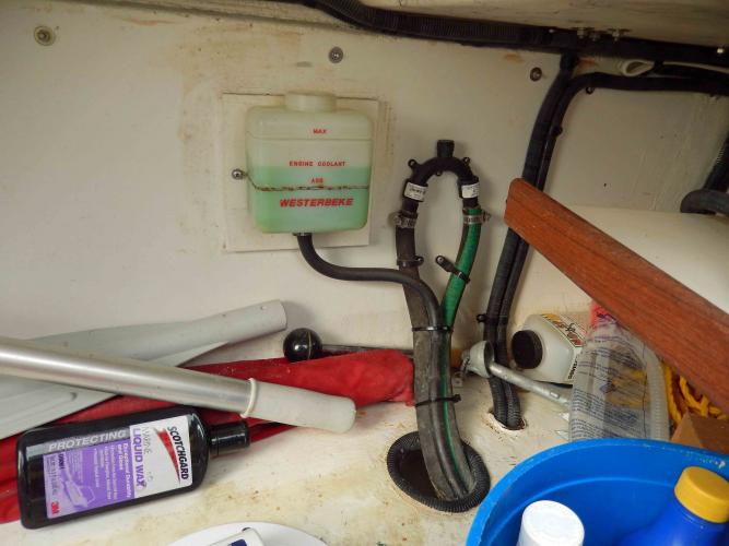

I have hull # 1015 and I am adding a coolant recovery bottle while I am doing engine service. Where is a good place to mount the bottle? I have looked for engine room pics without much luck.

Mine is located in the port lazarette.

Mine's in the port lazarret too. If you mount it there, just be sure you don't put it so high on the bulkhead you can't add coolant in the future. Mine is factory mounted and I have to use a funnel and a soft container I can squeeze to a narrow funnel shape to get coolant added.

Do you have pics of the installation?
Posts: 616
Here you go... I have no idea on how its plumbed into the cooling system.
