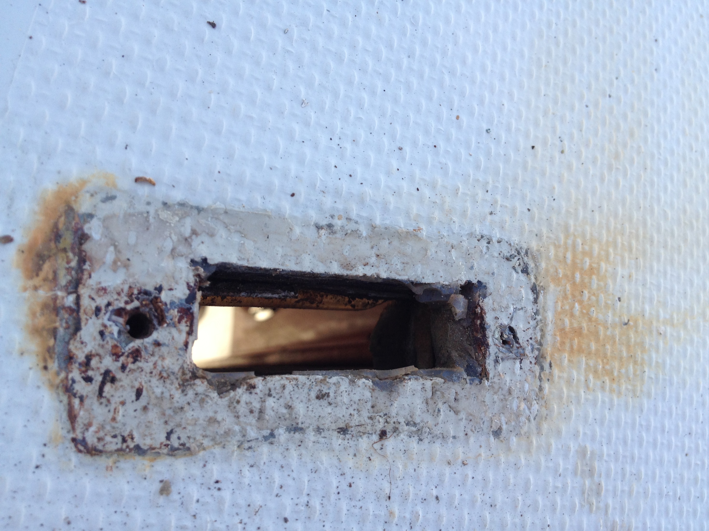

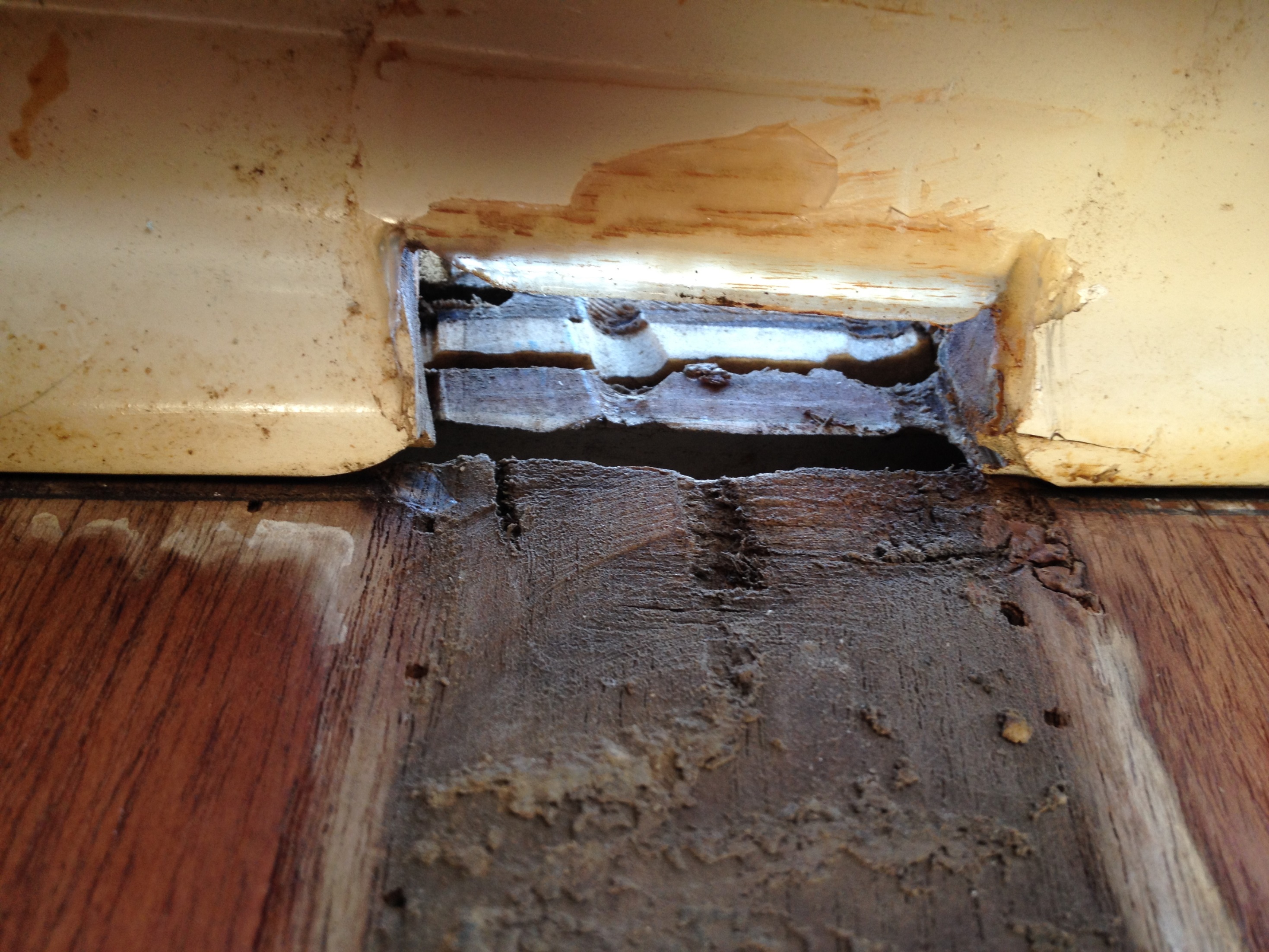

Here are photos I took in 2014 when I replaced mine.  I don't recall if any of that was wood but you can see in the photo there was a sandwich with some gaps in the layers.  I injected epoxy to wet it out and then injected increasingly thickened epoxy until I was able to fill the voids.
I also injected epoxy into the bulkhead that the chain plate sits up against - I masked it off so you can't really see it with the chainplate in place.
