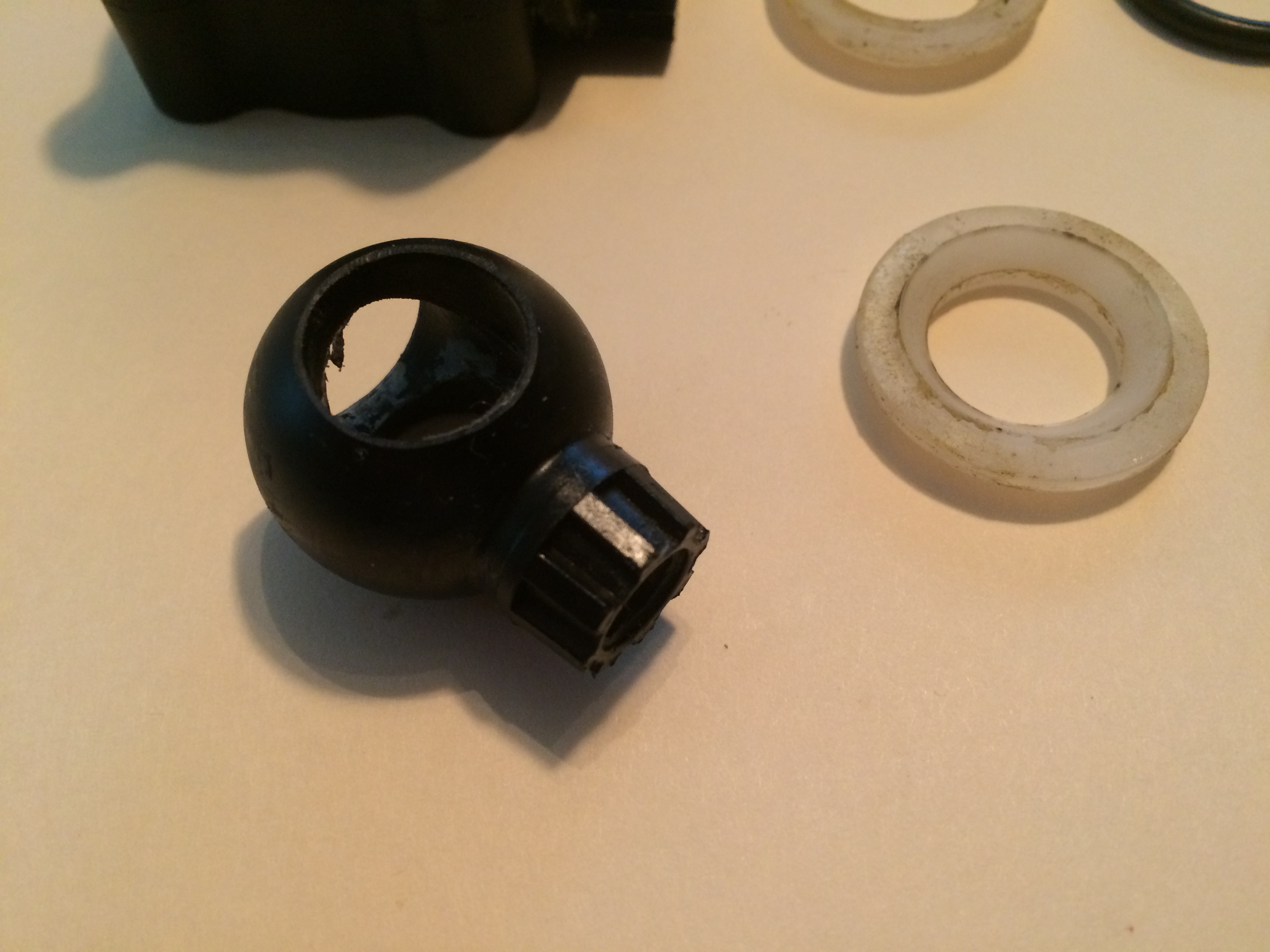

Last night we were closing up the boat after a week long cruise, and I tried to shut off the galley seacock. We are always diligent about closing the seacocks when we leave the boat. But no good deed goes unpunished.
I turned the handle on the Forespar Marelon seacock and it broke off in my hand. Worse, a solid stream of water began to gush from the hole where the handle fit.
This is not what I would call a "fail safe" design. I imediately pulled out the under sink drawer and put the handle back into the hole. This slowed down the water flow to a trickle, but I could not use the handle to turn the ball to the closed position.
I also couldn't sit there all night like holding the handle, so I asked my wife to get the doomsday box, complete with wooden plugs, a variety of tapes, and my new best friend, silicone Rescue Tape. It is expensive but worth every penny.
Anyway, my wife cut off one foot strips and I wrapped them around the valve, and holding the valve handle in place. The Rescue Tape stuck to itself, even under water. Absolutely amazing stuff. In a few minutes, I had the water flow slowed to a trickle, and I could think about what to do next.
I wish we had caught the whole thing on video. The unedited version of events is much more exciting...
At this point I noticed that the bilge pump was oscillating, pumping out the water, shutting off, then turning back on when the water ran back down the hose. - not useful, and now on my to-fix list, right after the broken seacock.
Fortunately, Forespar includes a little white plug in the handle of the valve for plugging the thru- hole. (Really, that is what that little white plug on the handle is for!) The plug for the galley sink was under several wraps of tape, so I borrowed one from the head seacock.
All I had to do was swim under the boat, find the tinny hole for the galley thru hull in the fading light, and place this little plug into it. (The bottom kill) Simple.

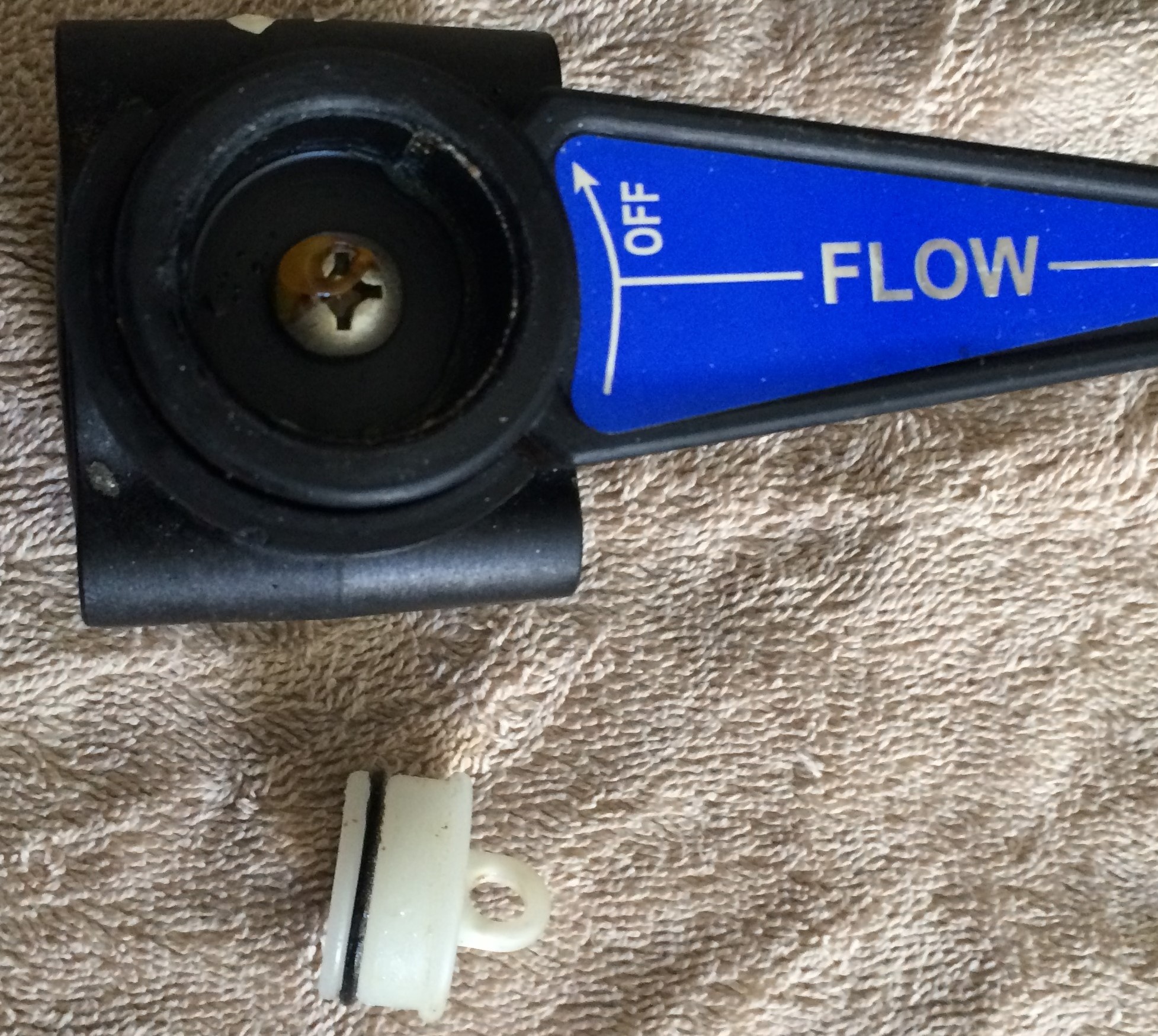

The emergency plugs on the Forespar seacocks are located at the pivot point of the handle. On my seacocks they are white, and have a small plastic ring molded into the top so that you can pull them out.
The plug does not fit tightly, which is a little disconcerting, Forespar claims that water pressure will keep it in place. (We will see if this is true when I return to the boat on Saturday!)

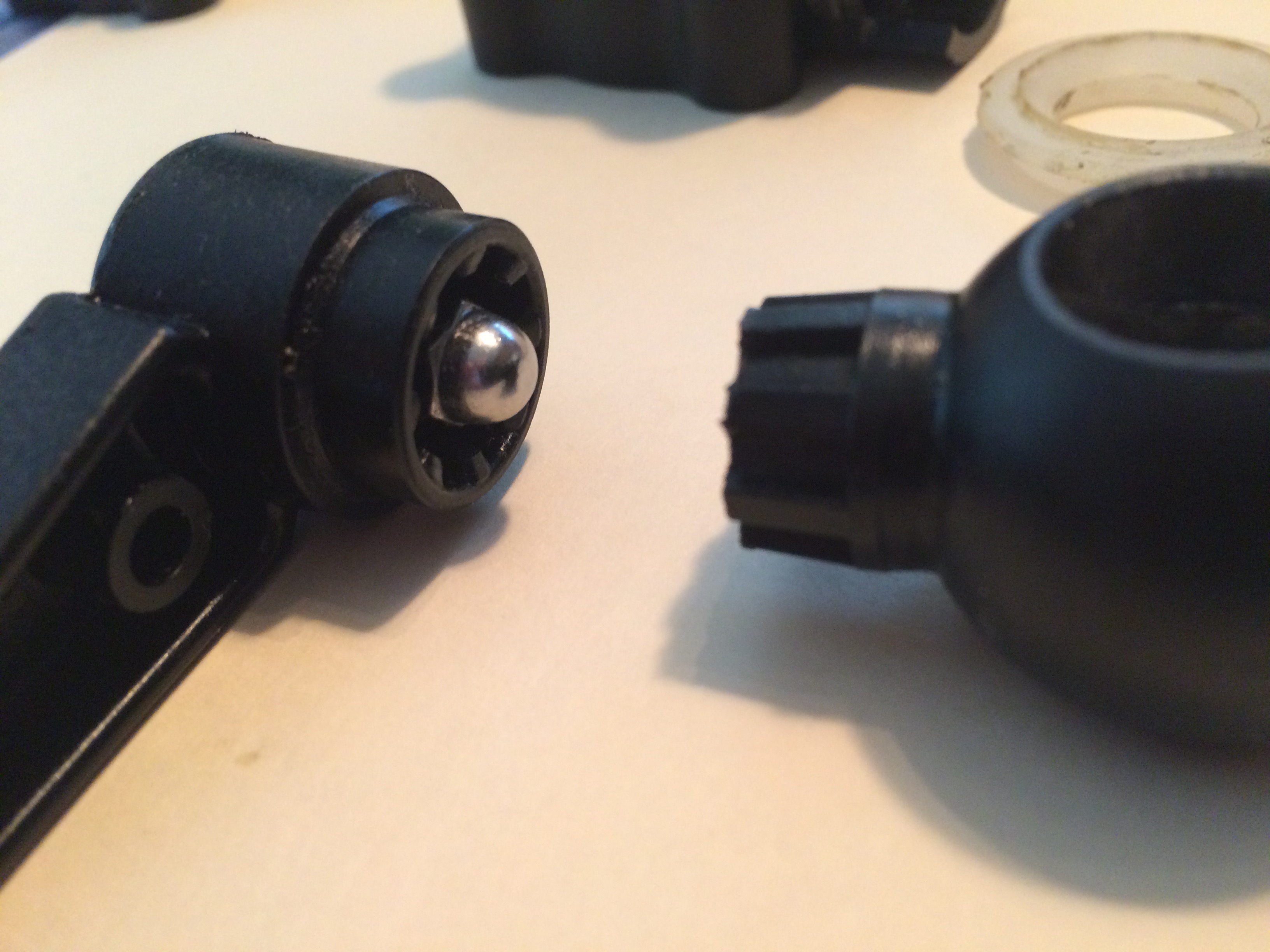

Regarding the failure of the valve, I attribute poor design of the crica 1995 valves.
The handle on the seacock engages a spline inside the valve. The handle is held on by a tiny sheet metal screw. The o-ring seal for the valve is on the handle, not the internal ball.
I must have put some side force on the valve, the sheet metal screw pulled out of the spline, and the valve handle popped out.
The next problem was the valve was open, so the water pressure caused the ball to shift in its seat, so that the spline was no longer in the center of the hole where the valve handle fit. Thus the handle would not go back on.
Had I been able to see what was happening, I could have re-centerd the spline with a screwdriver, and then slipped the valve handle back in place to close the valve.
Knowing what I do now about how the valves work, a big wad of marine epoxy stuffed in the held hole, and held in by rescue tape, would have stopped the leak without preventing me from replacing the valve later.

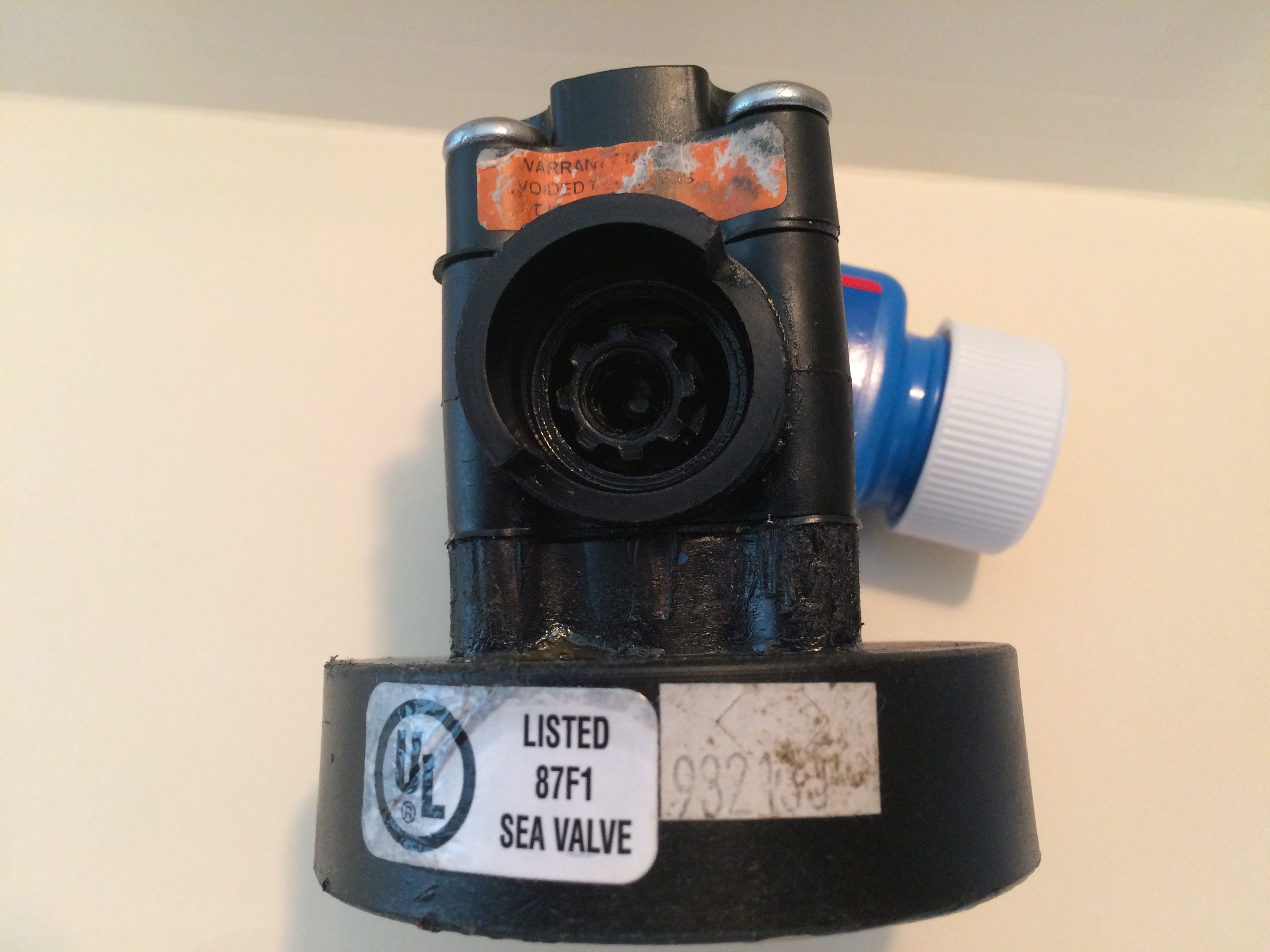

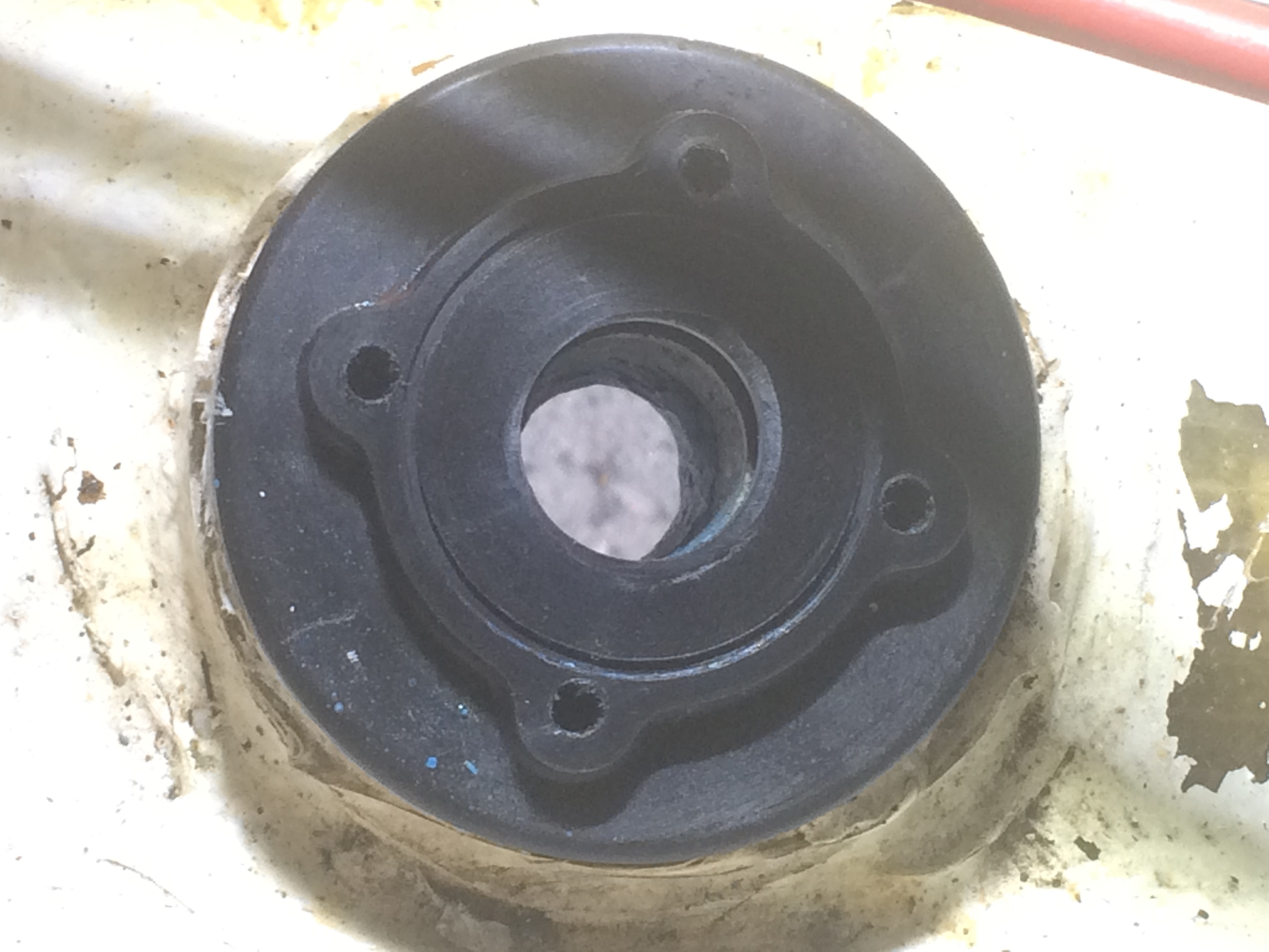

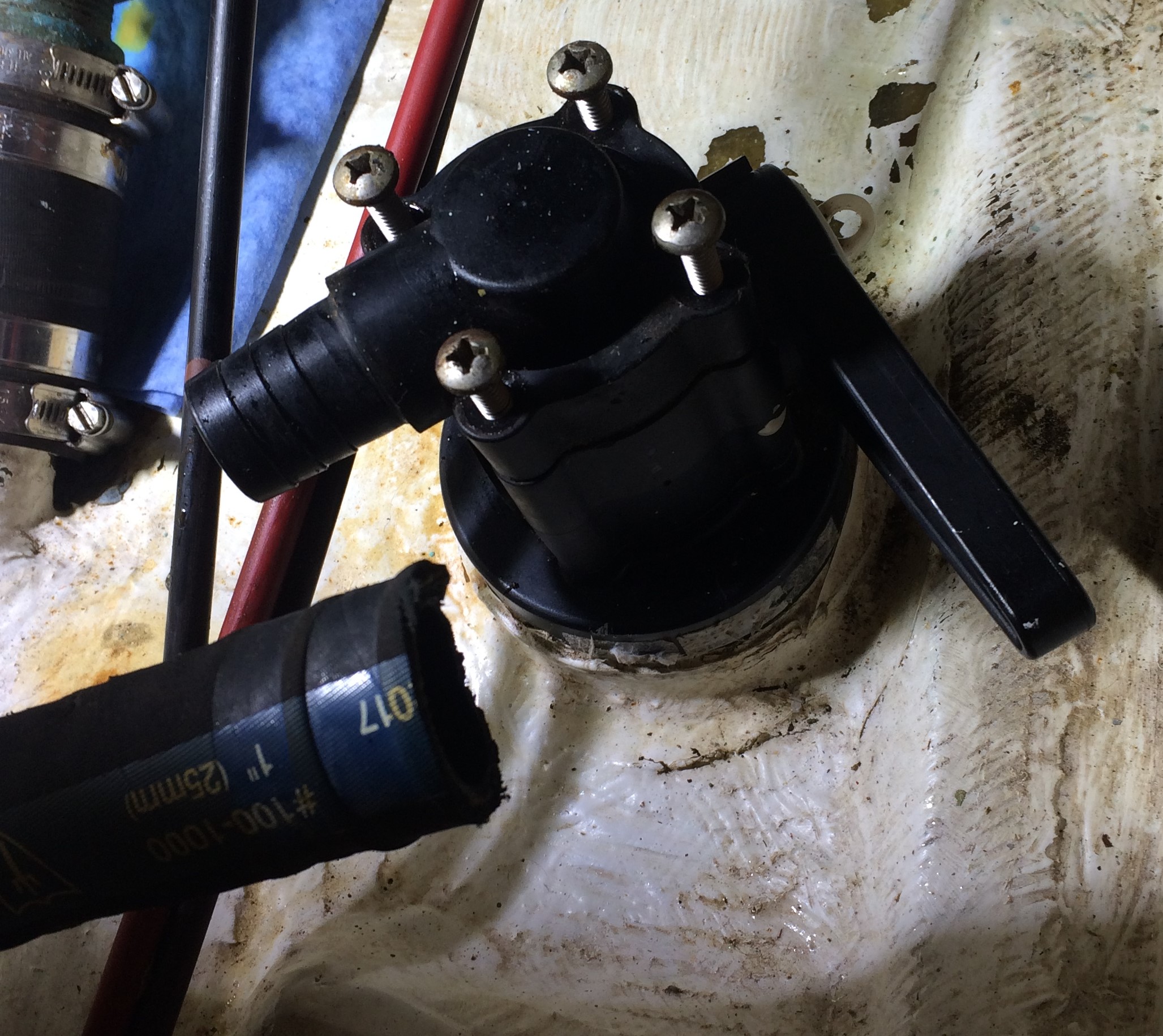

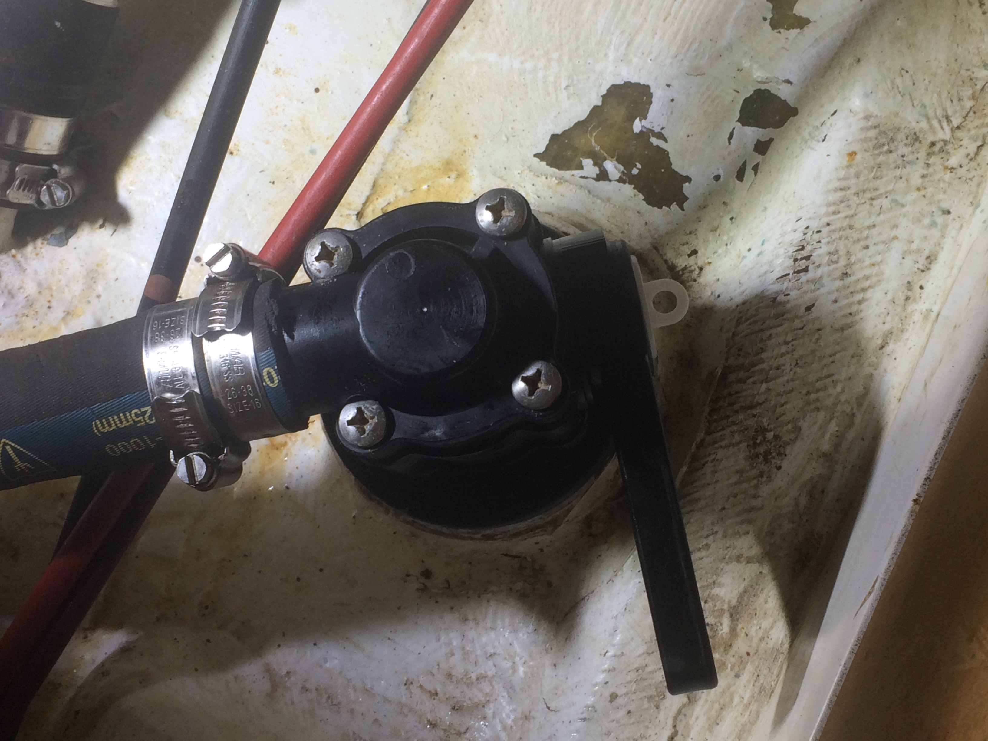

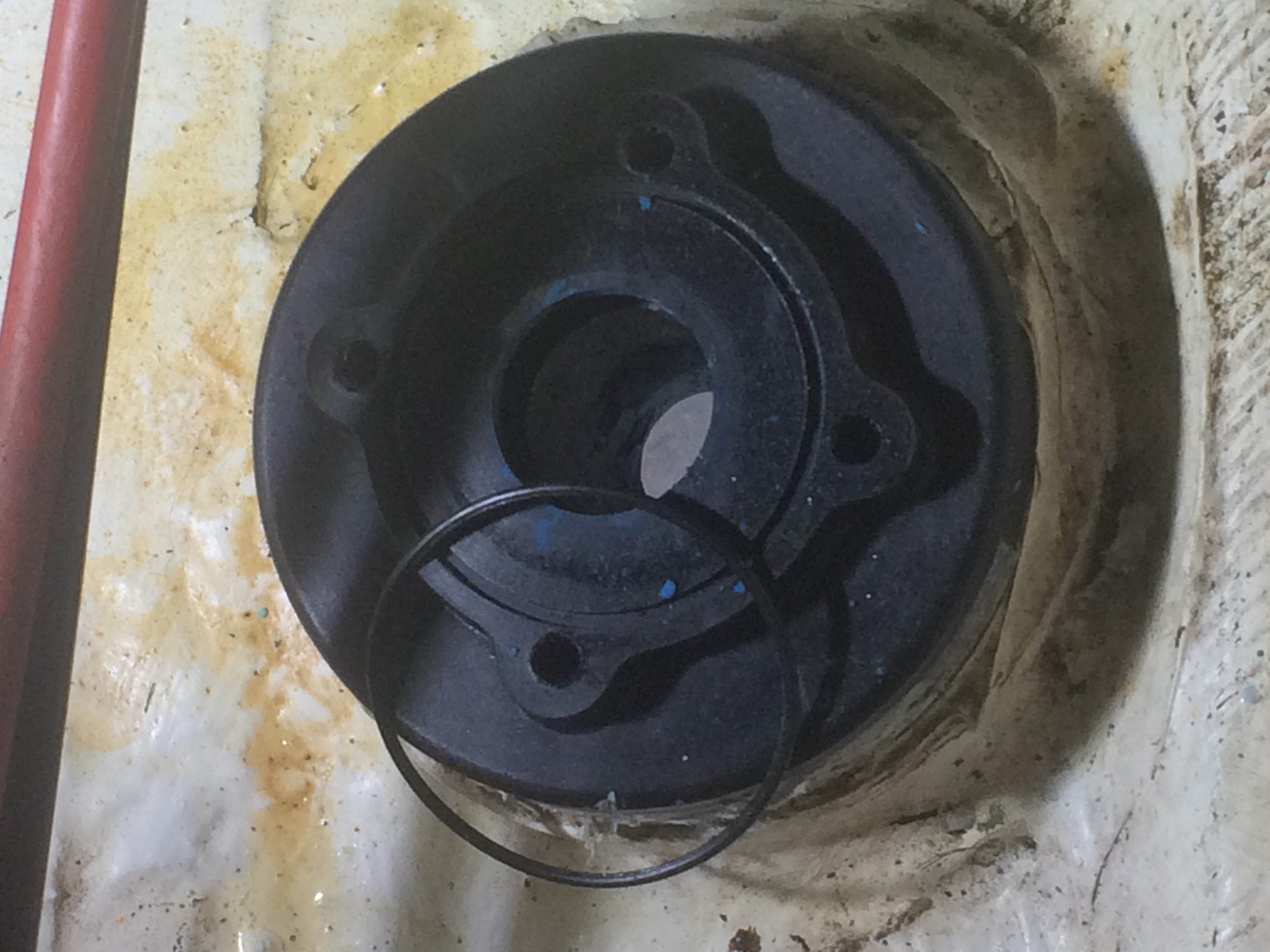

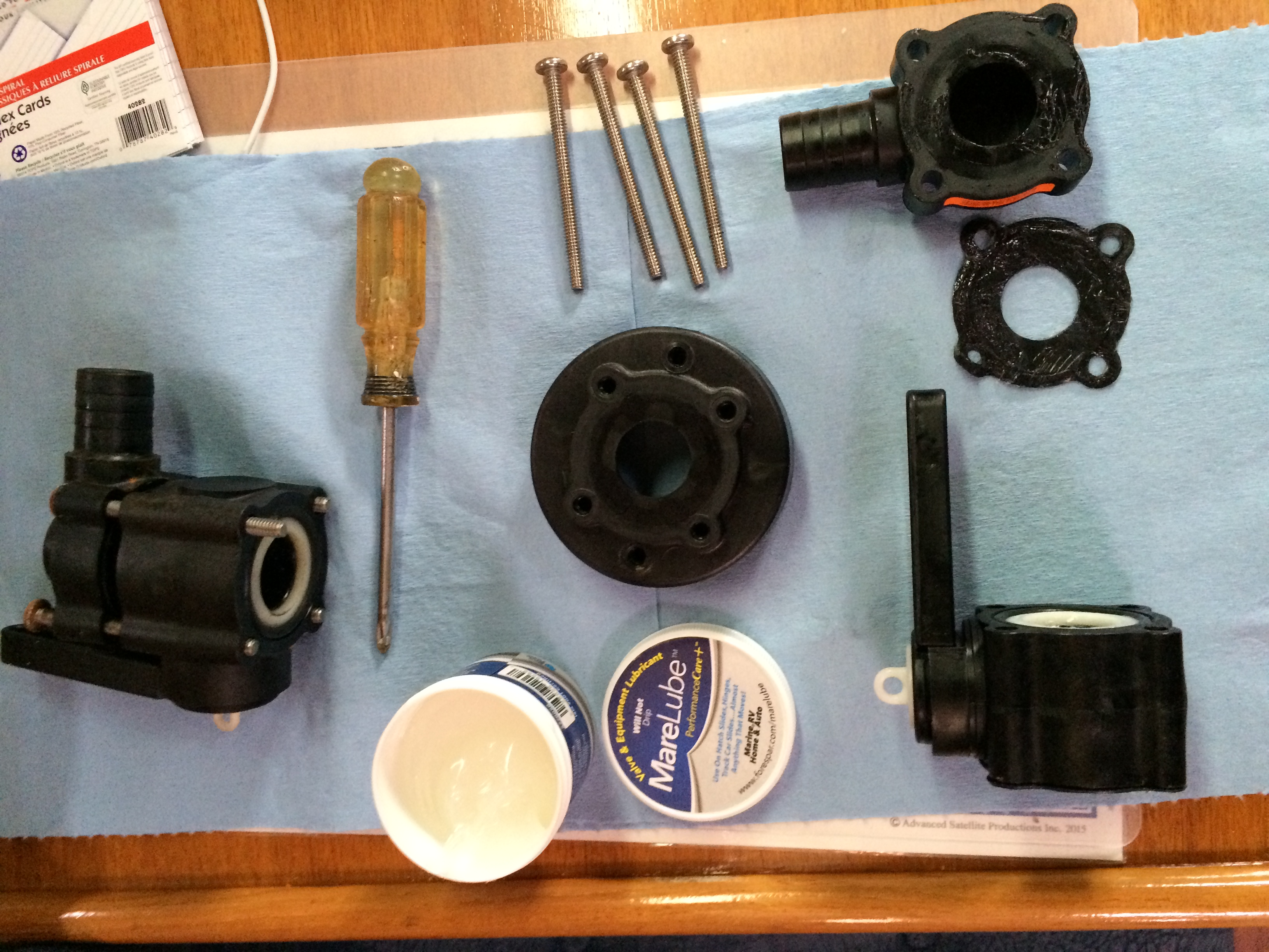

I just replaced the Forespar Marelon raw water seacock for the engine sinice our boat was hauled out for a bottom job and the handle was leaking a few drops each time I opened or closed. The seacock is probably the original on our 98MII and was getting hard to turn. Here is the link to the OEM Seacocks on the Forespar site: https://www.forespar.com/pdf/techTips/ball-valve-93-series-sail-boat.pdf  . The seacocks and the individual modular parts are available directly from Forespare, Some chandelry's carry the OEM Forespare Seacocks but probably not the individual modular parts. For instance you can buy just the center section that has the handle and ball valve directly from Forespare. I bought the entire seacock part # 931154 includes thru hull and base from Fisheries Supply here in Seattle. I only used the top three sections since I was not replacing the through hull and so also did not need the base.This link is the installation instructions for replacing the top sections of the seacock when using the old thru hull and base: https://www.deckhardware.com.au/assets/files/Forespar/Forespar%20Marelon...
my steps:
1. removed the 4 screws, I had to use a pair of pliers on the medium phillips head screw driver to break the screws lose but they all came out easy enough.
2. The instructions say you must lubricate the both sides of the two rubber gaskets and I used the Marelon synthetic grease pictured.
3. I cleaned the old base and removed the O-ring from the base as per instructions see pictures
4. I used the old screws since the new screws were shorter the the original, as per instructions
5.The instuctions say to hand tighten the screws only and to NOT OVERTIGHTEN.
And then I used the MareLube Reach tool which comes preloaded with grease to lubricate from above and below all of the other seacocks to make sure I do not have to do this again. The package says it contains enough grease to lube 20 seacocks

Thank you, Steve for taking time to photograph and post this critical and valuable post.
Can you describe, and if you can post a photo - where is the removable plug supposed to be inserted incase of a broken valve.
Does it go on the inside of the hull or is supposed to be inserted from the outside of the hull.

in the attached pictures you will see the white plug that is easy to locate in the handle of each seacock, Just pull out the little white ring. The plug is inserted through the outside of the hull, the circle or loop is for a string to be tied to so you can just pull out the plug without having to dive twice. One thing to note is that the exterior hole will have some bottom paint so you may need to scrape or clean out the through hull so you can insert the plug. Also if the thru hull is old it may have some barnicle or slim growth and the plug may not seat firmly so you could have some minor leakage when you are doing the repair or replacement in the water.

Hi again everyone,
So I did a little boat surgery this weekend, and wanted to update this post to what I see as the "latest" state of the Forespar Marelon seacocks. I was, on balance, pleasantly surprised and feel much better about these seacocks, and their overall seaworthiness.
But first, a little background. When I bought our 1994 Mk 1.5 C36 (hull 1307) just over a year ago, reading this thread and others really made me worry about the seacocks on my boat. I asked the surveyor (who was excellent, btw, for anyone in SF Bay/Sausalito area) about it, and he said that Marelon were actually really good, and in many cases better than bronze, because they didn't typically seize up. As everything else he told us about the boat has proven to be spot on so far, this one detail -- coupled with the horror stories I've read about these valves -- kept niggling me every time I used them, which for me is every time I leave the boat.
I kept on dreading the day when, needing to close up the boat and being in a rush to leave (I live 3 hours away), the handle would pop off in my hand, water would rush in, and I would either have to dive to put the plastic cap in the outside of the hull, or try to get to the haul out and have them pull the boat before my bilge pump failed.
I made a couple discoveries in my research process and during the replacement of one of these valves that eased my mind tremendously. I want to share these here.
First is a tool called the Seabung. It is a rubber stick with a thin, floppy silicone mushroom head on the end. When inserted into a thru hull from the top -- i.e. from the inside of the boat -- it collapses on itself so it can be stuffed through the tube to the outside of the hull. Once free of the confines of the thru hull tube, it regains its convex mushroom shape. You then pull on the rubber stick from above, and combined with the water pressure coming into the boat, that mushroom head gets sucked onto the bottom of your hull, and the flow into your bilge pretty much completely stops.
It's not cheap for what it is -- $50 on Amazon for a flimsy rubber umbrella on a stick -- but man, after using it and not having to worry about diving in SF Bay to put a plug in my hull from the outside of the boat, it was money happily spent. Plus, it's way cheaper than an emergency haul out.
Check out a video of it here: https://youtu.be/f-P49Y-o6Y8
Okay, so that was discovery one. Two of these now live on my boat and will be there for future (emergency) use if water starts coming in from the outside, along with the required toilet wax ring and foam and cork plugs.
Discovery number two is what I'll call at least the third modification Forespar has made on the handle assembly on these valves. The first iteration, which is what my circa 1993 valve had, was literally a short wood screw that went through the plastic handle and seated, via self-tapping, into the side of the plastic valve. It has the splines inside it, as Steve's pictures show above, that insert into the side of the valve and provide the real connection and ability to torque the handle.
It seems that after Forespar received complaints about this design (see Larry's attached narrative from 2015 above describing this), they modified it so that instead of that wood screw self tapping into the valve body, it would seat in an acorn nut, which would then be held in the middle of the female splines on the valve body side. As Larry's pic shows, that acorn nut easily pulled free of the valve body itself, and did not stay seated in place if it was pulled directly way from the valve body, and not side to side via the motion of opening and closing the ball valve.
That, to me, seems to be at least the second iteration of this design.
The third, based on the one I installed this past weekend, is a much better combination of the first two. Instead of the wood screw, and instead of the acorn nut, the seacock I ordered from Catalina Direct for my galley thru hull (Part #: Z4870, roughly $100 bucks) had a machine screw that goes through the handle into a metal sleeve that is seated inside the body of the valve itself. Since it's a machine screw going into its own sleeve, it bottoms out and won't strip like the original wood screw did. It also won't just pull out, as the acorn nut backing did. In essence, it is now a reasonably reliable mechanical connection that should be able to handle some lateral force that's not in the direction the handle turns without falling apart.
After following Steve's (and Forespar's) directions above, with the use of the Seabung to save me from diving, I was able to replace the galley thru hull without much drama at all, from the inside of the boat. And now that I know what I know, I'm not going to worry about that handle anymore, especially now that I have the Seabung on my boat. Should the handle snap, I can take the seacock apart fairly quickly, insert the Seabung and then either put a new handle on (I have a spare on order now) or put the original seacock, which is still functioning, back in place. But I don't think with this new design that I'll need to do either.
Now, instead, I will simply order a new seacock for my head sink drain (part #Z3747 on Catalina Direct, or cheaper on Amazon) and swap it out, using the Seabung to do so easily from the inside.
It is one of  the three seacocks that I open and close regularly on my boat, including the galley and the raw water intake of the engine. Since the previous owner replaced the engine raw water intake with bronze (perhaps indicating he went through the same thing years ago and maybe an argument to follow his lead, though my wallet and Marelon's anti-corrosion properties argue otherwise), there are really just two of these seacocks on my boat for me to no longer really worry about. The seacock on my holding tank macerator stays closed (we pump out regularly at our marina through the deck opening), as does the inlet and outlet on my head, since it was plumbed to use fresh water from the vberth water tank to avoid seawater organisms from smelling up the toilet, and empties into the holding tank.
Bottom line is, you can easily replace these seacocks yourself, at not an exorbitant cost, without the added expense of hauling your boat or the lost sleep of thinking you'll sink her in the slip doing the job. By the way, I did have a Plan B, with my rash guard, goggles and helmet to avoid hitting my head on the bottom of the boat at the ready so I could put the plug in from the outside, should the Seabung not work. I also made sure the Admiral was standing by in case I needed to leave the boat to get a part with the seacock removed. But none of that came to pass, I didn't need to go over the side and the Admiral was duly impressed with my boat fixing skills. :-)
Since this experience exorcised a lot of the demons I assume other owners share on this topic, I wanted to write it up here so others can stop worrying, too, by taking the following steps:
1. Get the Seabung (or something similar) for your boat.
2. Order replacement seacocks for the ones you use regularly from Catalina Direct or Amazon. The Series 93 OEMs are now widely available to consumers, a change from when this issue first came up in the late 90s/early 00s. You could argue for switching over to bronze and being done with it, but remember, the Forespar Marelons easily bolt right onto the existing plastic base that's already in your boat. It is an easy swap out.
3. Change out your old seacocks of this era (1993-2012 or longer?) or just replace them as they begin to fail with the signature weeping at the handle pivot point.
4. Relax and know you have one less thing (relatively) to worry about. I know I sure do. Thanks to everyone who has written on this topic before that helped me get to this point.
