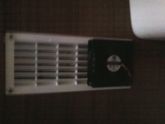

I noticed in the galley of my new Catalina 375 a hot spot on the counter top below the microwave. I determined right away that the heat was coming from the compressor unit in the front loading fridge below the counter. In the aft cabin I found a vent that supposedly allowed air to cool the fridge compressor.
A simple cheap solution. I purchased a computer 12V (.2 amp) cooling fan and attached it to the vent to suck air out of the fridge compartment. See attached picture. I tied the electrical connection into the engine compartment light for power. The fridge runs much better now and is more efficient. The small fan runs 24/7 unless you turn off the DC master switch to the engine compartment under the Nav station.
