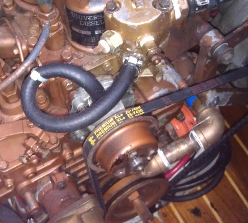

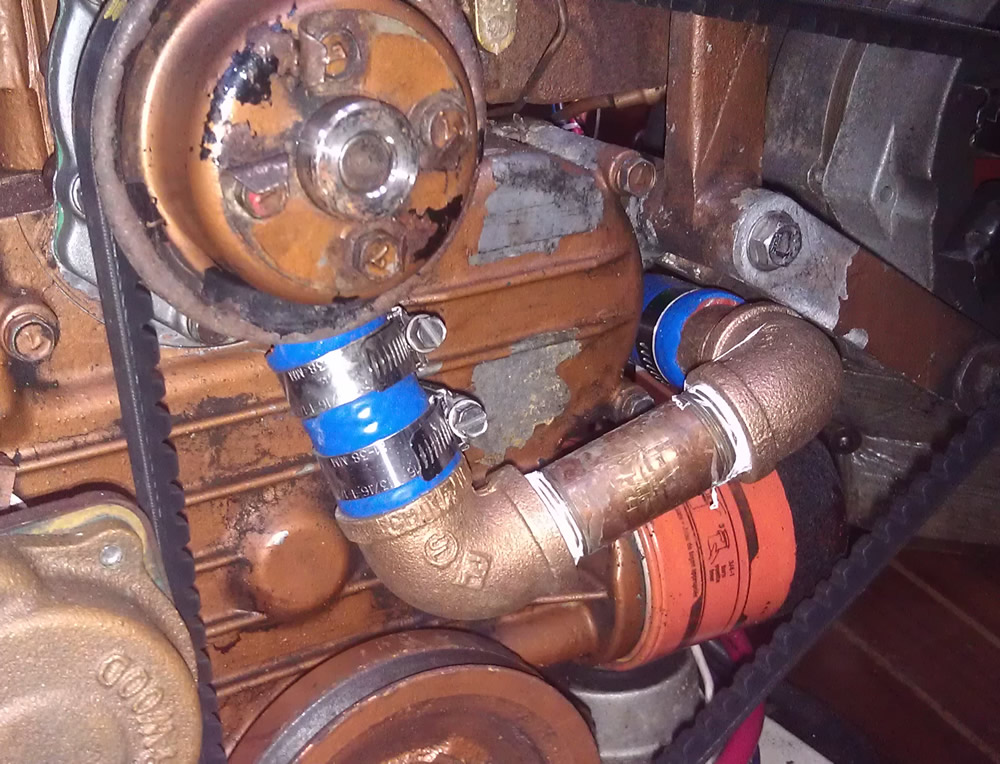

I just went through replacing the hoses. Use 3/8" fuel hose as suggested. It needs to be longer than 4 inches to create a loop with no kinks. For the hose from the water pump I used 2 brass 3/4" 90s and short nipples. This made the corner and then used flex hose back to the exchanger. Heading to the boat soon and if I remember I will take a pic or two.

Wavelength's picture
Wavelength
Joined: 9/28/11
Posts: 166
Attached are my solutions to the hoses. 3/8" fuel hose in a loop so no kinks. Bottom hose I used 2 90 degree brass elbows 3/4" and some short nipples. 2 of the nipples I turned down a bit in a lathe to fit the 1" hose. (silicone high performance... it was a giood price) . The brass could be replaced with SS but I had the brass fittings. This should avoid the wear on the hose as it sneeks arounf the alternator.
