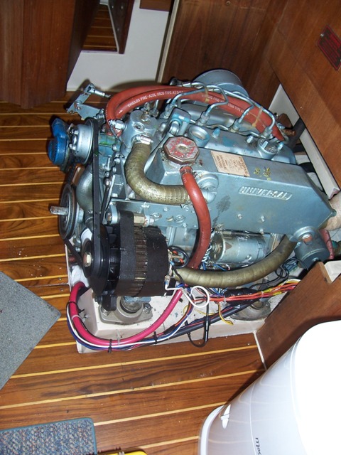

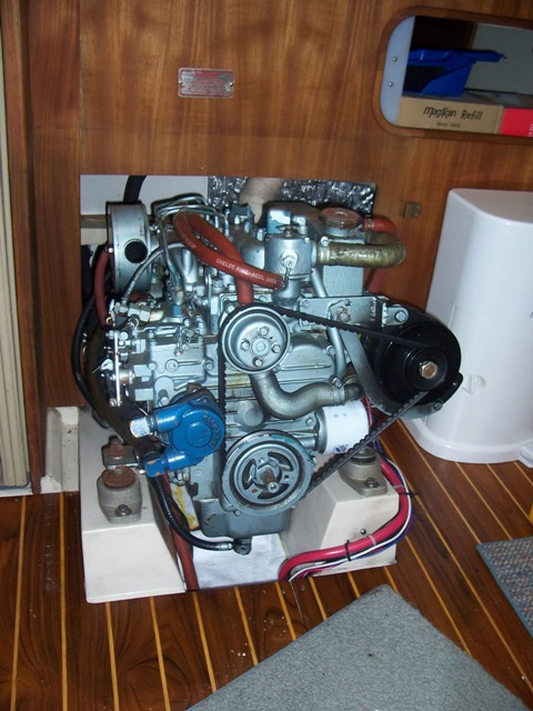

It definitely may not be easy depending on what mount there is trouble with. The back two would be more than likely the hardest of the four. In lieu of removing the motor it would appear the alternator would have to come off on the port side and perhaps the oil filter? The aft port side may require removing starter. Front starboard looks like the water pump and I will need to get close and personal to see if the starboard aft is doable. Looks like hoses for the SAft for sure. Again not being right at the boat and under the engine cover there could be difficulty in the process. A right angle drill might be the problem solver. Attached are some pictures of my engine in it's space.
