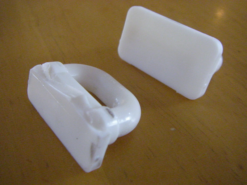

The plastic "cars" that attaches the main sail to the mast track keep breaking.
Today, beam reach 15kt wind and three broke.
Happened before, broke two at once.
When I look for a better replacement, all I find are the same plastic slides.
Is there a better alternative slide, or am I just overpowering my main sail?

Rick,when this happened to me i started changing them one by one...after the 3rd one i removed the sail and had new plastic ones put,changed them all at once.Its been 4 yrs now and no breaks...the white plastic ages and after several yrs they become brittle.I bet your main is original..

So, today I went down to the boat to fix the broken sail slugs.
There were [B][U]SEVEN[/U][/B] broken slugs.
Luckily I had that many extras already on the boat, so I sewed away my morning. Got all seven replaced in two hours. LOTs of sewing the nylon strapping tapes together.

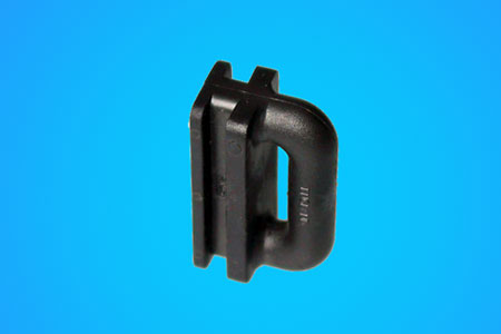

The only time I've ever broken slugs, is while reefing. Since then, I've marked the halyard so that the main only descends to where the slugs are able to stack above bolt that keeps them from falling out of the track slot. No more broken slugs. Personally, I would not want to use a metal slug, as I'd prefer to have the slug fail before tearing the sail.

I think this is definitely age related. The sun does a number on plastics. I have used metal slugs and they can bind at times. Once I replaced them all with the new plastic D shape slugs things were smooth form there on out.

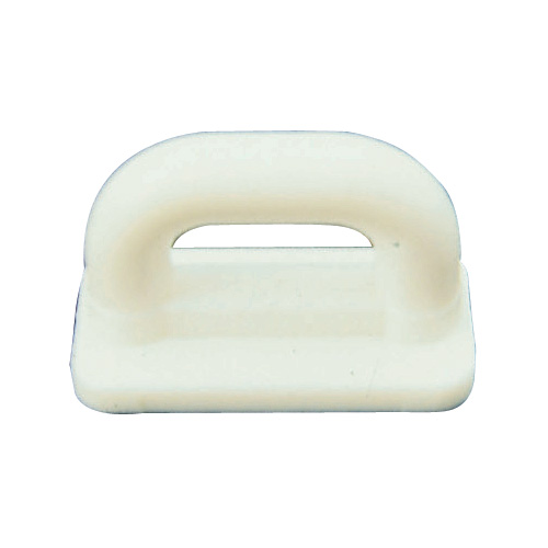

From [url]www.catalinadirect.com:[/url]
Sail Slide 3/4" Heavy Duty
Product #: Z1745
Price: $5.75
Sail Slide Flat 1-3/4" high X 3/4" wide for the Catalina 34 and Catalina 36. This heavy duty slide is used by many sailors near the top of the main where the load is high. Those who want to eliminate breakage problems that can occur with the standard white plastic slides will replace all of their slides with this heavy duty slide
Self lubricating
Very low friction
Manufactured from molybdenum disulfide
1-3/4" height reduces the possibility of jamming
These sound very cool...

I think the slides breaking is a combo of UV breakdown and the stresses from reefing (I broke the 2nd slug up 3 weeks ago after reefing in about 18kts.)
