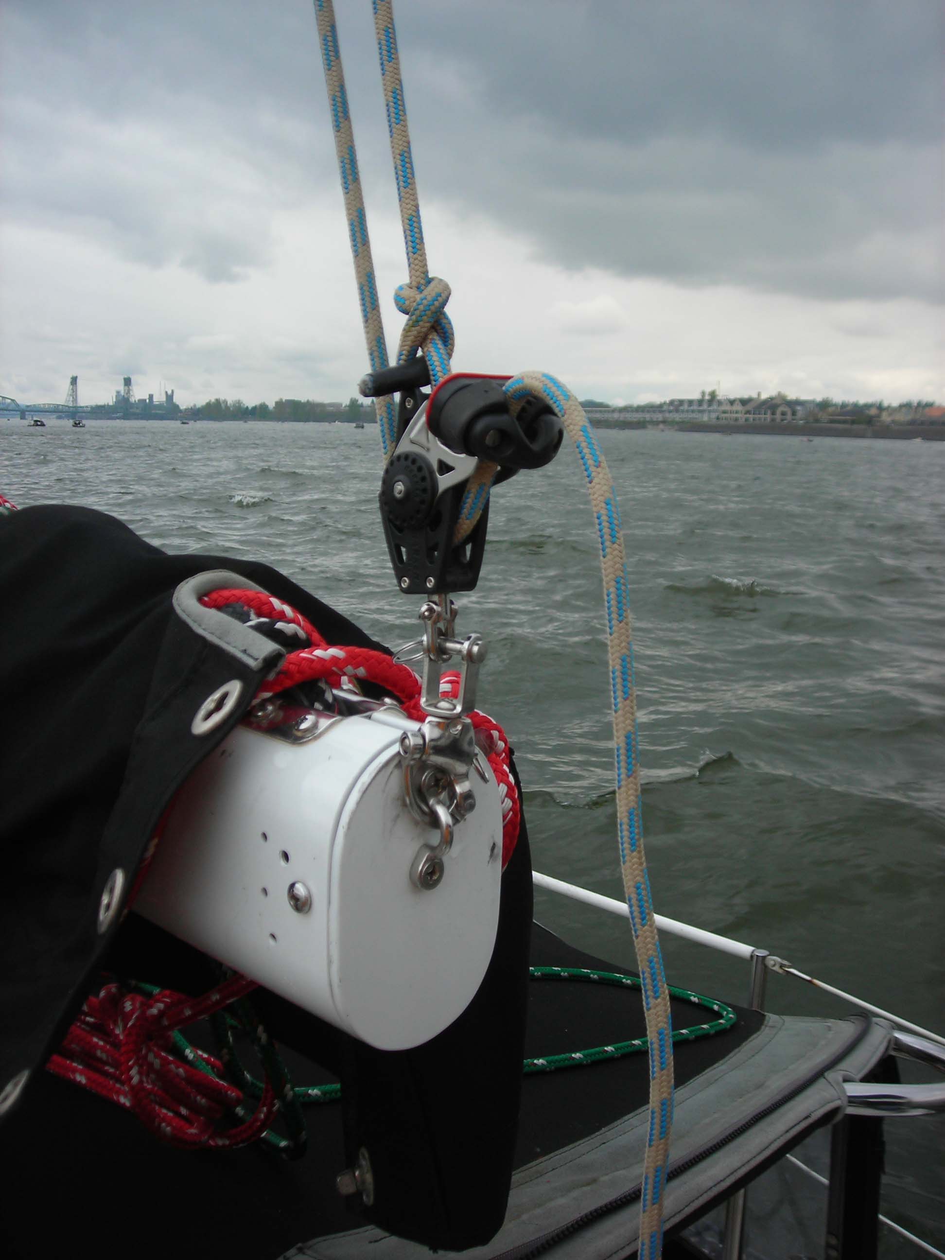

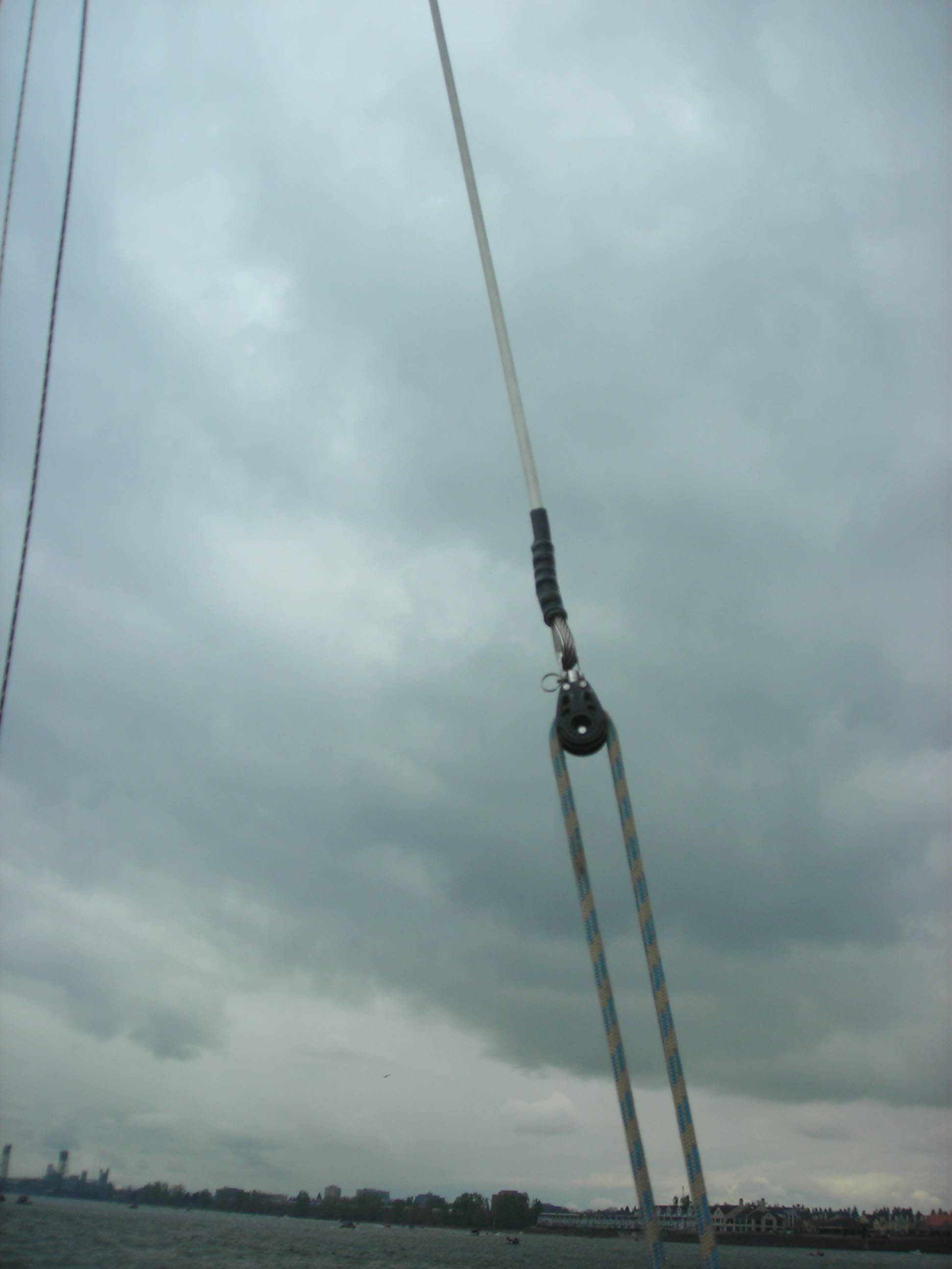

A buddy of mine who owns an S&S Catalina 38 did a super mod on his boom topping lift. He got tired of using the lift directly, and rigged a small block to the near end. Thus he now leaves the topping lift always adjusted at one position, and only tautens and slackens the block at the end of the boom when he wants to use the Dutchman system. I am going to make this mod when I get a free moment, but I share the photos attached.
