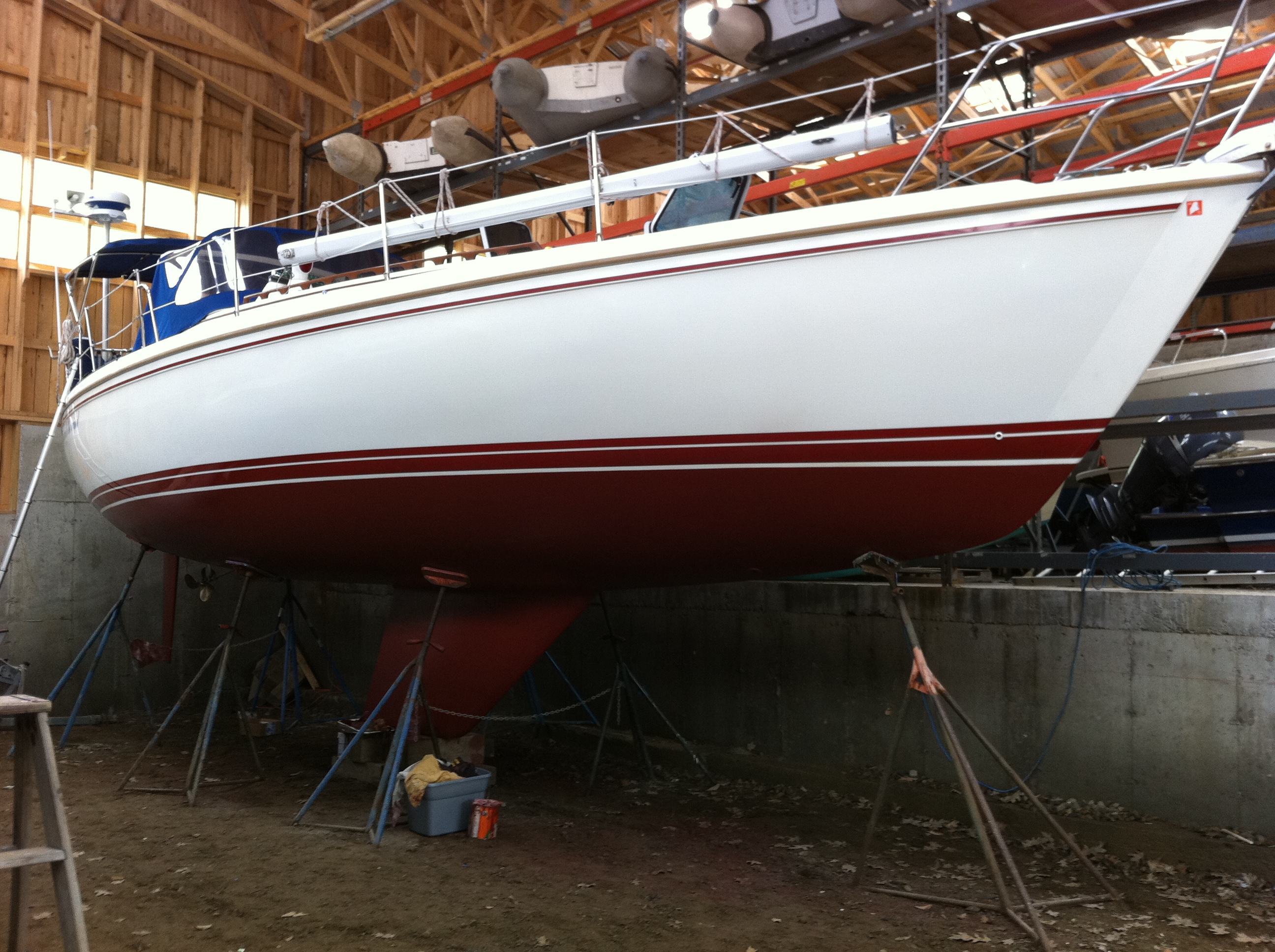

I think for the most part all waterlines (Boot stripe) are molded in gel coat  and it was the same with Catalina 30. I use rubbing compound on the boot stripe annually and then wax, It has scars that show when close by, but looks great for a boat 24 years old. If really bad you can actually sand with wet sandpaper (very very fine) than use rubbing compound.
Image icon Bittersweet Barn storage 002.jpg1.64 MB
