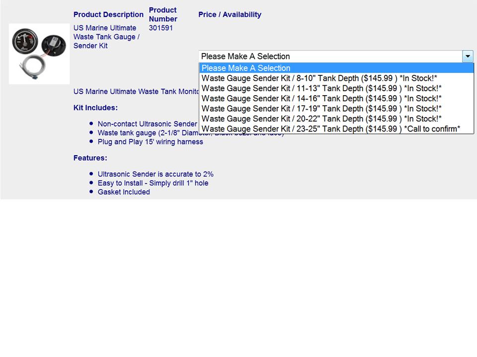

What was the measured depth (height) of the holding tank ?
(for length of sender unit, see image below)

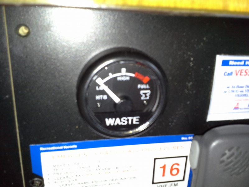

OK, the level sensor package arrived.
It took 2 hours to do a good quality install, snaking wires and doing a nice job.
I installed the gauge on the VHF radio black box face, inside the cabinet.
Now I can see when my holding tank is empty or full. The ultrasound sensor works great.
The gauge worked perfectly the first time.
A true joy! Mastery of my septic system.

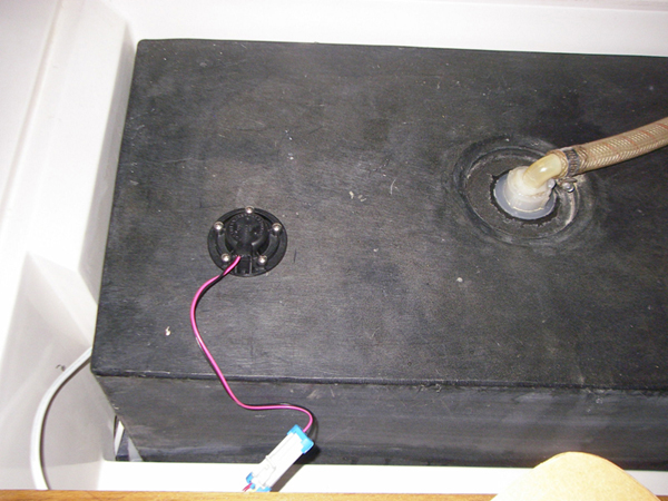

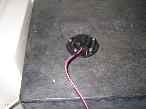

Rick, any photos of the sensor installation?
Hi Larry,
Here ara two photos of the sensor.
Installation was a simple 1" hole drilled in the top of the black tank.
Once I penetrated, I quickly covered the hole with tape for odor control.
The ultrasonic sensor sender unit is just a flat disc, similar to what a M.D. would use for an ultrasound. It just pings a signal out and measures the return. This is ideal with no moving parts to get clogged with paper and *%@$.
Again, overall a very satisifying upgrade. At only $154 from defender, it was the one of the cheaper options, and works great.

Rick, you haven't stated for the record what brand and model sensor package you installed.
Also, did you find the system you installed easy to calibrate? I think that the V-shape of the tank might make a simple level reading misleading...when the level indicated is at, say, 50%, the tank is only perhaps 25% full, etc. I think what I would do is pump out the tank, then gallon by gallon fill the tank (via the vent access port) with water and ensure the gauge is accurate - or - make a calibration chart that relates actual gallonage fill volume with gauge reading.
Ah, yes. The whole unit was purchased from Defender (see image).
It is a US Marine Ultimate Waste Tank Gauge/Sender Unit #301951 for a 11-13" tank height. $145.99 and well worth it.
Regarding the strict accuracy, well, not so much. Primarily because the gauge dial sweep is short, not finely graduated, and not calibrated. But also because of the various reasons that Larry mentions (tank shape, etc.)
