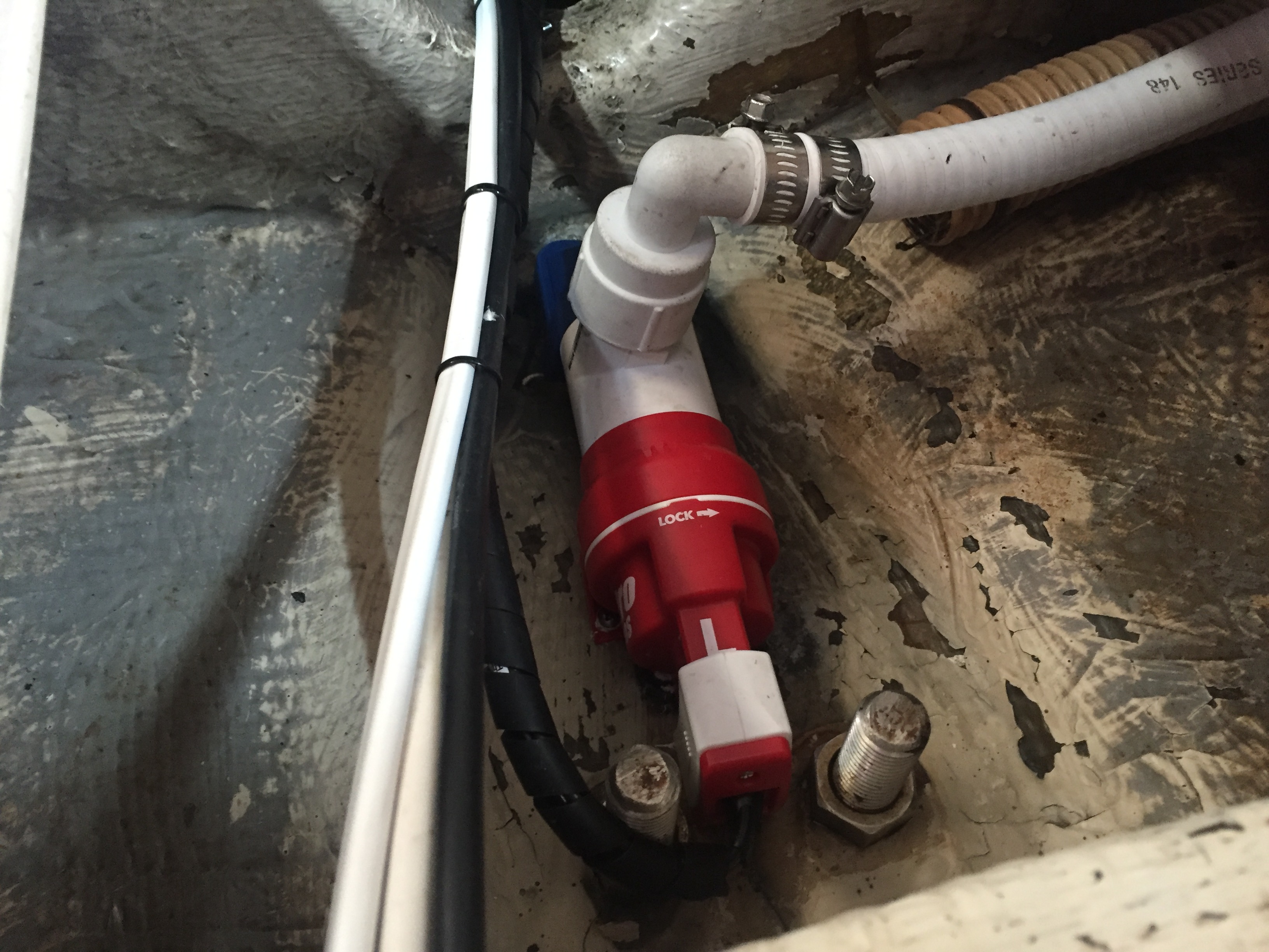

Posts: 65
Installed the Rule LP900S bilge pump with auto switch and replaced the ribbed hose to a smooth bore last fall.  The pump has two settings.  One that checks for the presence of water every 2.5 minutes as mentioned above, or one that turns the pump on at 1.3" or 2".  Mine is set at 1.3" so it does not experence the battery draining autocycles.
 Any known reliability issues with the LP900S?
