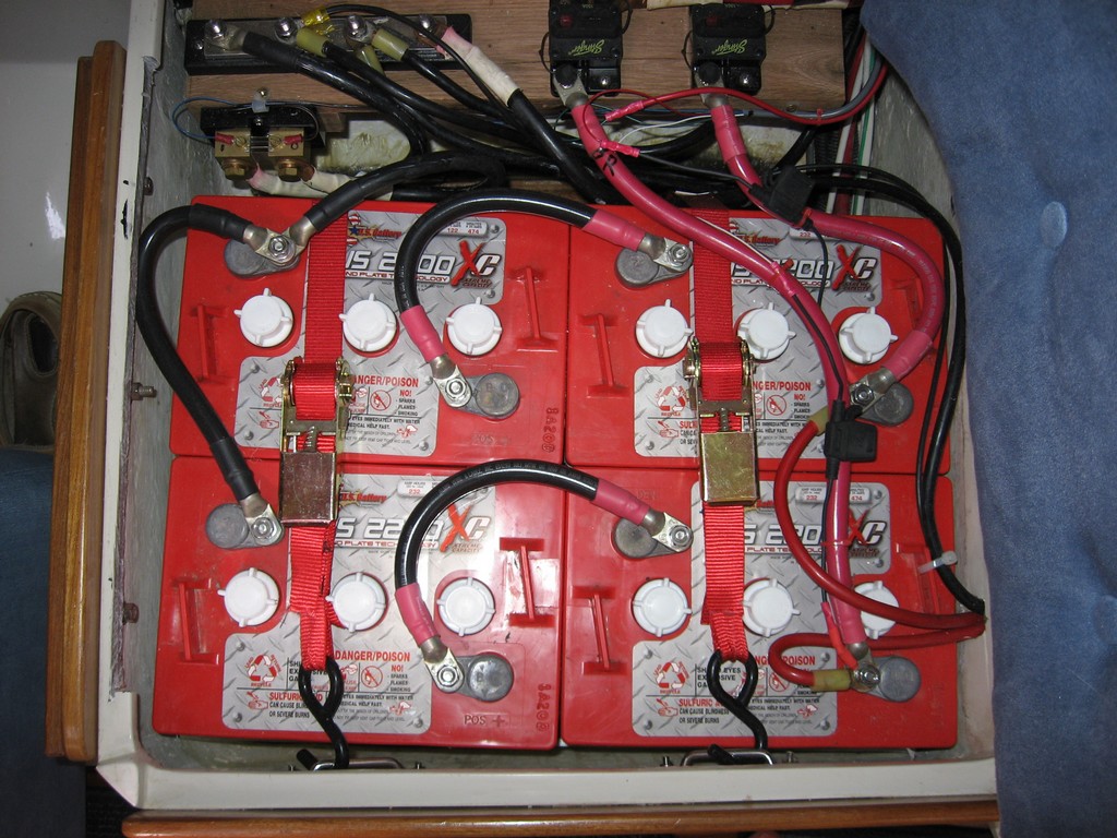

[quote=HowLin;21427]I'm curious about which 6V battery brands have the lowest profiles... as I would like to install in the same compartment as my 4D's are without modifications if at all possible. Most everyone seems to have had to modify the battery compartment..[/quote]
See attached picture. These are US Battery XC2200, 464 AH, they fit right into the Mk II aft seat where the 4Ds used to sit. No height issues. I made a 1/4" plywood box for them and glassed it all in case of a spill. On the left side of the picture you can see a small cut out of the seat lip, that was only required so I could get the box in there. If I hadn't used a box there would have been no modifications at all.
