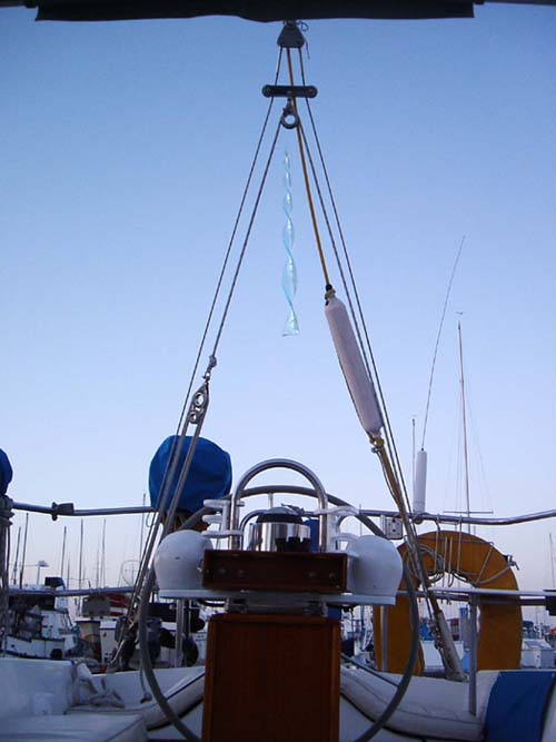

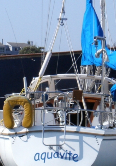

Our C34 technical editor wrote a backstay analysis article a few years ago, published in [I]Mainsheet[/I], I'll see if I can find it. But it really isn't rocket science, and Tom's right, any rigger will help you out. If you have a split, consider raising the height of the split if it hits your head while you're at it. Here's what we did, with a Garhauer split sheave and a Garhauer vang with simple StaySet for the line. The drawing has a different way of dealing with the split than we installed. There are many ways to do it. We installed oversized D rings at the transom chainplates to handle the vang on starboard and the line to port. Hydraulics on our boats, I believe, is overkill & unnecessary.
