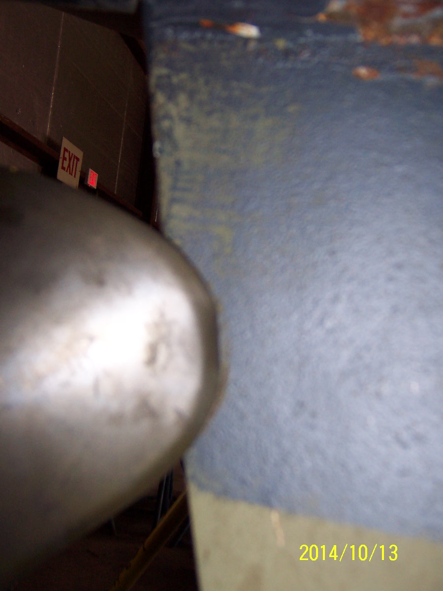

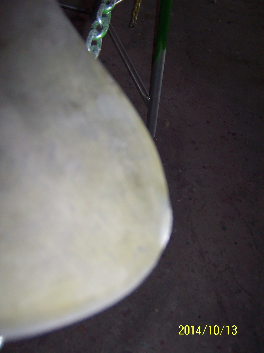

Attached are a pic of the blade tip and the interference.  Not sure if that amount of bend could be causing my "rumble" sound or not, and I recall that I noticed the rumble right away after installing whenever I went above 1950 doing a quick stop in reverse, etc

That does seem like a very small nick on the blade.  Not sure it would cause the rumble you mentioned. But, because the alloy they use for the autoprop (VERY hard!) has so little give, you might have done something to the bearings or bearing races inside. I know it's a royal pain shipping stuff to AB Marine, and then they ship it to the UK, but it might be the best course of action.  Another couple of possibilities I just thought of.  Have you checked your cutless bearing lately?  Any play in that could cause a rumble.  Do you have a SS (Aquamet) or bronze shaft?  I found that the bronze OEM shaft was too soft for heavy props like the autoprop. If a bronze shaft gets even the tiniest bit out of true, the heavy prop at the end of it can cause "shaft whip" or some such term.  Have you checked engine alignment?  Even though I bought a used autoprop for my C36, once the engine was aligned, cutless bearing replaced, notch cut in the prop strut, and a SS shaft installed, it was smooth through the entire RPM range.  Not sure if this helps or not, but it might give you some more things to check.  BTW, I would think that all props would cause a rumble when doing an emergency stop.  You have tons of cavitation down there, and you're not running through smooth water.  Just a thought.

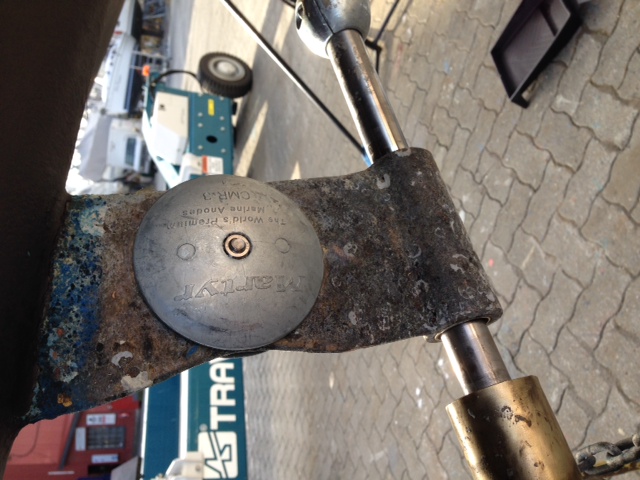

Ken, I also have a Autoprop H5 and have a similar vibration around 2000 RPM. In my case, it usually subsides a bit after a few minutes and tends to be less of a concern.  I hauled out this spring and replaced the cutlass bearing as it was badly worn.  I also aligned the engine and cleaned the prop, installed new zincs etc. I had a mechanic examine it during a sea trial and the 2000 + RPM vibration was still there.  His thought was that it was simply cavitation and not much to do about it. A further bit of information in my case was I ran the engine at well over 2000 during a run through a pass with strong currents and there was no vibration at 2000 or higher.  Perhaps the fast flowing current prevented the bubbles and thus supports his theory of cavitation?
I bought the boat with the autoprop installed and someone has indeed carved a groove out of the strut (attached).  They also installed a spacer at the flange-transmission connection which pushes the prop further out and away from the strut as you can see in the photo. Apart from the vibration which does subside, I like the autoprop.  It provides good propulsion and backing up the boat is quite easy.

Additional clarifications --
- Cutlass bearing appears to be rock solid.  Kind find no play.
- Have stainless steel shaft.  Bought boat used, so either PO changed it, or 2004 models came that way.
- Checked shaft alignment myself in 2009 when I got the boat and it mesured in spec., but will check again next spring after mast is in and tuned, and boat is in water.  Normally I store outside without mast removal as I have good winter cover.
Talked to Geoff at AB Marine. He thinks my rumble is cavitation and after reading your comments, I am thinking that is what I am hearing.  I only get it when I try to stop (probably too fast) in reverse, or when I try to push the boat up around max hull speed.
I am sending AB Marine the blade pic and will go from there on what to do with the bent tip.  Other than that, I will grind out 5/8 inch clearance in cutlass support, check shaft alignment after commissioning, and probably assume my rumble is cavitation.

Just wanted to add that I think the bent tips will definitely cause the rumbling you mention, but the guys at AB should be able to sort it out.  If you can I would also follow Tom's advice and send the prop in for servicing.  I have no issues at any rpm up to 2800 and I never go much above 2300 as I reach hull speed at 2150 to 2200 usually...  Bronze shaft, but no problems noted.
