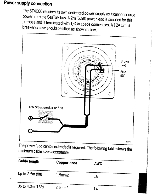

Trouble shooting problems like this online is difficult at best. I'm seeing some good ideas from others. I am also assuming this is a ST4000 and not a 4000 Plus. Let me give you a way of determining if you have a problem with the DC positive or negative (or both) feed to the control head.
First make sure the connectors attached to the feed wires are crimped correctly and that they are firmly slid over the spade connector on the control head and not wedged between the connector and the plastic insulating boot. See attached file.
You will need a very long set of test leads and a DVM. A set that can reach from your battery to the back of the ST4000 controller. First, with the long leads attached to the DVM, measure the voltage between the battery positive and battery negative terminals. Write that voltage down.
Now attach the negative test lead wire from the DVM to the negative battery terminal. With your autopilot switch on, measure the voltage at the positive feed connector on the back of the control head with the positive test lead probe. Write that voltage down. If the difference in voltage readings are off by as little as a few tenths of a volt, then you need to trace your positive wiring from the battery to the ST4000. Look for loose connections, poorly crimped connector, undersized wire or other obviously bad wiring issues.
Now attach a positive test lead wire from the DVM to the positive terminal of the battery. Measure the voltage at the negative connector on the back of the control head with the negative test lead probe. Write it down.  If the difference in readings are off by as little as a few tenths of a volt, then you need to trace your negative wiring from the battery to the ST4000. Look for loose connections, poorly crimped connector, undersized wire or other obviously bad wiring issues.
Someone suggested a fox and hound troubleshooting tool. Great way to trace wires and see where they go. Now it becomes a detective novel in finding the missing electrons. Often these problems show themselves when the auto pilot is on and running because current draw can make the problem more noticeable.
