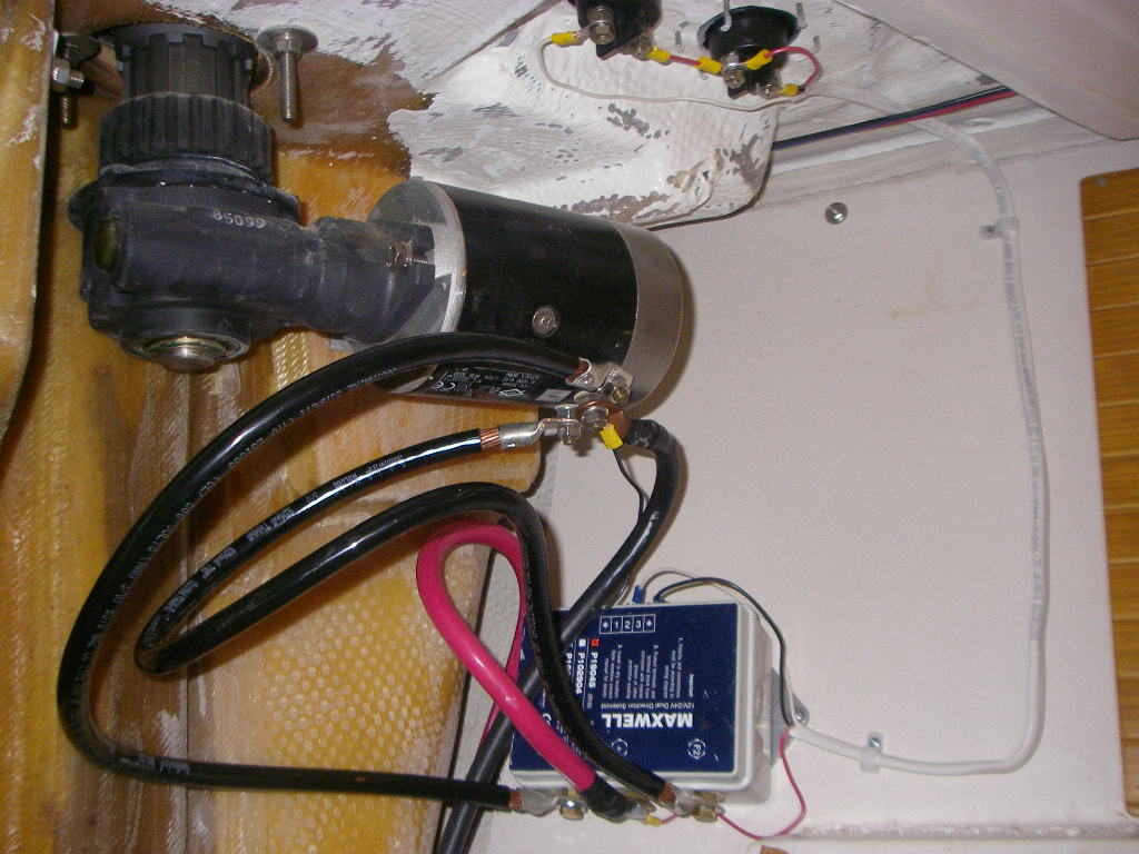

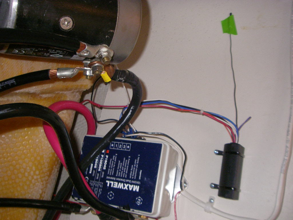

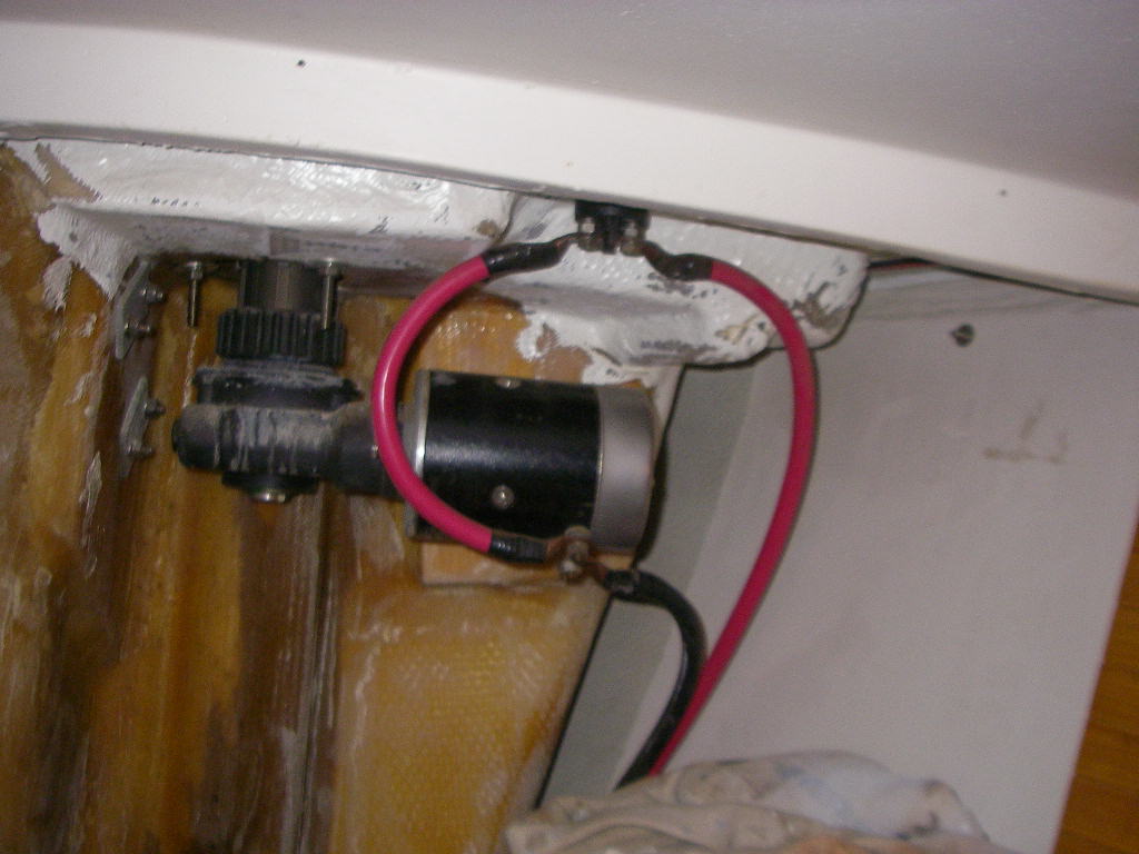

I have a remote control for the windlass, and I love it!
Originally the boat had only the stock "up" foot switch at the bow.
I installed a second foot switch for "down", and also installed the solenoid unit needed to switch back and forth.
Then, I installed the wireless controller to control the solenoid.
Now, as I approach the anchorage, while at the helm, I can release and drop/set the anchor single handing.
When ready to depart, again the remote windlass makes it easy to "up anchor" and pull away.
Here are some photos of all that:
Captions:
1) Starting point, single switch
2) Second switch and solenoid installed
3) Detail of solenoid/receiver wiring
4) Solenoid unit
5) Remote control fob for windlass control

Rick, that looks great but where did you buy the parts please?
Sam

Rick, How and where does the receiver for the remote install?

I bought all my Maxwell stuff from Defender. Great prices, good service.
Here is additional detail on the remote/receiver (second photo).
The receiver with it's antenna (green tape) sits right next to the solenoid.
Hey, if I could drill the deck, mount a footswitch, then wire the solenoid with big cables and hook up a wireless, anybody could do it!

Great pictures Rick. Very useful for me since I am doing a new install of a Maxwell windlass.
